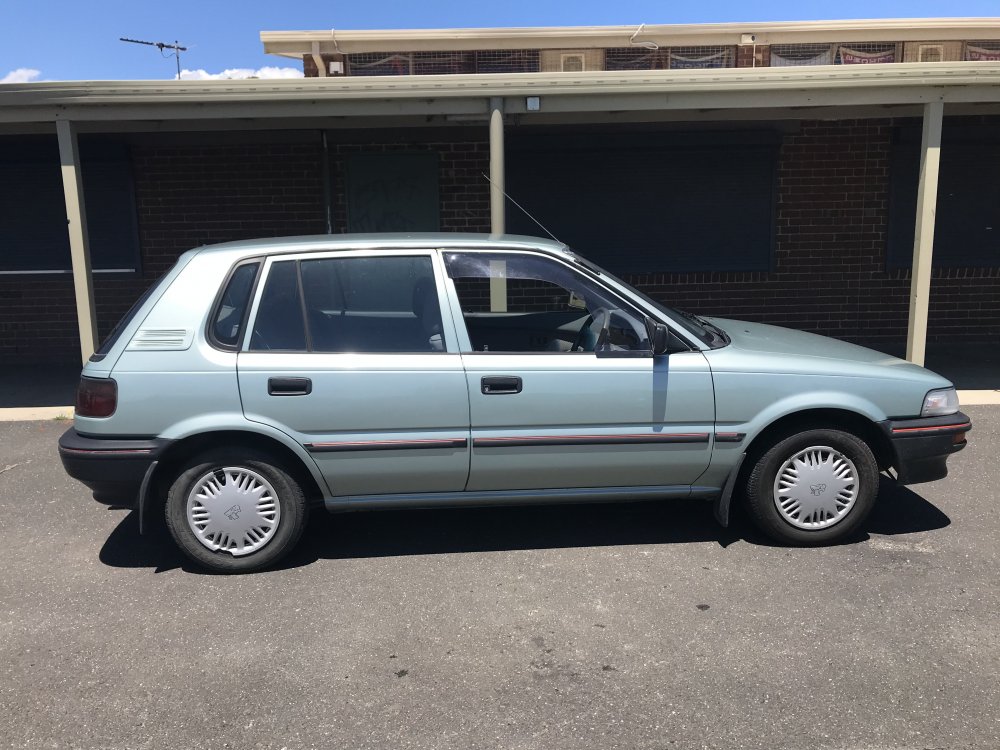

Thank you. I have a 1991 Holden nova it’s like brand new inside and out the body is amazing for a 28 year old car, just very slow I really wanted to keep the motor original with numbers and stuff but have more horse power

That is incredibly clean!

And straight away, what do I find on the Facebook page. I reckon you would get it cheaper than that, but looks to good to use as a donor.  Not what you want to do perhaps, but that’s the reality of a 4 afc. And in the long run it will always be worth more than your Nova I’m afraid, as tidy and cared for as it clearly is.
Think hard before you go spending much on yours, as $3000 won’t go far unfortunately

The spare is brand new, all I did was service it and since the picture I have put 2  hubcaps on it as they where ratty. Now I just need to do the fuel pump as it’s leaking, I paid $100 for it.
