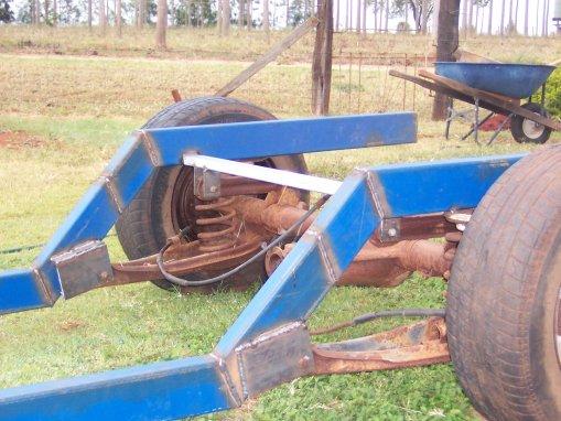

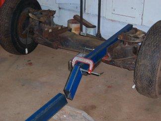

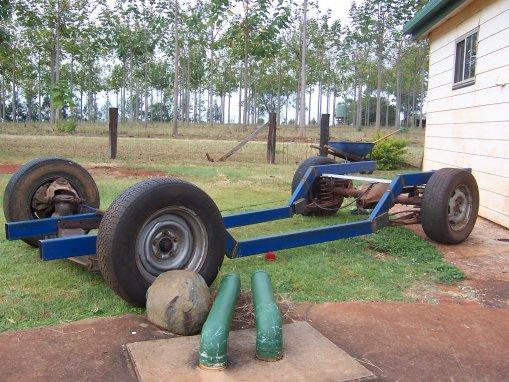

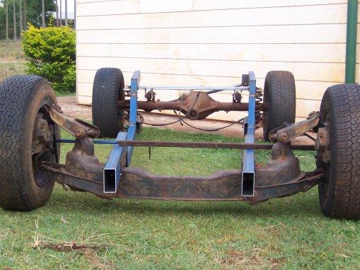

Picture 1:
Chassis Build Up Process.......
The first design wasnt low enough, so it was Z'd / Stepped further to make a grand total a 45cm step down in the rear and a 35cm step in the front.
The front was also cut down into the cross member to make it level.
As you can see in these last pictures, its extremely low, and thats without lowered springs.
With lowered springs in the rear, it sits on the bump stops and has about 40mm of ground clearance....
CHECK IT OUT!.......... :D
All final welding of the Chassis is yet to be completed...
