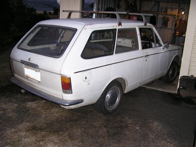

The 16 is deregistered and needs a lot of work as the body is pretty rough on it. Be another year or two before I worry about it to much.

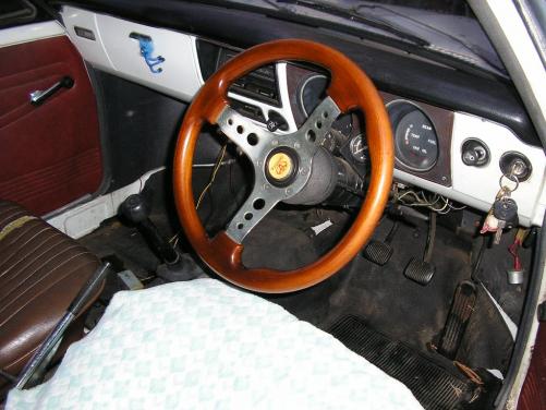

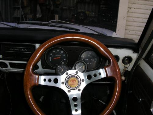

Inside: Aftermarket woodrim steering wheel. Vacuum guage and small oldschool tacho mounted on steering column. AFR guage for carb tuning (O2 sensor in exhaust). Early ke10 front seats (had ke20 ones in it when I got it). overrated dashpad.

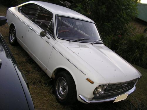

She's nothing flash to look at, fattened stock would be the best way to describe it. Needs some body work and a respray. The 9-10 year old little beaver paint job is looking pretty sad. Interior needs some work, seats need retrim. Intend to give her some lovin once we move soon and settle into a new house.
