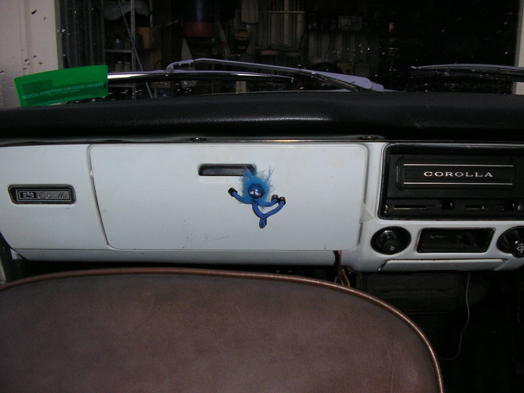

Cleaned all the windows of the ke15 on the inside this evening with vinegar and water. It was fricken filthy. I can actually see out now. When I test drove it the other night I could hardly see a thing.

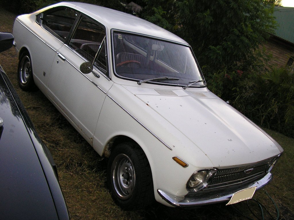

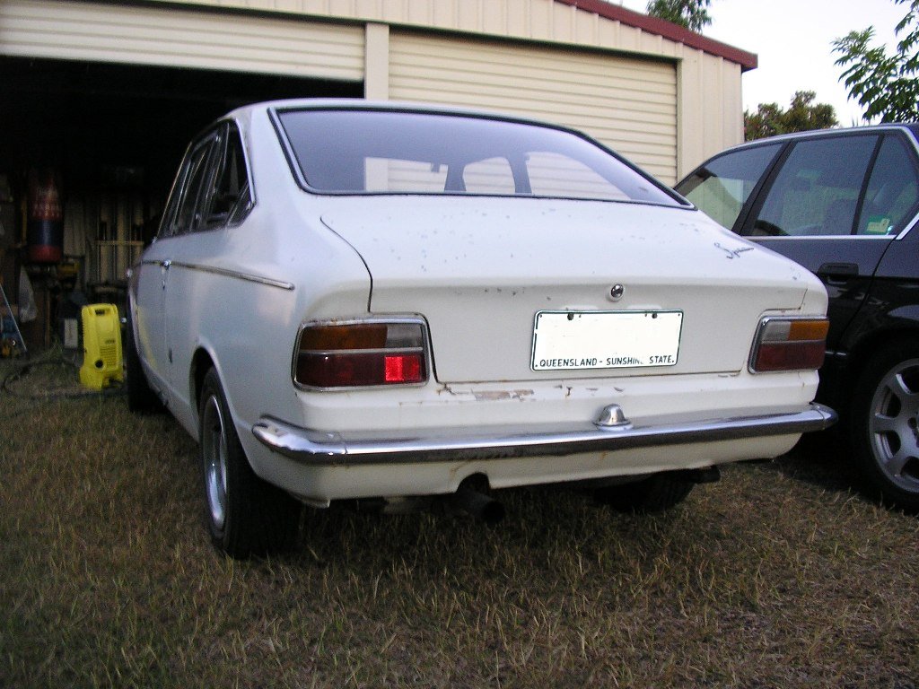

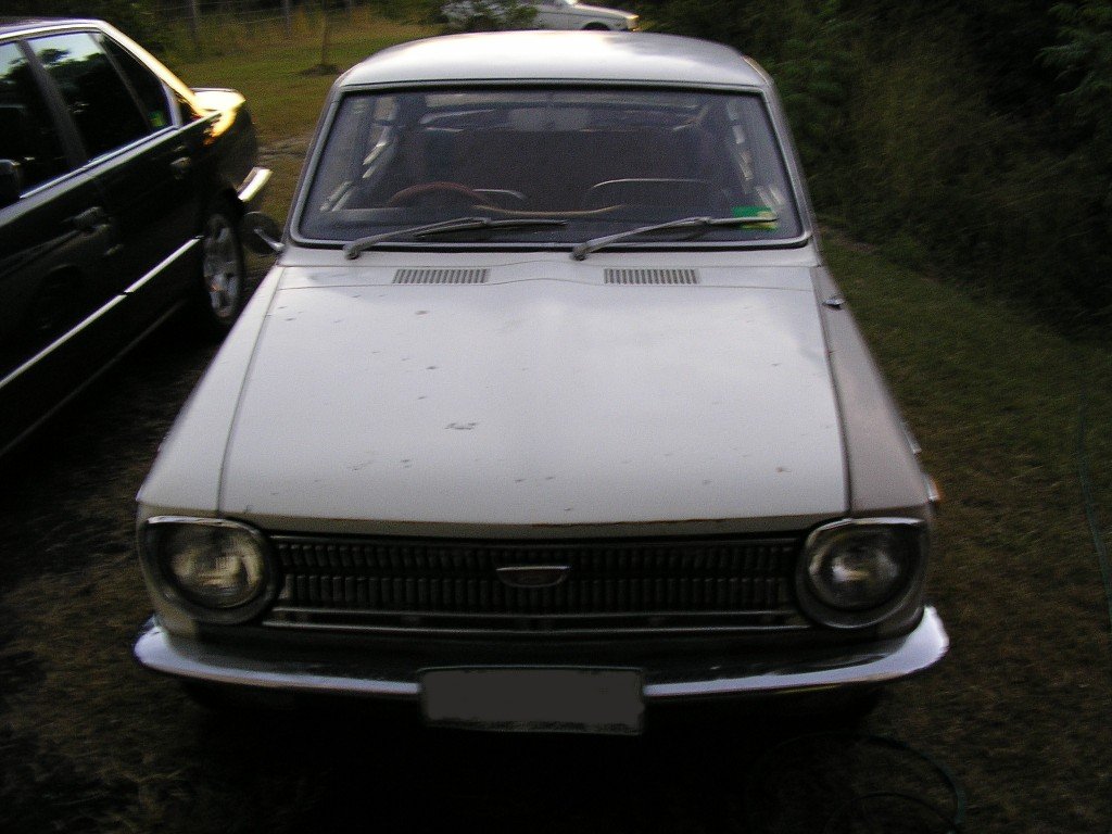

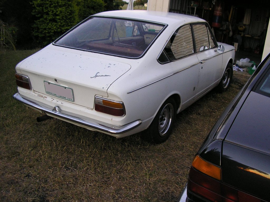

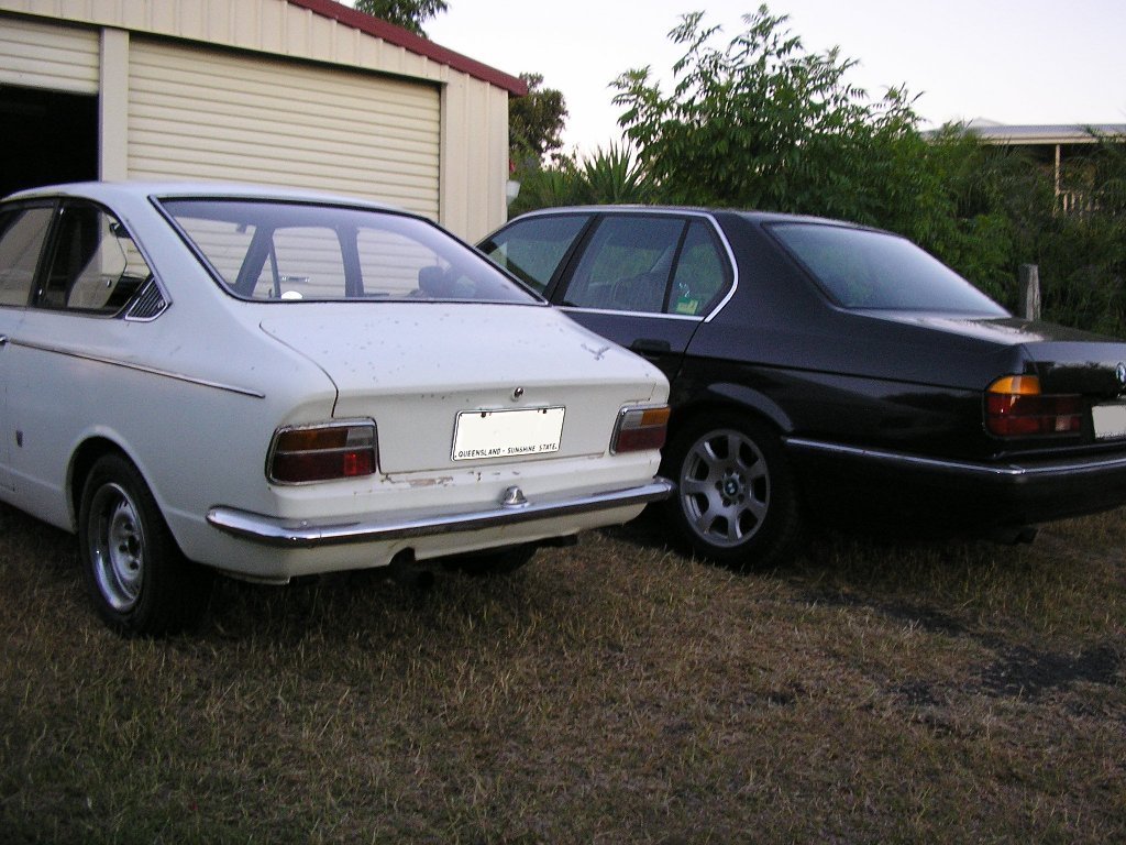

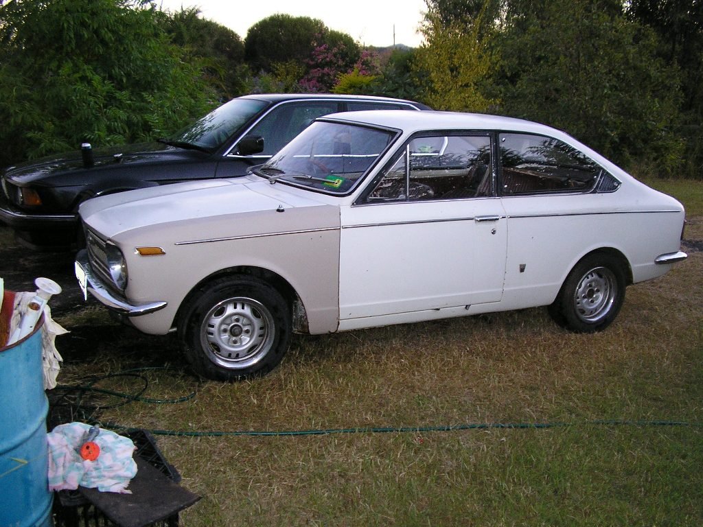

Took some pics as the sun was going down. Mind the bits of paint missing from birdshit as it lived under a tree for a bit... She needs a respray.

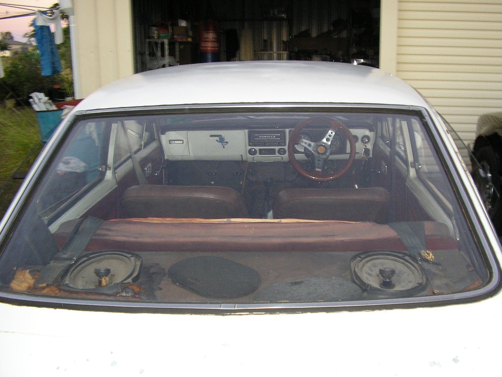

Made up a new rear parcel shelf with the help of the missus for the ke15 this afternoon to replace the old one that was rooted. Fitted a set of new Alpine Type S 85wrms sikbenines that aren't wired up yet. Have a set of MB Quart 6" splits to fit up front later once I reco the underdash shelf I have. Don't think I'll worry about a head unit, just going to wire my Ipod direct to the amp.

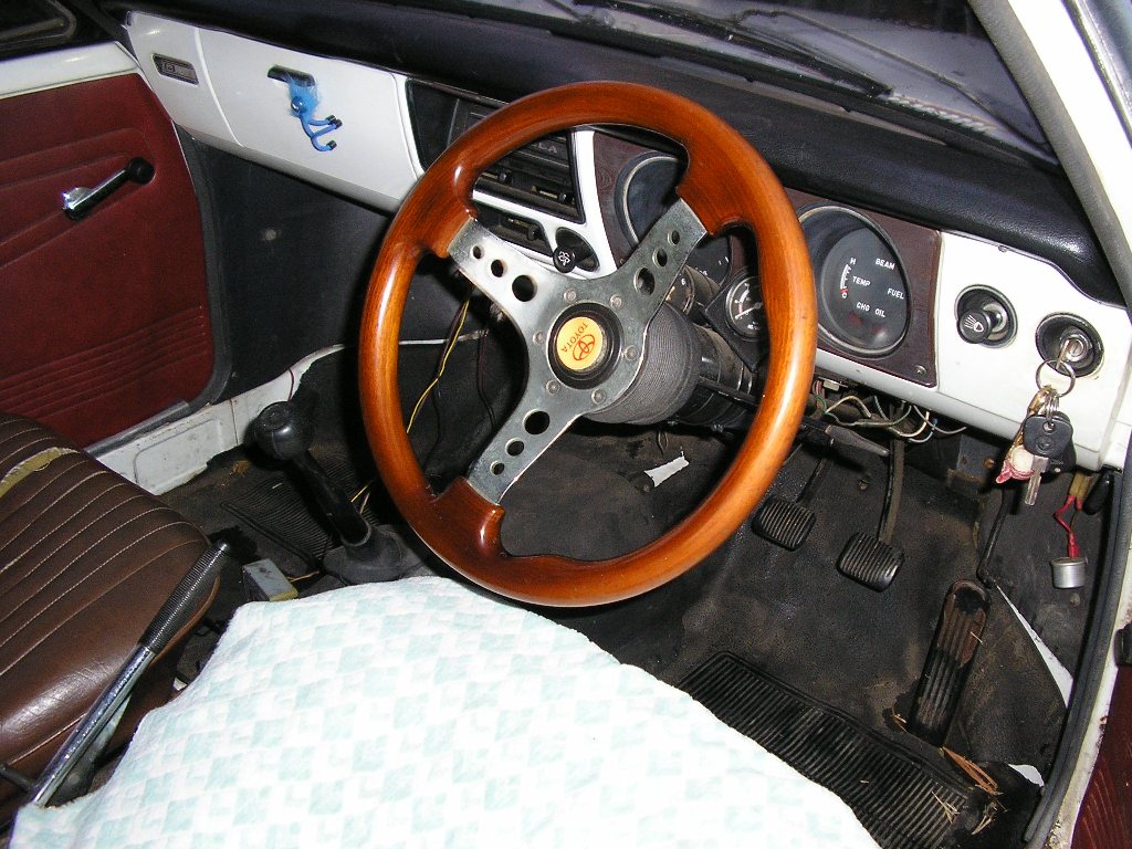

Currently in the process of changing over the much better seatbelts from the ke16 into the sprinter, and making up a fitted seat cover for the rear seat out of a picnic blanket. The top of the rear seat is stuffed but the cover should do the trick until later on down the track when I plan to get the seats retrimmed.

Well got the new seatbelts in and the missus finished tailoring a picnic blanket to better fit the rear seat. Looks a lot neater now.
Little bit more wiring to do to finish the stereo. Works great with the iPod straight into the amp. Bit weird with the sound only coming from the rear, but I'll fix that soon with some front splits. At least is has got tunes now. No sub bass, but meh, the boot is only so big and fits the essentials, ie. a few cartons and some groceries.
No, not retractables. They are a set of Klippans that I've had in a few cars now. Retractables would be nice, but these ones hang up out of the way pretty easy. I like retractables in bigger cars, but in this thing for some reason I prefer a non-retractable seatbelt done up real firm.
They are not period seatbelts but it doesn't really bother me. They are in good nick whereas the old ones were faded and fraying.

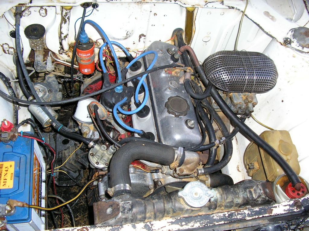

Might go up and try to tighten up the manifolds a bit. Have a leak at the extractor gasket on one or both of the center extractor pipes. Really I should pull the carb and extractors off and fit a new gasket, but don't really feel like the stuff around atm. The extractors are a bitch to work on in this thing... Leave it for another weekend.
Also might fit up the cable for the carb fuel enrichment circuit so it is easier to keep going when cold. Notice I didn't call it a choke, the DCD webers have a small 3rd barrel for fuel enrichment and don't run a choke flap. It is quite handy for carb tuning to see if you are running lean.
Tightened up the manifolds, the leak is nowhere near as bad now. Got a working choke. Changed over the sideview mirror with the one on the ke16, the mirror should stay in one place now. Also did a temporary fix to the rear muffler bracket which was broken.

Gave the ke15 a quick tune this arv. The point gap was real small, so opened it to 0.5mm and retimed it to 12 degs btdc.
Can't remember the last time I readjusted the pointgap and reset the timing. The points would have to be 5-6 years (or more) old... The contact area doesn't wear at all with the Silicon Chip (DSE) HEI kit, just a bit of rubbing block wear.
Haven't driven it on the road yet as I'd had a few beers, but around the backyard it has way more throttle response. Idle along in first and blip the throttle and the thing wheelspins like mad. It is like it is free revving in neutral. In second once you have 15kays on the clock the same thing happens.
Before it had a hesitation when the secondary opened. Be interesting to see how it goes tomorrow.
