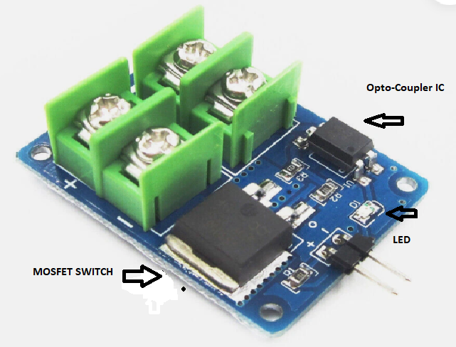

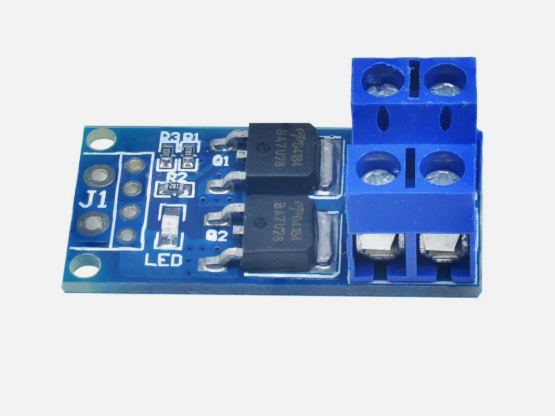

The dual MOSFET ignition output drivers, for powering COPs & external coil ignitors, (model TC-4424), are mounted on the Speeduino PCB.  I therefore cannot use these for triggering the 4 off COPs, so the Speeduino PCB, remains "unmolested".  The outputs of the four (4) off 4075 ICs, on my switching module, are highly unlikely to have enough current capacity, to trigger the COPs.  I therefore used external MOSFET opto isolated modules, to switch the four (4) off COPs. I've hooked up the outputs of my Sequential to Wasted spark switching module, to four (4) off these small MOSFET modules.
That's the MOSFET on the LHS, & the little IC on the RHS; is the opto coupler.
These are available on ebay, & are very economical.   I paid $ 1.62 each, off memory.
You can even purchase a dual version of these, with two (2) MOSFETs mounted on the one PCB.
For about $ 8.00, You can have four (4) MOSFETs, to switch your four (4) COPs, or ignitors.  However, the dual ones, don't appear to have opto-couplers, for the input signal. I might just add four (4) opto-couplers to my switch module output, so that it doesn't matter if the MOSFET module used; does not have an opto-coupler built-in.
The Opto-Coupler I generally use, is the MOC5007.   This Opto has "hysteresis" built in, which makes the system, I've created; very "noise tolerant".
The beauty of the both MOSFET modules, I depicted above; that they both have a little LED on the board; so You can see that a signal is being received from Sequential to Waste Spark switching module.

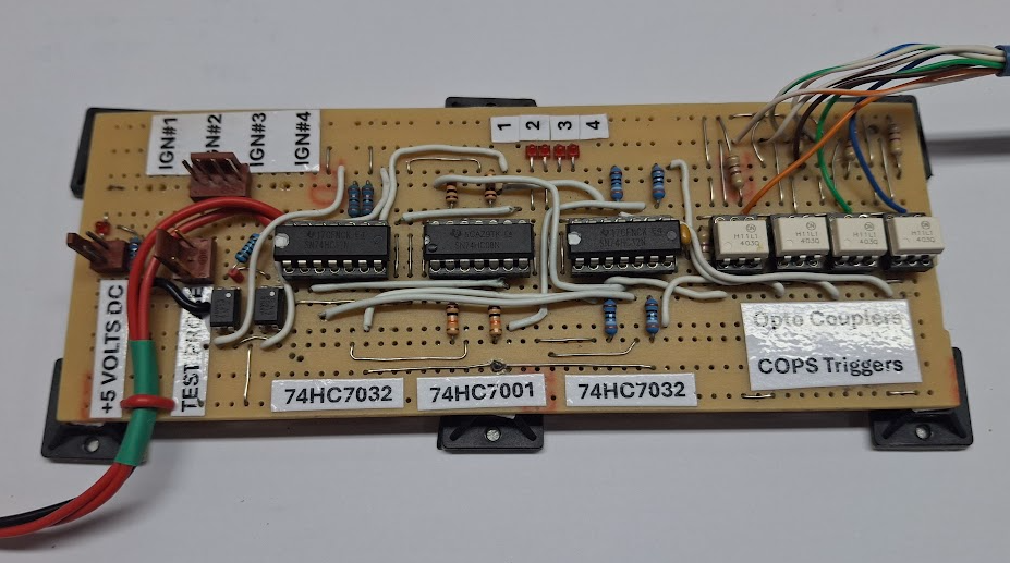

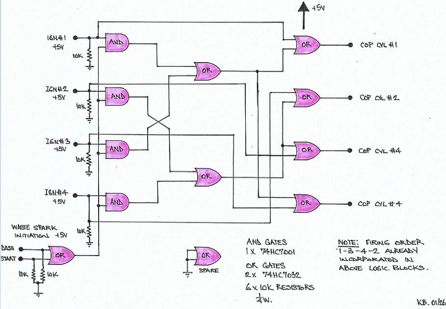

On pages 6 & 7 of this thread, I noted my interest in providing a switching mechanism, to my system; that allowed it to be switched between Sequential & "Wasted Spark" mode during the starting procedure.  Starting an engine in sequential, can take up to 2 revolutions of the crankshaft, before the ECU receives a CAS pulse.  I would also like to be able to manually switch the engine firing (& injection) mode, to "Waste Spark" manually; whilst driving under different conditions; to see if I can discern, any difference in performance; under different real road load conditions.

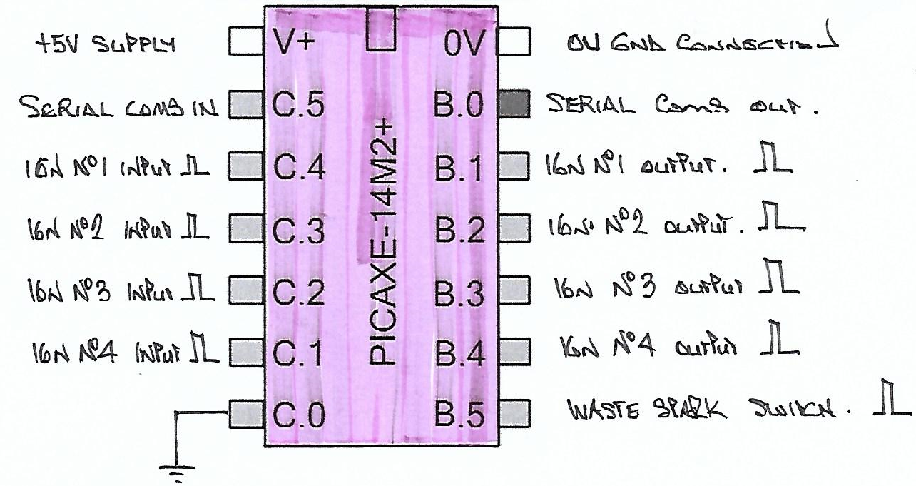

I was able to produce the logic to achieve this, using 5 off dedicated logic ICs, as depicted in an earlier post.  Works perfectly, but unhappy, that I need "real-estate" on my printed circuit board for 5 off dedicated integrated circuits (ICs).
As the logic itself, is pretty simple; I was interested to see if I could program the logic, into a small dedicated programable microprocessor.  It was successful; & I used each & every pin on a 14 pin Picaxe 14M2 micro, which are commonly used for education purposes. However, they can be run at up to 32MHz, so are no slouches. They are only a few dollars each, & can be programmed in a free editor program, using "basic" commands.  In fact; the program only required eleven (11) lines of code.  As I stated earlier in this thread; the Speeduino setup does not provide for setting up a firing order, in TunerStudio. It has 4 off ignition outputs, & four of Injector outputs, which simply fire in order from the board, as 1,2,3,4 .  It is up to the person, wiring up the system, to connect the 4 off ignition outputs to the correct cylinder coil &/or injector.
In a "K" series engine.
Ignition No: 1 Output to cylinder No: 1
Ignition No: 2 Output to cylinder No:3
Ignition No: 3 Output to cylinder No: 4
Ignition No: 4 Output to cylinder No: 2
I was able to include this firing sequence, into the code, so that whilst installing the system, the firing order is imbedded.
Ignition No: 1 Output to cylinder No: 1 input
Ignition No: 2 Output to cylinder No:2 input
Ignition No: 3 Output to cylinder No: 3 input
Ignition No: 4 Output to cylinder No: 4 input

Update on the logic to switch ignition (& injection) on the fly.   The Picaxe 14M2 programable microprocessor needs interrupt inputs for the four (4) trigger pulses, from the Speeduino ECU.  Unfortunately, I found the 14M2 only has three (3) interrupt inputs.  I upgraded to the 18M2+ Picaxe 18 pin micro, which has seven (7) off interrupt inputs.  It worked well, but there were minute time differences between the time the pulses entered the micro, & when they left.  This would not be discernible at low speed revolutions; but could induce small changes to the timing, at higher RPM.  For that reason, I returned to the fixed logic I first started out with, but refined it; & utilised high grade CMOS HC logic integrated circuits, with hysteresis built in. The hysteresis produces very sharp edges on the output pulses produced, which reduces chances of any noise issues.
The "AND" gate IC I used was a 74HC7001 (4 x AND gates), along with two off model 74HC7032 (4 x OR gates).
The full circuit is depicted below, for anyone that wants to build it themselves.  It worked out nicely, using all but one "OR" logic element in one of the "OR" ICs.
Note that the common firing order for a 4 cylinder engine of 1 - 3 - 4 - 2 has already been incorporated in the design.  The Speeduino ECU for which I am using this, does not have provision for allocating or programming the firing order. It simply outputs 4 off ignition pulses, in succession. It is up to the installer, to wire the four (4) ignition outputs to the correct cylinder.  Any questions, just give me a yell.  If You are questioning whether there is any point, or good reason, for adding this wasted spark/sequential switch; consider what A.I. had to advise about it, when I questioned it.

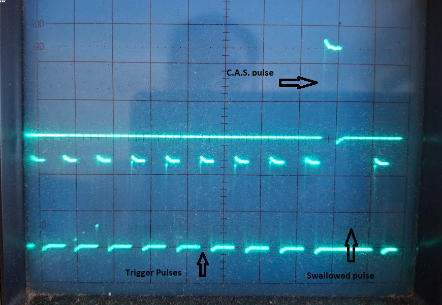

Been a few weeks, since I introduced the "switching on the fly"; & on cranking, of the Speeduino ECU ignition outputs from "Sequential' to "Wasted Spark"; & visa versa.

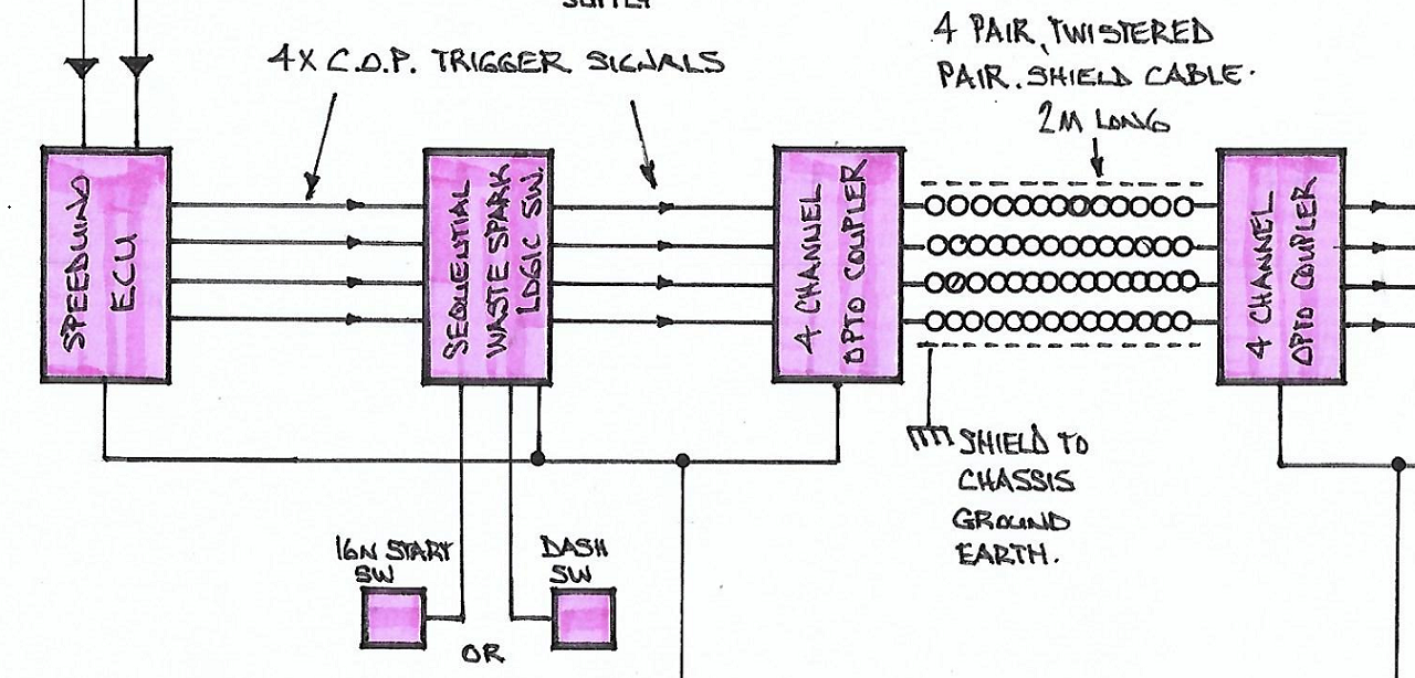

  Next post, I'll describe how I have used opto-couplers, to totally isolate one part of the system, from another; as well as using totally "shielded" twisted 4 pair cable, across that electrically noisy/hazardous path/journey from the ECU on the fire wall, or under the dash; to the four (4) C.O.Ps. on the engine itself.  I've actually used a total 13 off opto-couplers in the circuit, plus 2 off for the signals from the ignition starter switch & dash switch, to change the spark control from sequential to waste spark, on the fly.

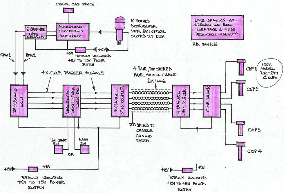

I want to describe each block in yesterdays sketch, so You can understand the logic, of why I have headed this way.
In truth, You don't really need any of this additional electronics.  The four ignition outputs from the Speeduino will drive the four (4) COPs without too many issues.  However the Speeduino ECU, just produces four (4) pulses in a row, & has no particular firing order, built into the sequence of those four pulses. It is up to the installer to connect the four (4) ignition outputs, 1,2,3 & 4, to the appropriate ignition coil or C.O.P., based on the firing order; which in our case is 1 - 3 - 4 - 2. In other words . . .
Speeduino Ignition O/P#1 to C.O.P. 1
Speeduino Ignition O/P#2 to C.O.P. 3
Speeduino Ignition O/P#3 to C.O.P. 4
Speeduino Ignition O/P#4 to C.O.P. 2

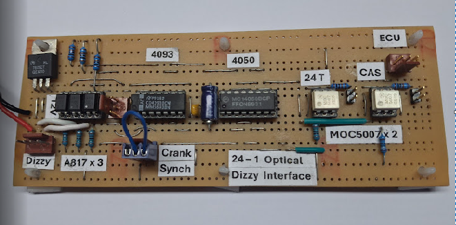

The distributor is where this all starts; as it provides a string of evenly spaced pulses per revolution, which is actually equal to two revolutions of the crankshaft. A distributor with a 24 pulse output, is equivalent to a crank mounted trigger wheel with just 12 off teeth or magnets etc.  They both produce 24 pulses per 720 degrees rotation of the crankshaft.
I settled for the distributor to produce the trigger pulses, as it the easiest way for anyone get started, with this exercise.
Take an olde Bosch produced K series distributor body, & gut it, & fit an optical punched disk assembly from a Nissan, Daewoo, or Mitsubishi engine, & you are away & running quite quickly.  The added benefit for me, was if while I'm road testing this system, & it breaks down, or  it just stops: I can very quickly revert to an original dizzy, & get back home.  However, by using a cam driven dizzy, we are introducing the "wavering" of the C.A.S. (Cam Angle Signal/Sensor), as a result of the "slop" & "wear", in timing chain; sprockets & helical gears; & belt flex/stretch in twin OHV engines. Earlier in this thread I described the first block in yesterday's block diagram; labelled the "Distributor Processing Interface".  Basically, it logically produces a C.A.S. pulse when a single pulse from the crankshaft, coincides with the wider C.A.S. distributor pulse, once every two revolutions of the crankshaft. The two outputs of this "Distributor Processing Interface", are then feed into two (2) opto couplers, which are a device that uses a infra-red light source inside the MOC-5007; such that the input terminals & the output terminals are completely electrically isolated (no common ground circuit).  In addition, the MOC-5007 opto-coupler has hysteresis built into it's switching, which guarantees a very sharp clean transmission between the On & Off parts of the signal. ((basically, is switches on, at a slightly higher threshold voltage, than the voltage at which it switches off. eg: On a 0-5V signal it might say switch on a 4V; but not switch off, until the signal gets down to say 2v.  This leaves a 2V dead-band in the middle of the switching band.  I've made full use of opto-couplers at several places in this circuit, & oscilloscope checks of the final +5V pulses, arriving at the trigger inputs of the four (4) off working C.O.P.s; indicate very clean & sharp pulses.  These resultant pulses are fed into the RPM1 & RPM2 pulse inputs on the Speeduino ECU, which certainly won't need the assistance of any VR Conditioner; to produce clean sharp pulse to the micro-processor. ( Oh, I hate those VR sensors)
This Distributor Processing Interface actually has a total of 5 off Opto-Couplers on board. Three (3) off isolate the pulses coming into the board from the trigger pulse & CAS pulse from the dizzy, whilst the third isolates the single C.A.S. pulse from the crankshaft pulley.
Tomorrow; I'll describe the Sequential/Waste Spark switch block, & opto-coupler stage, before the four (4) C.O.P. trigger signals are sent on their merry way, out into the engine bay; on-route to the four (4) C.O.Ps (Coil On Plug)  mounted on the engine.
Cheers Banjo

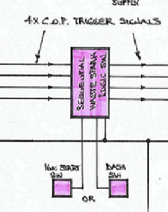

The Sequential / Wasted Spark logic switch,  took a little longer to produce. The idea was simple; but the turning it into hardware, took a few  tries, to get it right.  The brief to myself was to take the four (4) off ignition pulses from the Speeduino; & then produce the same four pulses, in the correct firing order; in either sequential or wasted spark mode.
Sequential, has been; & still is, the preferred way of operating the ignition system in modern vehicle engines; primarily as emission standards in most developed countries stipulate that. However, in theory, wasted spark operation, particularly when starting & cranking the car; should find C.A.S. pulse synch earlier, & therefore start the engine more quickly.
A search on the web, using A.I. found that a number of modern car manufacturers do; exactly what I was theorizing; by starting the car in wasted spark mode, then switching to sequential, once it is running.  It's hidden deep inside these vehicles ECUs, & no one would even suspect that is happening, every time the engine is started.
The starting was very simple, as when You turn the ignition switch on, you twist it that little bit further to place the switch in the “start” position. I simply picked up this signal which normally drives the starter motor starting relay, & fed that to the “Switching Logic Module”, via an Opto-coupler.  (12V signal in, & 5V logic signal out.)   As soon as the engine starts, & you release the ignition switch start position, the logic switch automatically reverts back to sequential ignition mode.   However, I also wanted for my own interest; a switch on the dash, so I could switch the engine ignition mode from Sequential to Wasted Spark mode; so I could see if I could detect any improvement in particular driving conditions & engine loads.  Again, this dash switch would be electrically isolated from the 12V system, via an opto-coupler.  There was also an “OR” function built in, so that the Sequential  to Wasted Spark mode switch would take place, from both a start switch “or” a dash switch.
I started out using "fixed logic" for this switch; changed to a single processor integrated circuit, requiring programming; but eventually simplified the hard logic model, with some very fast logic chips. The outputs of this module, already now had the firing order required built in.   It is simple then to attach the four (4) C.O.P. trigger signals, to the right C.O.P.
Simply; 1 to 1; 2 to 2; 3 to 3; & 4 to 4.  The circuit appoints the correct sequencing.

The next part of my extra modules & modifications, after the ignition signals have been produced by the ECU; were processed to be either in waste spark, or sequential format; was to address the area where the four C.O.P. trigger signals, leave the "safe confines", of a shielded metal ECU case, & head out across 1 - 2 meters of space in the engine compartment; to the C.O.P.s on the top of the engine. Four (4) little 5V pulses, just 3-4 m/sec wide, in a "hostile" environment, that is full of electrical noise, that can be picked up, & which results in distorting the shape & timing of these critical C.O.P. trigger pulses.  The wiring of these C.O.P. trigger signals could simply be carried out, by placing the signals in a shielded cable, where the "shield" in connected at the ECU end only, to a good chassis ground. I decided to go two steps further. One was to isolate the four signals completely from each other, by placing eight (8) opto-couplers; one at each end of each trigger line.  In addition to that the four pairs of wires in the cable are twisted pairs.  That allows any induced signal into one wire would also be induced into it's return path, & they would cancel the noise out.  This virtually makes the path across the noise hostile path to the COPs; noise free, & results is the four signals arriving at the C.O.P.s as good, or better, than when they left the ECU. They should/could be better; as all eight (8) opto-couplers have hysteresis switching built in, which results in their rise & fall lines, being extremely sharp. (very important) as the rising edge, in particular, carries the timing information to each C.O.P.
Next time, I'll describe the final block, to provide the power required to these four (4) =5V trigger pulses with P type MOSFETS, right at the head of the engine.

The most likely part of the ECU over system; where noise can be "induced", into the system, is at the COPs, themselves; right at the top of the engine.   C.O.P.s commonly have a common return line to chassis ground, which serves both the +12V supply that charges the primary of the C.O.P. ignition coil, & the return line for the +5V trigger pulses.   There seemed to be little I could do in this area, as it was widely acknowledged on the net, that it is a major source of trigger signal degradation.  It was then, I discovered that there are C.O.P.s that have a separate return line for the +5V trigger pulses. They are used on late model V6 Commodore & GMH vehicles. I purchased a new one on line, & it does work admirably.
It is an ICON brand with P/N IGC-277M.
This provided the ability to separate the +12V supply return, & the +5V trigger pulse return line.   However, I did notice, when I placed a multimeter between these two returns, that it was not an open circuit.  There was a resistance between them, of exactly 10K ohms.  Puzzled over this, & then asked Gogle A.I.
Why is there a 10K ohm resistance between the two +12V & +5V trigger signal, return lines, on an ICON model IGC-277M C.O.P. ignition coil, when I was led to believe they were completely separate from each other.

However My 4 off +5V trigger signals leave the shielded 4 off twisted pair cable & enter the final module via 4 off opto-couplers, so there is no signal or ground return line. I then decided to produce a +5V power supply for providing the 4 off P Type MOSFETs to provide the power to the trigger inputs on the C.O.P.s.  You can obtain little 12V DC to 5V DC isolation module, where there is no connection at all between the ground of the ingoing 12V supply; & the ground of the outgoing 5V supply.  Then I discovered, that the +5V output was not regulated. After a lot of research & experimentation, I decided to obtain a 12V to 9V isolator module, then feed the 9V into the input of a precision LM2940 +5V regulator, which will supply the P type MOSFET switches (TC4424).  The +5V trigger pulses are not "hungry", in terms of power/DC current required, so the TC4424 P Type MOSFETs are fine, & are what are fitted to the Speeduino ECU.
So that is it, basically, & it is all working on the bench perfectly, with a 4K head & four spark plugs. Just need to tidy it up a little bit, before I connect & install in on the 5K engine.

Late yesterday, I built a new interface board between the optical distributor, with a 24 - 1 punched tooth S.S. disk.  I changed the inversion of signals around, which saved the use of one (1) off 14 pin logic integrated circuit.  This particular board incorporates the use of a single C.P.S./ C.K.S.(crankshaft position sensor) to logically AND with the single C.A.S. pulse produced by the distributor, to produce a single stable C.A.S. pulse per every two crankshaft revolutions. I had it all hooked up this morning & working with the Speeduino, pushing out trigger pulses reliably.  I then unplugged the Hall Effect sensor, that was producing the combination C.A.S. pulse; expecting the Speeduino to stop producing trigger pulses.  IT DID NOT !  It continued to pump out trigger pulses, without any C.A.S. pulse at all.  I then turned the Speeduino off; restarted it, without the C.A.S. pulse, & nothing happened at all. (no trigger pulses)  I'm sitting there for several minutes scratching my head, as I had never thought about this previously.  How could this be.  So I Googled it, & there was a lot about it.  Apparently, it is a flaw in the original design of the Speeduino, that was left there, because of a safety concern.  Apparently; once Speeduino gets a signal from the C.A.S. sensor, it can do without it, as it can produce a count of the pulses around the perimeter of the crank or camshaft disk/wheel/etc. to know where the C.A.S. pulse should be.  So the reality is; that if You start the engine OK, & drive all day; but during the day, the C.A.S. signal drops out, due to faulty / broken cable, or a crook Hall Effect sensor; the engine never stops. However, when You come out of the motel next morning, to continue your journey; the engine will not start.  I was flabbergasted !
The logic is, that You don't want the engine to cut out as You carry out a RH turn, across oncoming traffic, because of a faulty connection, on your C.A.S. pickup sensor.  I see the logic of that; but the driver is totally unaware of the fault, until He/She goes to next start the car.
So I do some research, & find there is a "fault signal" (lack of C.A.S) out of the micro, which you'd then have to wire out, & hook up.  Apparently, TunerStudio has a little light that comes on, if there is no synch; but we don't drive around with TunerStudio running on our laptop, on top of the dash.

Well almost a couple of weeks later, & I'm still shocked, that the C.A.S. is only used for starting the engine, & plays no part thereafter, until You next restart the engine.  I've researched it, &  asked Google A.I., and it is true !  Apparently some modern ECUs in production cars, behave the same way.  The theory behind it is, that 2 off revolutions of the crankshaft, is too long to wait, to get a new C.A.S., as in two revolutions, the engine could have accelerated or de-accelerated, considerably.
The literature on the net;  keeps saying things like, "guessing where the next C.A.S. will be".  "Guessing " ?  I thought the whole idea of the C.A.S. was, that you had a "rock solid" timing marker, pre T.D.C. No: 1 cylinder, so that the next four, six, or eight ignition triggers & injection signals would be spot on.  So everyone keeps mentioning , about timing irregularities due to the camshaft drive wear in sprockets & chains, & belt stretch & whip, on OHV engines, & after starting, the C.A.S. never gets used again.  So why did I go to the trouble to get rid of those issues by logically creating a  C.P.S. / C.K.S. (crank position signal), when it is only used to start the engine.  Apparently, in most modern cars' ECUs; once you start the engine, using the C.A.S., you can drive the car all day, & never use it again. I proved that on the bench, but researching the net, & asking A.I. confirms it is completely true, for a lot of vehicles.
So after this enlightenment, the next question is; why does the driver not know ?   I'm presuming that in many modern production ECUs, there is an error code is sent back to the system.
Sorry, but I want to know straight away, so I don't get stranded on the middle of the Hay Plains, because I stopped for 5 minutes, to takes some photos; only to find when I got back into the car, that the engine won't start.

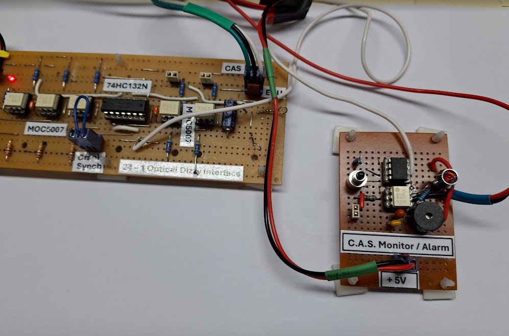

So I've been attempting to build a little auxiliary circuit, that is independent from the ECU; that can detect a missing C.A.S. signal, & alert the driver.  There is a bit of timing involved, & I finished up using a tiny Picaxe 8 pin microprocessor, to do all the work. I only needed a total of three inputs/outputs. (2 x inputs, 1 x output)
1. C.A.S signal In.   2. Alarm output.  3.  Acknowledge & Reset Alarm.
I've refined the code over a few days of testing, & it works extremely well.  When You apply power to the ECU, when you first start the car, You don't want the thing alarming, so when the ignition turns on, the alarm system stays quiet for 20 seconds, & does no detection; by which time the engine should have started, & be idling.  The program works by creating a window "timewise" , after the current C.A.S. pulse, when it expects the next  pulse to arrive. There is about a + 40% margin in the length of this window, as the engine may have accelerated during the next 2 off revolutions.  If the pulse does not appear, or get detected, during that next time window, the alarm is activated. The calculations of the window for detection, cover the rev range of 700 RPM, right up to 7000 RPM.  The alarm is in the form of a flashing L.E.D. & a small piezo electric buzzer. In addition to that; you want to know that the alarm system is working, so the buzzer gives a little blimp, & LED flashes every 8 seconds. I call it a "heartbeat" signal. You can turn of the buzzer off, & just have the L.E.D. flash once every 8 seconds. I've tested it for a couple of days, & it works perfectly, on the bench.
So we live & learn, but I'm not "out on a limb", as if & when either my C.A.S. or C.P.S./C.K.S. pulses fails, I actually have two fitted to the engine.  I have the C.A.S. single pulse generated by the distributor at camshaft speed. If the C.P.S. (crankshaft position sensor) fails I just use the C.A.S. from the dissy, without the logically "ANDing" with the C.P.S.  If the dissy C.A.S. pulse dies, then I simply place the engine in "wasted spark" format, & the engine will start, using the C.P.S. pulse only.
So I'm not going to get stuck in the middle of the Hay Plains.   I'm just wondering whether any modern ECUs, can automatically or manually can switch to wasted spark, if the C.A.S. fails.  Have to ask Google A.I. that; & see what it can find out.
