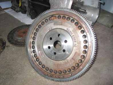

Simple Flywheel 36:1 trigger system
In doing these experiments, I've not wanted to reinvent the wheel, so to speak; or make mistakes or, "go down rabbit burrows" ; only to have to retreat.  However, this research, takes a lot of time on the net, reading articles & posts on other forums, about this subject. Recently, I've been getting AI to do this research for me; & to date, I've not found anything it has written, that was not accurate.
