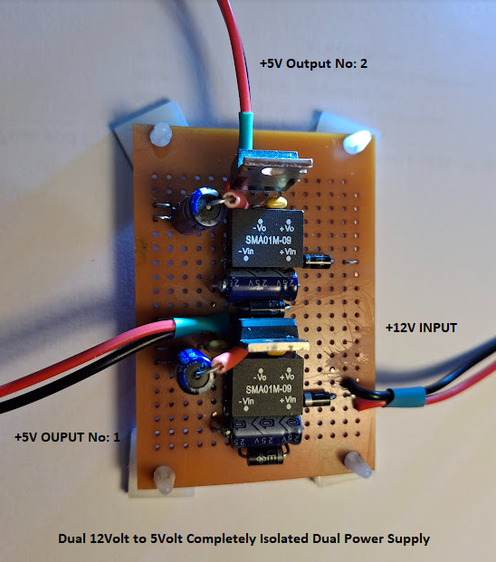

So I set about building an electronic power supply, which has a 12V input, & a 5V output, but absolutely no connection between them at all.  All possible using a tiny little "Meanwell" isolator module with a  12V input; & in my case a 9V output. I then used the 9V output, to feed the input of a +5V or +3.3V regulator (LM7805) precision regulator.  The 9V input is exposed to drop off, as the 12V battery voltage, can easily drop to 10V or lower; during cranking, on a Winters morning.  However, the Meanwell isolator at that level, still produced enough output; for the +5V regulator to still provide a consistent & stable +5V supply.
Exactly the same technique could be used with a 3.3V regulator.   If I eventually change over completely, to the rusEFI model uaEFI ECU, which happens to run on 3.3V DC.
Because my system is "compartmentised" into three (3) blocks of electronics, I've actually built three of these isolated +5v power supplies, so the load on each one, is quite conservative. There are other ways, I'm hoping to reduce noise in the system.  One is to use screened wiring, with the shield, tied to "chassis ground", at one end of the cable, only, on all cables out in the engine bay, feeding signals to COPs or injectors.

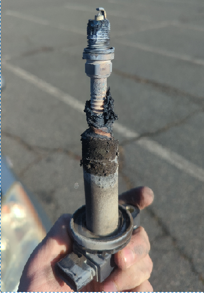

No !  That is not one of mine.  some guy on the internet, who suffered this fate, & had to rethread the spark plug-hole in the head, without taking the head off.
Cheers Banjo
