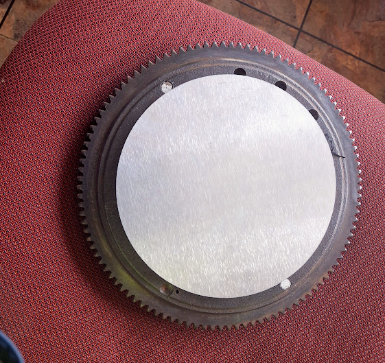

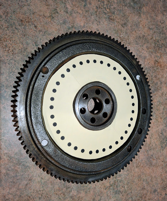

There is a growing pool of engine fans, who are resisting the use of the camshaft, for producing really accurate engine timing, despite the fact, that all early engines, worked this way; as the dissy was directly driven from the camshaft. The crank is the by far, the more stable way to create timing information that is constantly changing.  However, there is some resistance, by those that are engaged in some forms of motor sport; like rallying; that the crank pulley trigger disks etc, are too prone to damage from road debri being thrown up into this area.
There is however, another way, which involves placing the trigger wheel, on the rear of the flywheel, where it is totally protected. Funny, when I first started this Timing Accuracy journey; I tried counting starter teeth on the flywheel, until I discovered, there was rarely a flywheel, with the number of teeth, equally divisible into 360 degrees. However, fitting rare earth magnets to a aluminium plate, in behind the flywheel, is a very protected area.
I've just received a large alumium disk, to which I will fit 36 off, rare earth magnets, & it will be installed into the rear of the flywheel. The Hall Effect sensors, will be mounted behind the sump, through the large steel plate, between the bell housing & the rear of the engine block. I've mocked it up, in cardboard, & it will all work well.
Just got to get the disk & flywheel machined, & it will be a very stable & accurate way of producing rock solid crankshaft pulses , for the ECU, & leave the lower front of the engine, complete unmodified & molested.

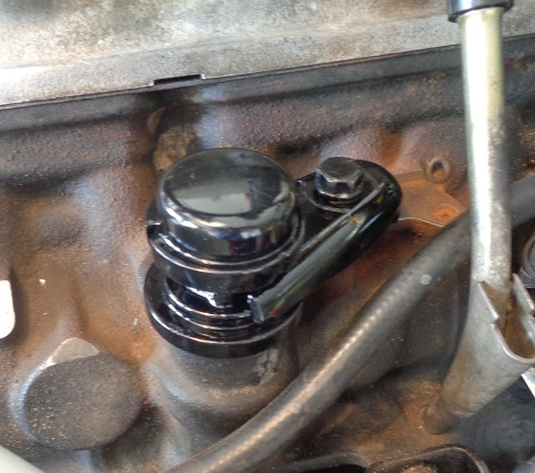

My dissy, is not for sale. The one I depicted, does not even belong to me. I have been assisting a friend of mine, here on RollaClub.  Even if You decide to not use a gutted dissy; You will still need to make up a dummy shaft & cap, to fit in the dissy location point; to drive the oil pump, directly below the distributor.
Olde K series Denso dissy cut down, & a dished Welch plug, sealing the top of the shaft.

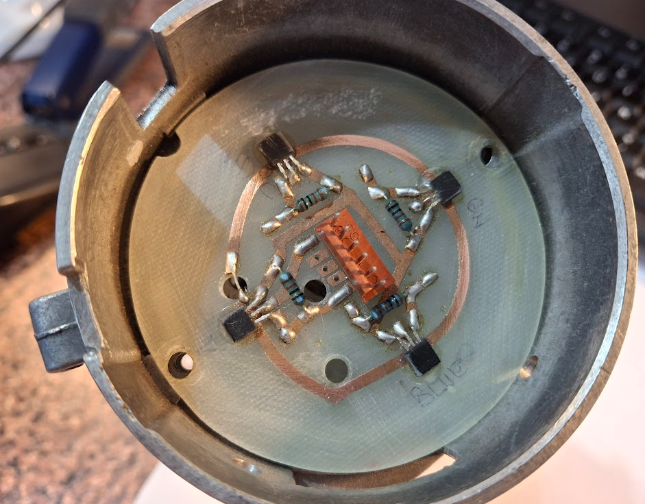

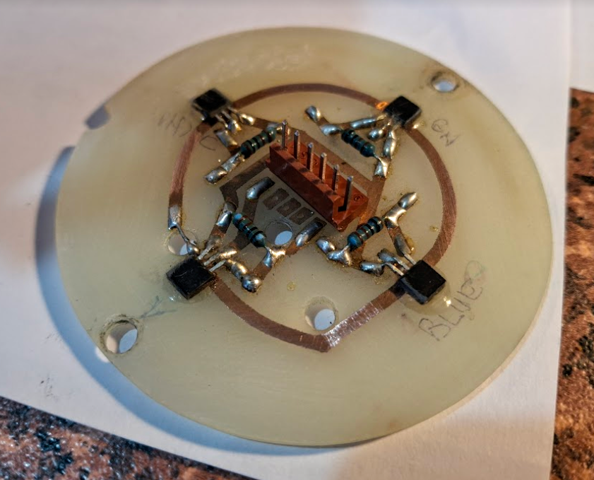

This was an experiment I tried a few years ago. I mounted a single "rod" rare earth magnet, on the spinning plate.
Over the top of that, I mounted a piece of printed circuit board, with four (4) off Hall Effect sensor elements, that picked up the pole of the magnet, spinning below the circuit board.  It worked well, & operated like as an "electronic rotor button"; as it switched four seperate ignition coils, on & off, to their respective spark plugs.  I ran it in my KE-30 for about 6 months, & it worked perfectly, in co-ordination, with a Jaycar programable ignition module.

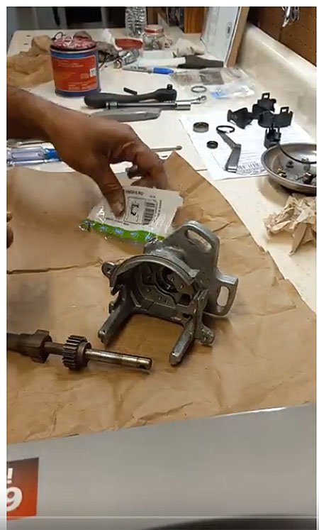

I have noticed on ebay, that there appears to be a replica of these dissies, produced; although I haven't been able to find a local ebay seller, stocking them in Australia. It would have to be purchased from an ebay seller in China.
The reason these have come to be; is that the 5K Toyota engine, is greatly "prized", in S.E. Asian countries; but particularly, Malaysia & the Phillipines, where they fit them in mini Jeeps, & in Malaysia they power racing water canoes.
https://www.youtube.com/watch?v=PbGLWHxeru0
One is going to set You back, about AUD 300, but You will get a base component with new bearings, cogs & seals; which will cost You money if You purchase or find a second hand one; & then have to source all the bits to recondition it; even before converting to a CAS & cam/crank trigger wheel.

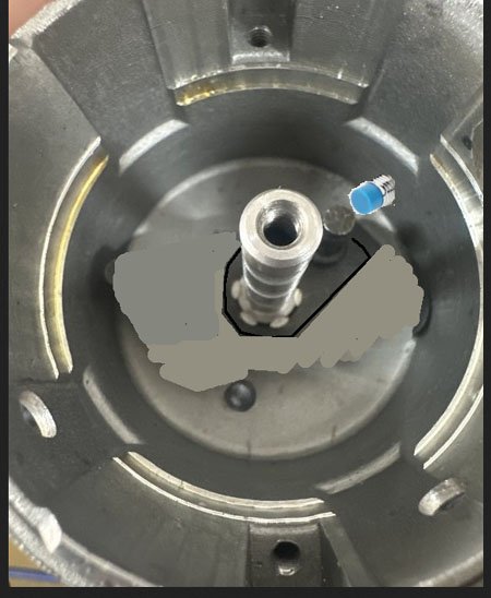

Thanks for the help i appreciate it, the only thing is i don’t know how to make it i’m hopeless at this stuff thats why i’m trying to find something to buy.

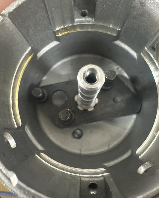

I’ve given it a try but i need help with something am i meant to take off everything and just leave the shaft or?
do i cut the black parts off?image.thumb.jpg.20dc7a1d8ef8d787acec759ebe43c01e.jpg
cheers

You could cut all those pins off on the spinning base plate; including the centre shaft, & fit a rare earth magnet, with it's South pole facing vertically, at the top.  Then refit the plate, with the two (2) screws in the case, & drill a hole in the plate, in line with the magnet pole, to mount the Hall Effect sensor vertically through the plate. The Hall Effect sensors are cheap & available, & most sense a south pole, & are mounted in a threaded tube, so are easy to adjust, so you have a gap of 1-2mm between maget south pole face, & hall effect sensor face.
N.B.   Don't try to cut any of those pins off, without removing the shaft assembly from the disributor body.  You will have to remove the roll-pin, in the "gear", at the very bottom of the shaft, so You can push the shaft up, & out of the distributor.
Alternatively, You could cut off 2 off the three steel posts, & leave the longest &image.png.7545b543b62cb59c2ce33f343023d0cc.png furtherest from the centre, & sense it with a Hall Effect sensor, that sensor iron metal, rather than a magnet pole, like below.

I was thinking the Hall Effect sensor on the pin at 2o'clock, like this
Chop the plate down to just an arm holding the post and mount the sensor through the wall near it. You may not even need the post, just the end of the arm swinging past might be enough to activate the Hall sensor. Banjo will know!
That gives you a cam position signal to tell the ECU that #1 is the next cylinder to fire.
The crank position signal is the hard one, the more teeth you have to read the more resolution the computer has. So the 4AGE uses 24, but others use 36 and some use less. Finding what is essentially a gear wheel to mount above the cam sensor will be the hard part, either find a steel one from a distributor, or make one out of an alloy disc and put magnets in it. You can see the factory one in that image of the distributor I posted above, lots of gear teeth close together.
That disc gets mounted on the shaft further up, and that Hall sensor goes in the side or through the lid.

The video was a 4AF distributor, cheap as chips and extremely common, which is why it would have a different construction to the 4AGE one you have. However if you press the wheels off a 4AF distributor you can re-size the holes to press them onto a 4K distributor, is that what you found. Take the 10mm holes out to 10.88 & 12.44mm.
If the engineering works, that would be the simplest way to make an ECU cam/crank sensor package for a 4K. Otherwise, its magnets and an alloy disc.
