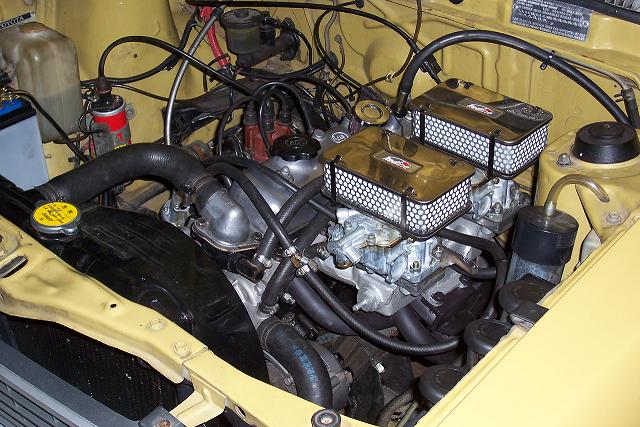

Hi, yeah I'm going to use the twin webers that i'm currently running with extractors. The carbs are pretty good but they are a bit to big for the 3k but should be just fine for the 1500. I use to have just one single weber on it and that seemed to be okay. :dance:

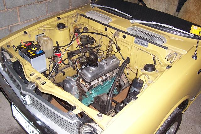

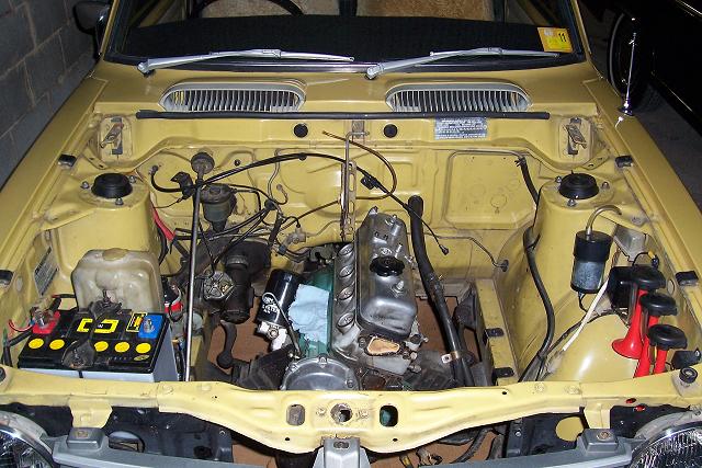

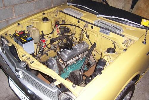

well I've got the engine all pulled to pieces and ready to lift out.
here are a few pictures of the old 3k motor stripped down

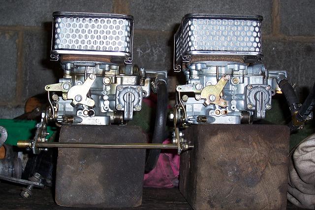

these are the twin carbs that are going on the 5k, they are off my 3k motor

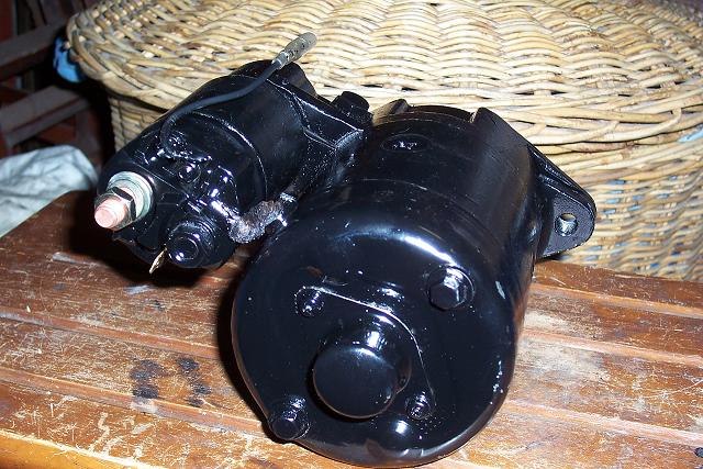

Also I got the starter motor recondioned it needed bushes and a new solenoid

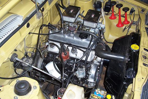

I've got the 5k in and going, had to get the distributor re-curved because of the compression and cam. Here's a few pics

Yeah I had the 5k in when you saw me the other day. It goes a lot better than the 3k but I have to take it easy because I'm just running it in at the moment. :(
