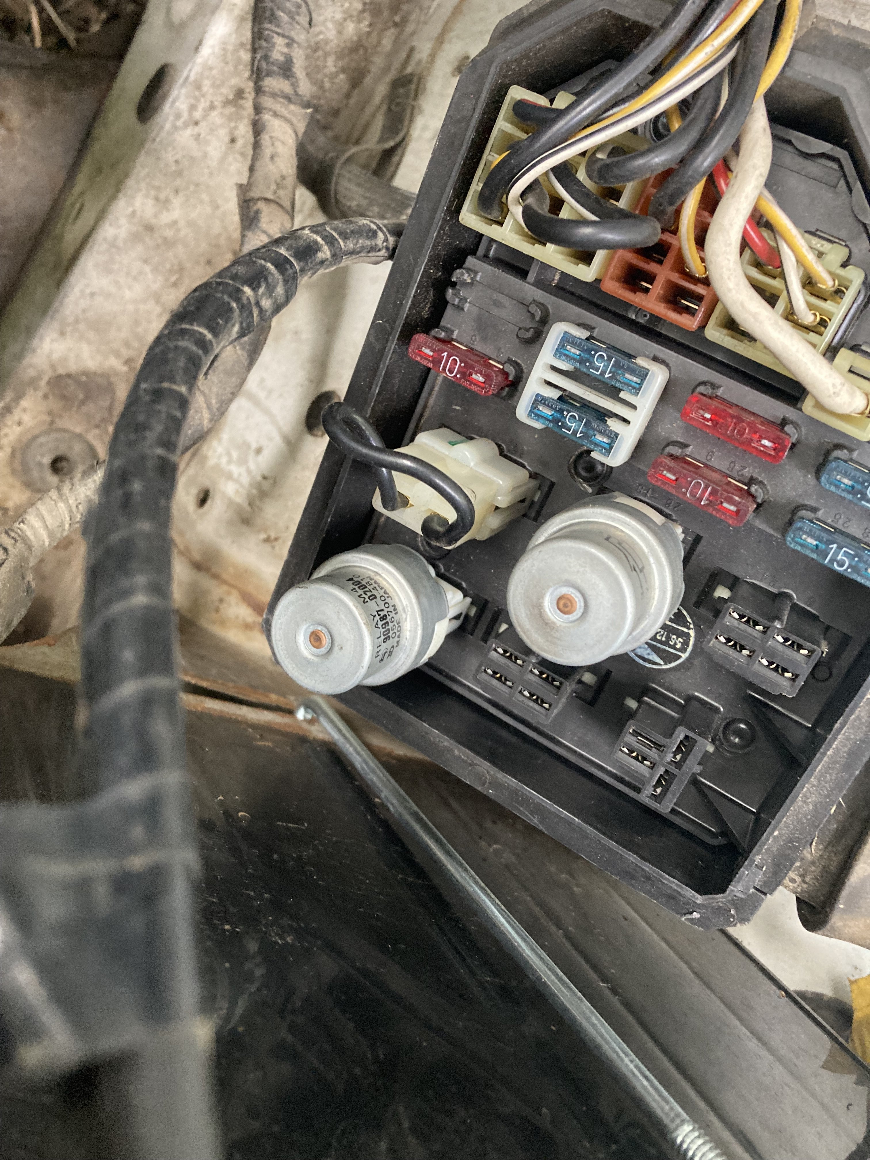

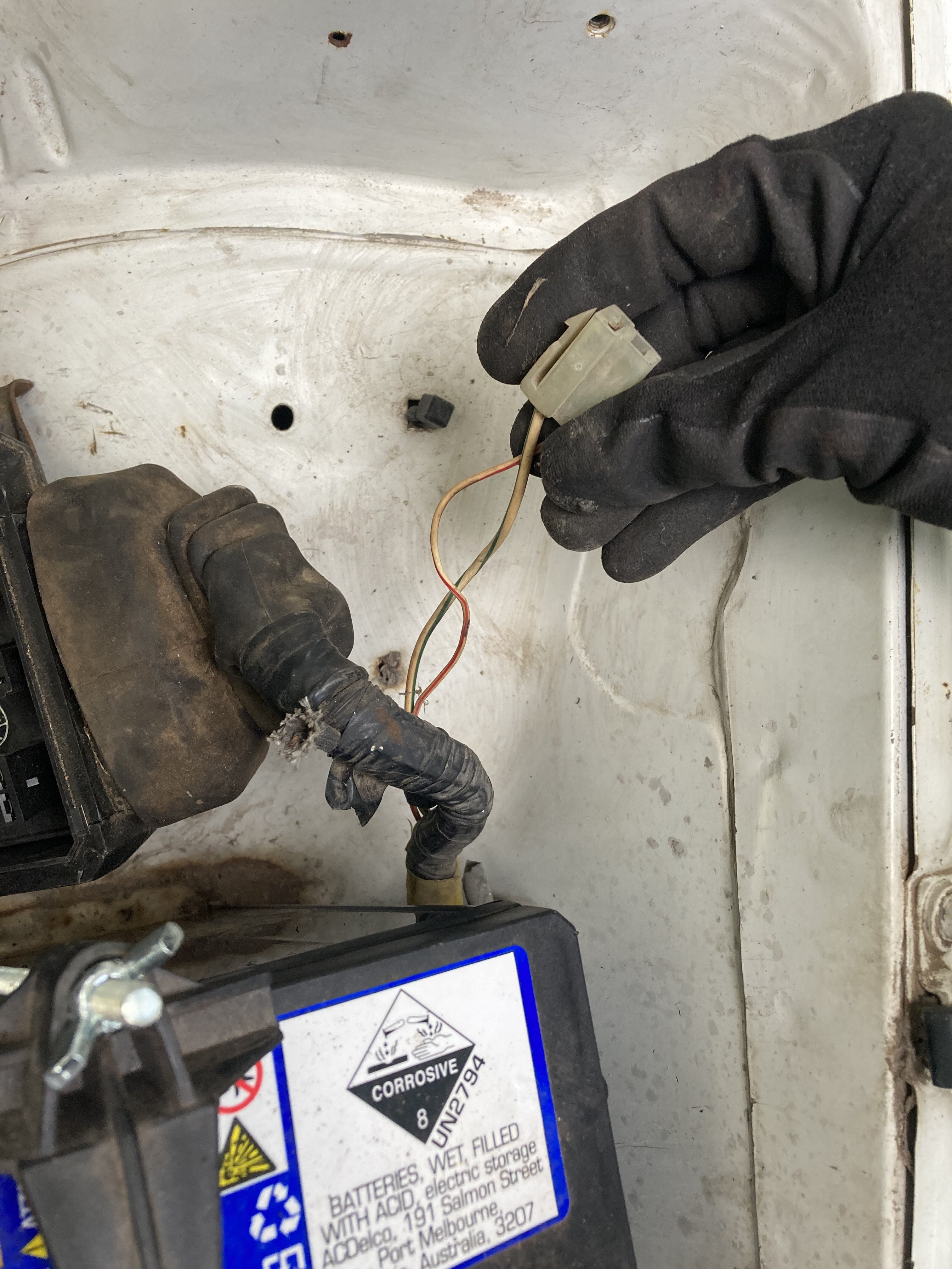

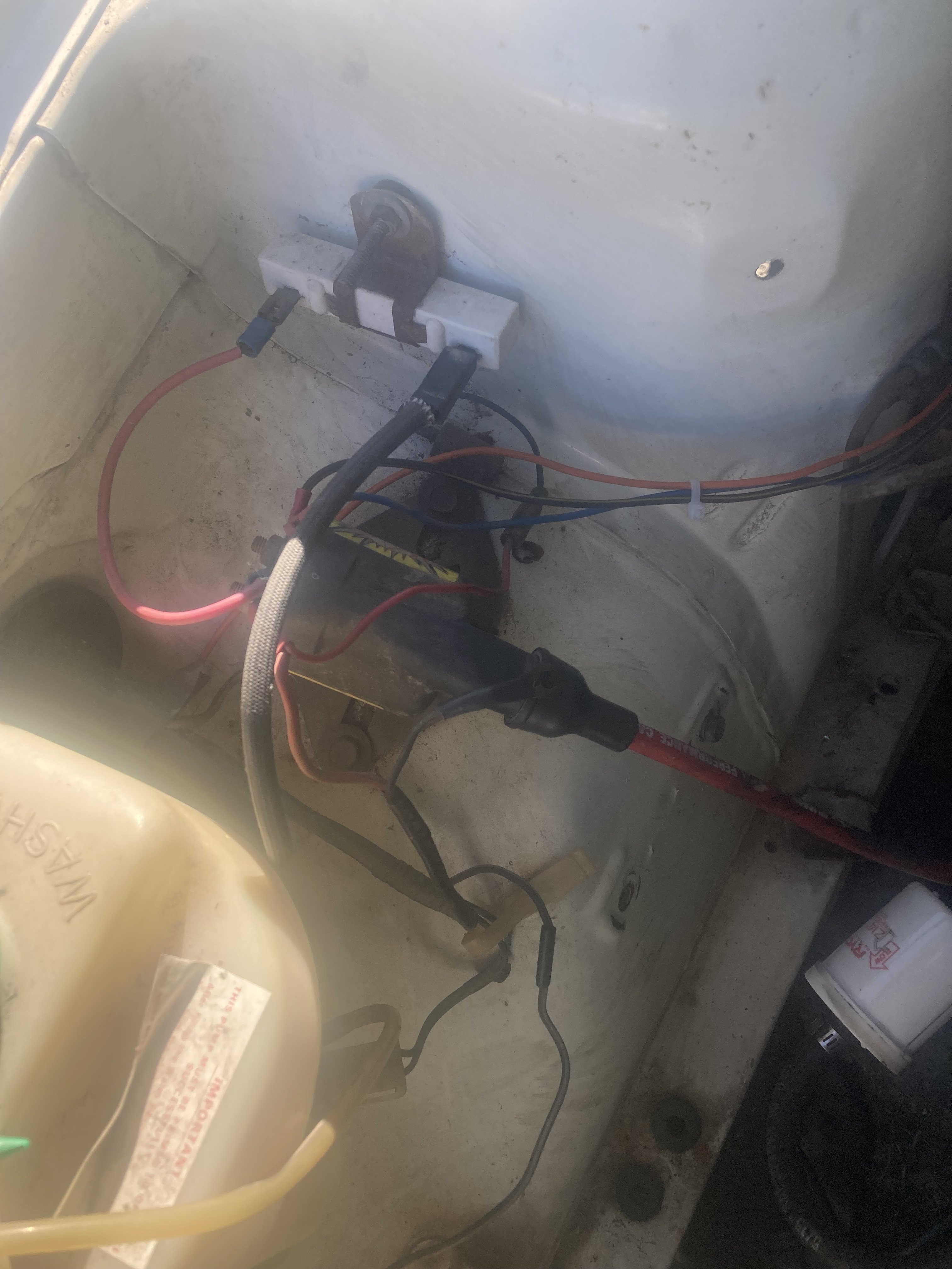

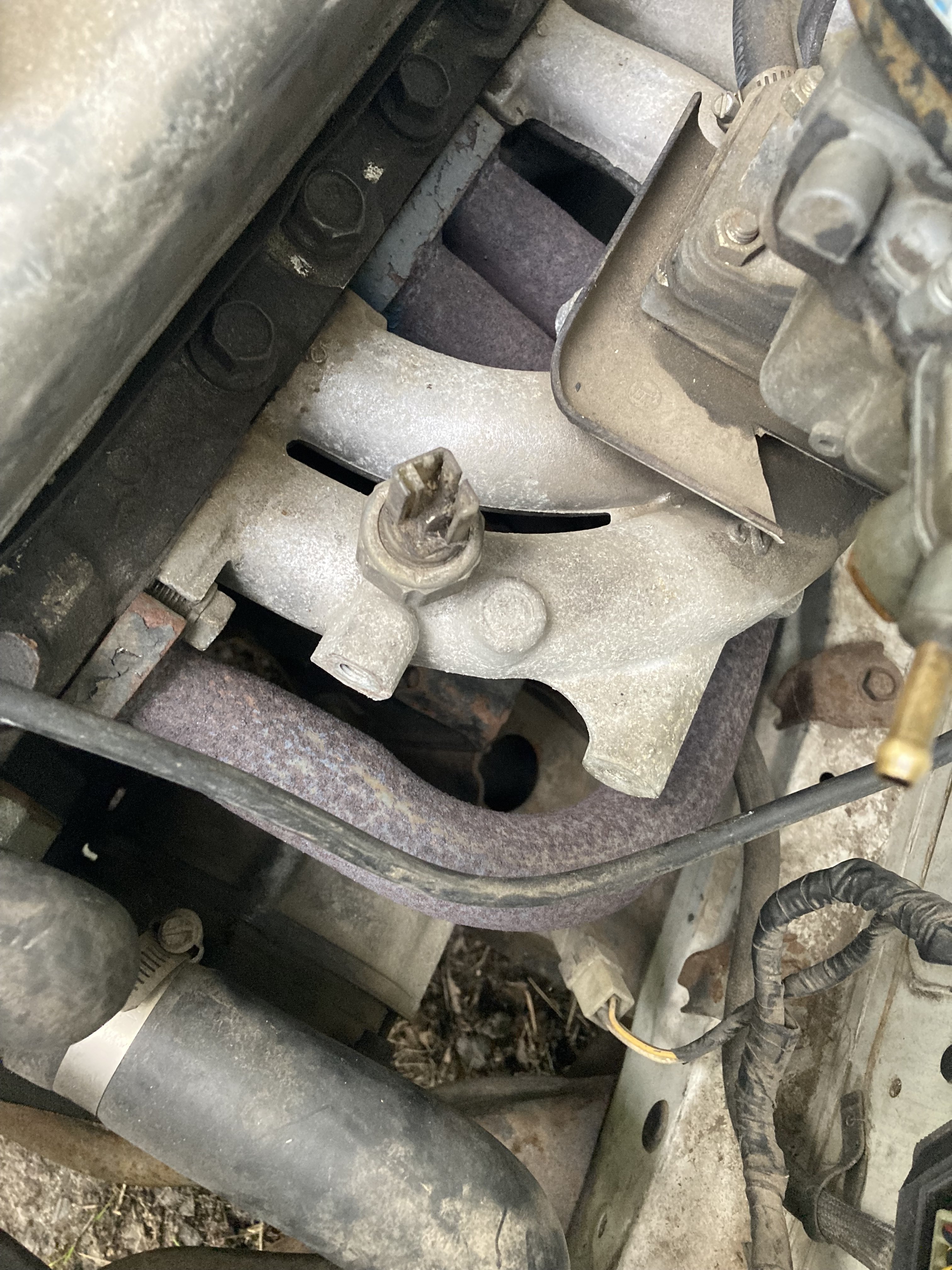

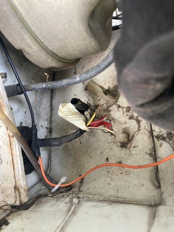

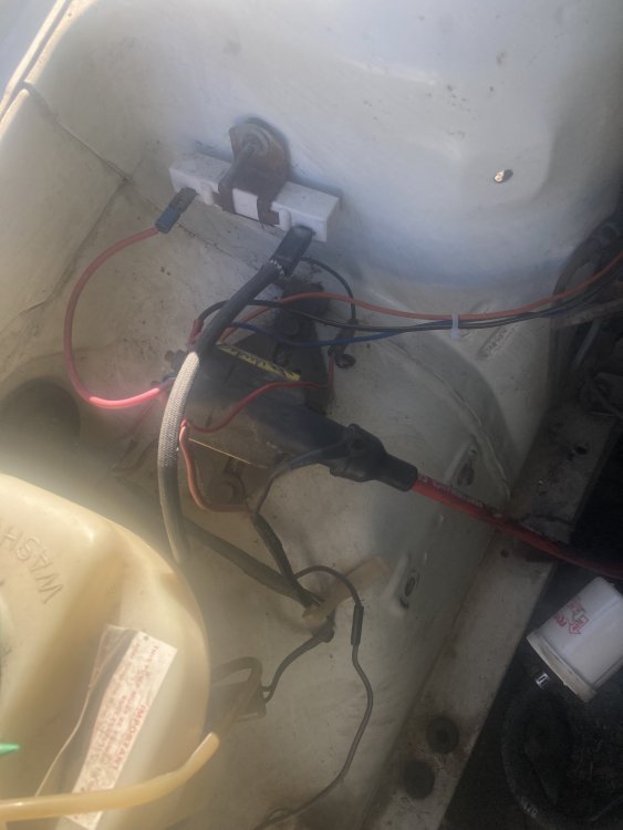

I’ve picked up an 82 ke70 4K and the previous owner has done some dodgy wiring. Looks like the main harness has been cut as well as lots of other dodgy stuff (pictured). When I try to crank the engine about 50% of the time I just get a little click (like when the battery is dead flat) and then the other times it only turns over very slowly (even hooked up to another running ae82) I think it’s something to do with the wiring cos it’s very dodgy and I’m not sure what the wires that have been cut or unplugged previously went. Some help identifying or pics of what the engine bay wiring is meant to look like would be great

That's a 'dry' coil, I've never seen one on a KE70, much too modern.  Obviously it runs with it, and it looks like it is running on the 9V ballast resistor. It won't affect your poor starting anyway. Photos 2 and 3 are stock, the loom in the car did a lot of extra things that Aussie never fitted.
The first photo shows wiring that on my car does the engine loom, oil pressure and water temp, and the red wires are usually lights. The previous guy must have run other circuits if everything on your car works.
