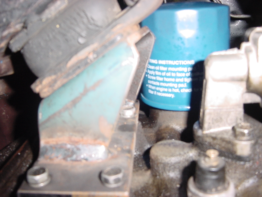

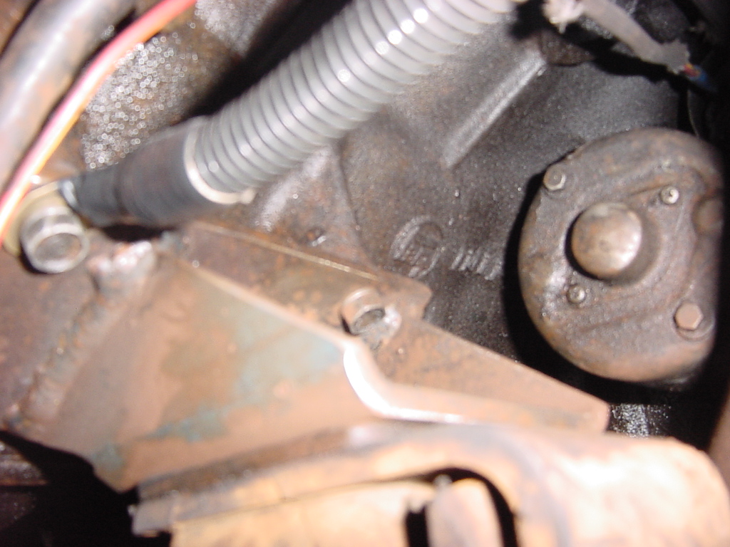

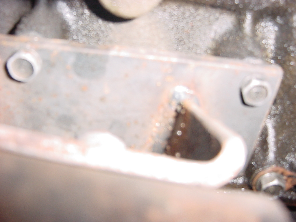

ke30king Posted August 9, 2006 Report Share Posted August 9, 2006 i made custom engine mounts... easier than modifying the x-member... Quote Link to comment Share on other sites More sharing options...
styler Posted August 10, 2006 Report Share Posted August 10, 2006 hey how did you do the custom mounts? Quote Link to comment Share on other sites More sharing options...
ke30king Posted August 10, 2006 Report Share Posted August 10, 2006 i will get pics tomorrow if i remember Quote Link to comment Share on other sites More sharing options...
c budge Posted August 12, 2006 Author Report Share Posted August 12, 2006 are u still getting the pics up.. Quote Link to comment Share on other sites More sharing options...
ke30king Posted August 16, 2006 Report Share Posted August 16, 2006 shit sorry forgot all about it... will do it after dinner Quote Link to comment Share on other sites More sharing options...
Ferminator Posted August 16, 2006 Report Share Posted August 16, 2006 Here in the US we also use the hydrolic clutch lever and pump from a mazda rx7 i had it in my Starlet and it worked awsome.... IMO Quote Link to comment Share on other sites More sharing options...
ke30king Posted August 17, 2006 Report Share Posted August 17, 2006 sorry abou the shitness but the photos are as good as i could get Quote Link to comment Share on other sites More sharing options...
