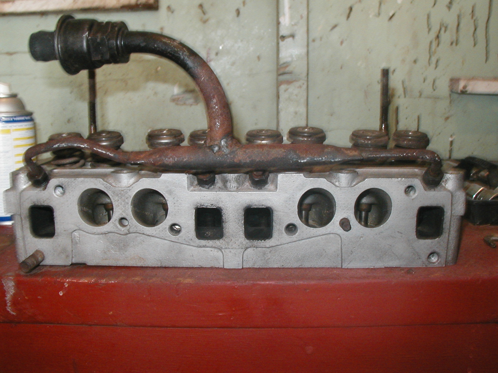

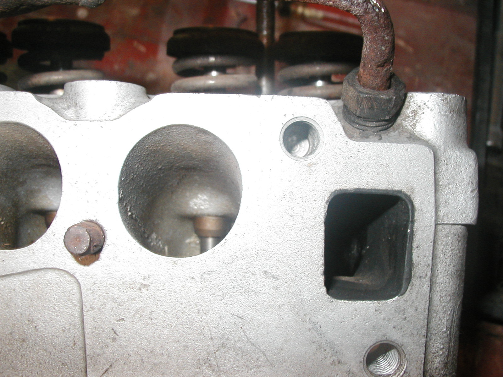

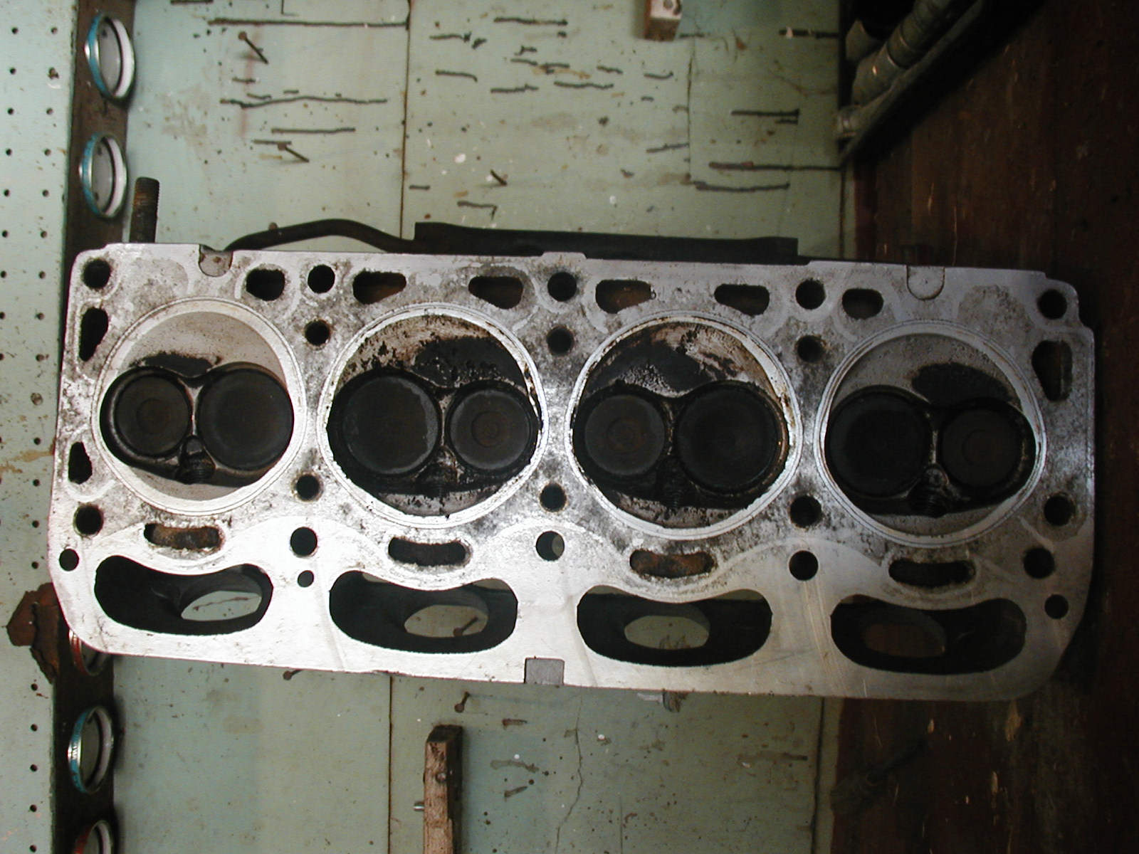

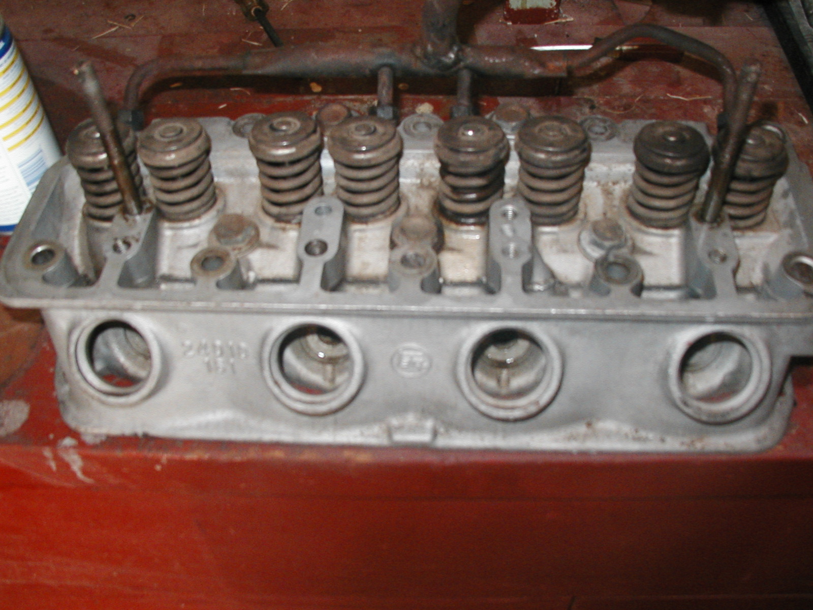

mikeys toy[RL] Posted September 5, 2006 Report Posted September 5, 2006 all of ours here were bigports until like '75 i have a totally rebuilt 3kc bigport head, i couldn't use it because with flattop pistons i had around 250lbs of compression with dished pistons, you should be able to run it ok f.s. if you're interested, i ran this less than 1,000 mi after paying $250 usd to have it done Quote
