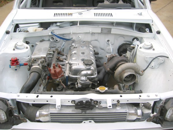

wicked another t-18 hell yeh, there are lots of things that can be done with these beast efi off a 2tgue, turbo, and nos if you wanna be like the boys in the states runnig 7 seconds, good luck with it anyway mate keep us posted
Edited by roids70
thats portaricans not yanks.......and there nos'ed up 3t turbos not 2t's
i didnt say anything about they were using 2t's i know they use 3t's and turbo them but i said you can use the efi off a 2tgue like this
and it is actualy the yanks
www.toyota3tc.com
Edited by roids70
