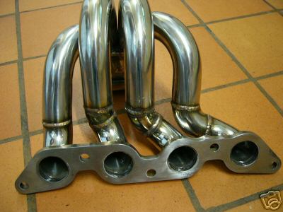

Oh and the big news today is ive paid for my 4AG 20V engine, will be here next wednesday.
Bellhousing turned you monday and i pay for the extractors tomorrow so they should be here early next week too.

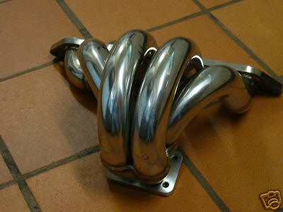

Ill be working torwards turbo it very soon so i got one of these too.
But I'm still not sure what size turbo to run yet. I had my eye on a hybrid t3/t04 but maybe a little too big.Yes i did say extractors earlier, ill be running it while i look for the turbo and other parts.

Damm thats tuff as. did you get that turbo manifold thing hpc coated?
