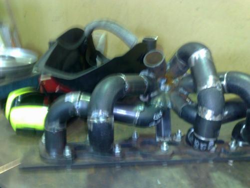

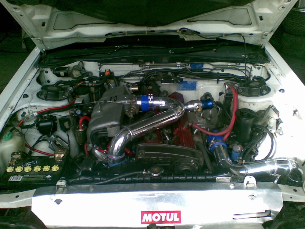

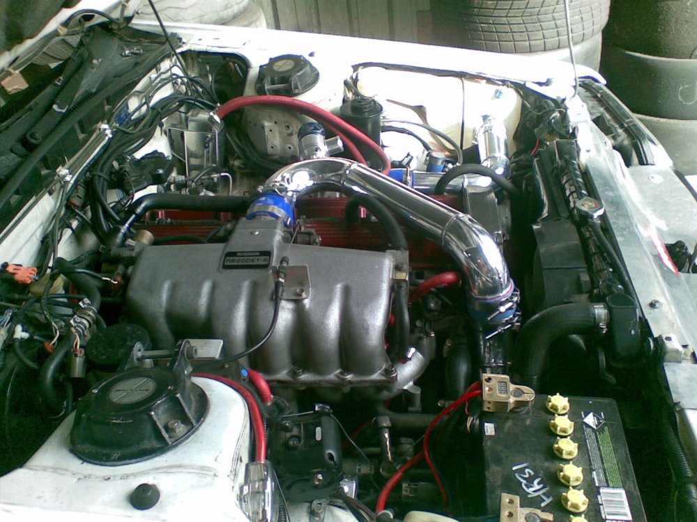

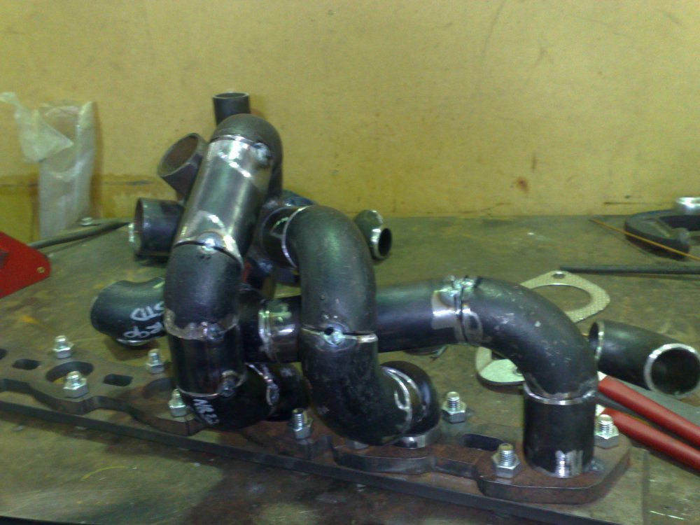

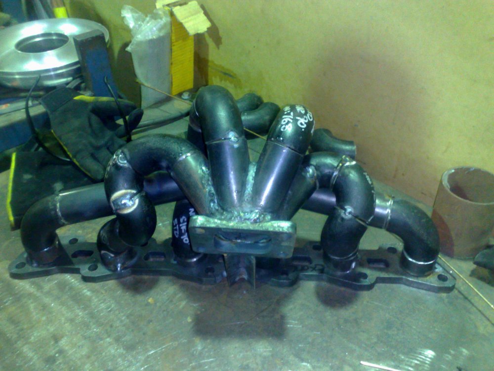

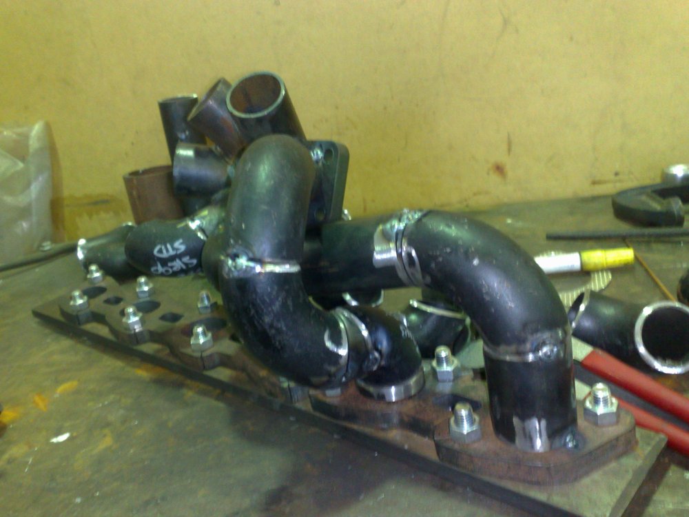

Hey guys, While I was away from the site I went through a lot of changes (including employment), I left road & track (toyota) to go to Signature Performance (nissan) and have been there for 6 months, My role there was to do mechanical repairs but took on the role of fabrication (exhausts, Boost pipes, Manifolds, Body conversions & cages), I am still learning to tig alloy but stainless and steam pipe/steal I am fairly good with so at the moment when I make alloy boost pipes I get the boss to tig them, I have just completed my 1st steam pipe turbo manifold which is going on a RB25, I will leave you with some pics and update when I do something new.

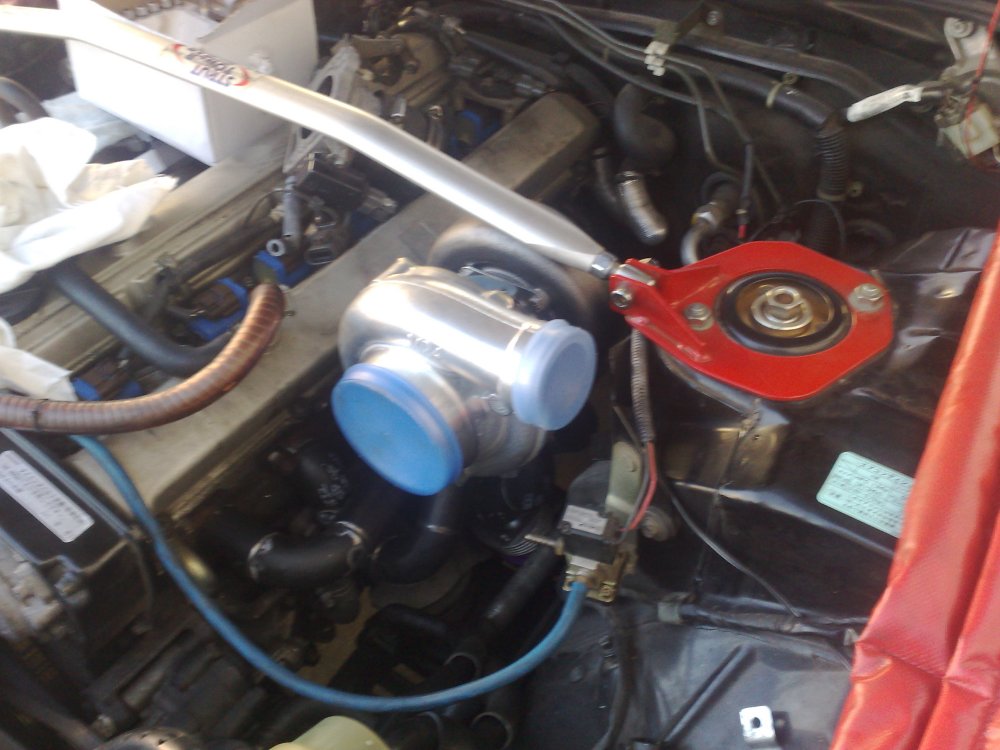

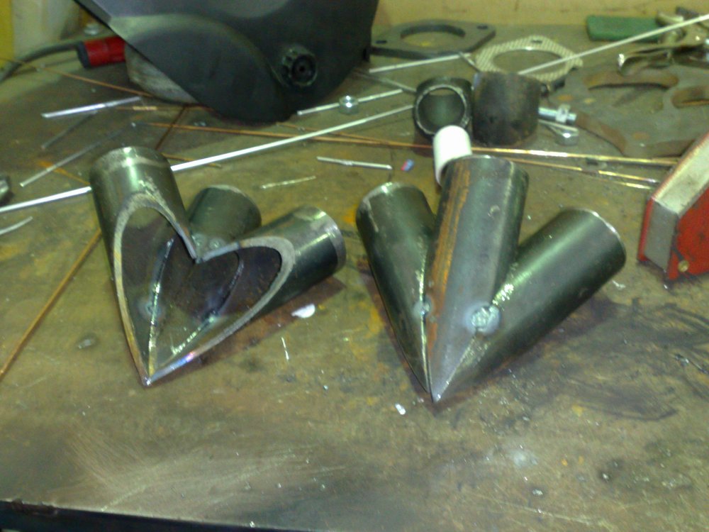

It has been a while since I updated this, I finished the above turbo manifold and other fabrication and put it on the 33 (will take a pic tomorrow if I remember) so it is now all sweet and running but today I started on another manifold so I thought I would get some step to step pics to show you how I make one.

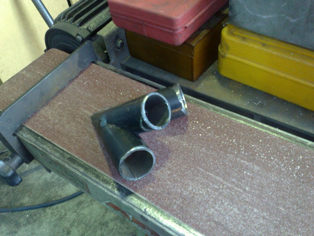

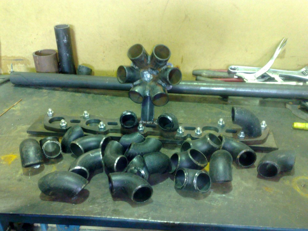

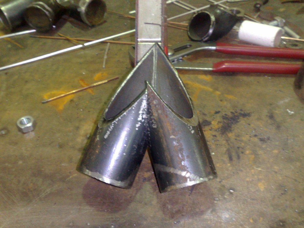

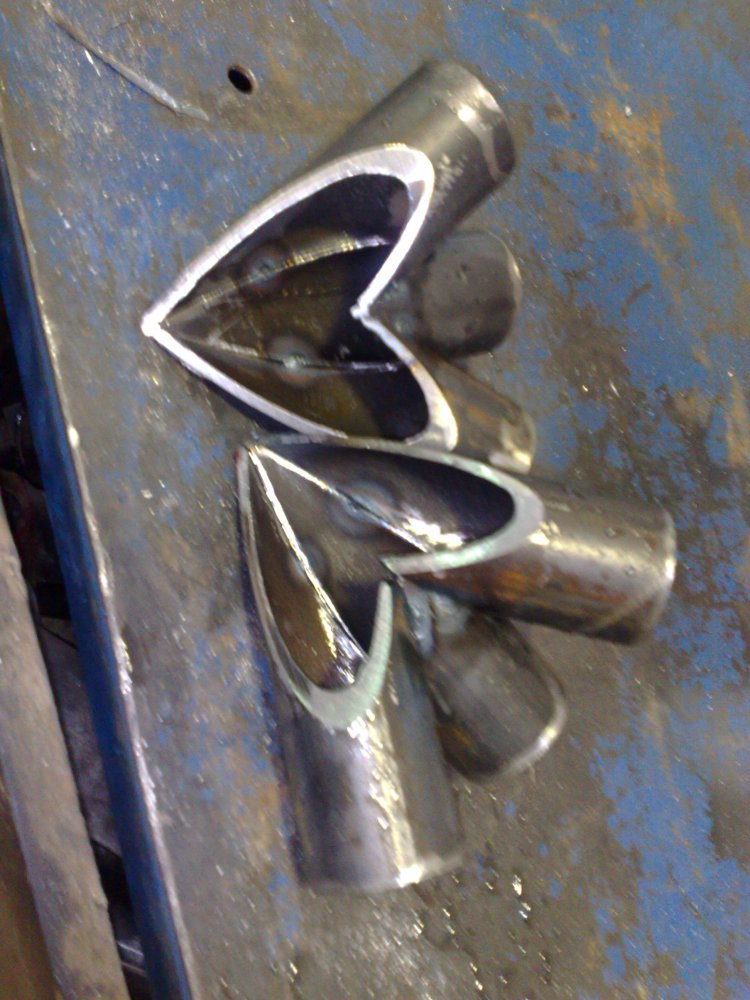

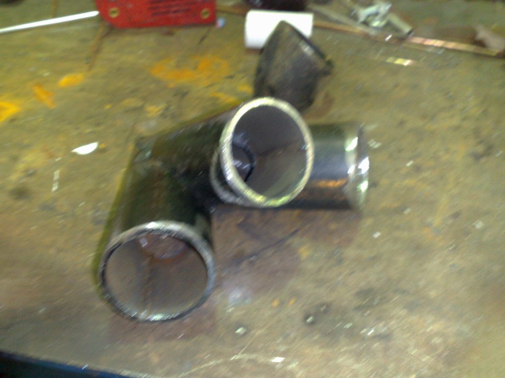

Step 1: Cut 6 bits of tube and cut them at approx 45 degrees (6cyl only) and die grind the sides, This will make the collector.

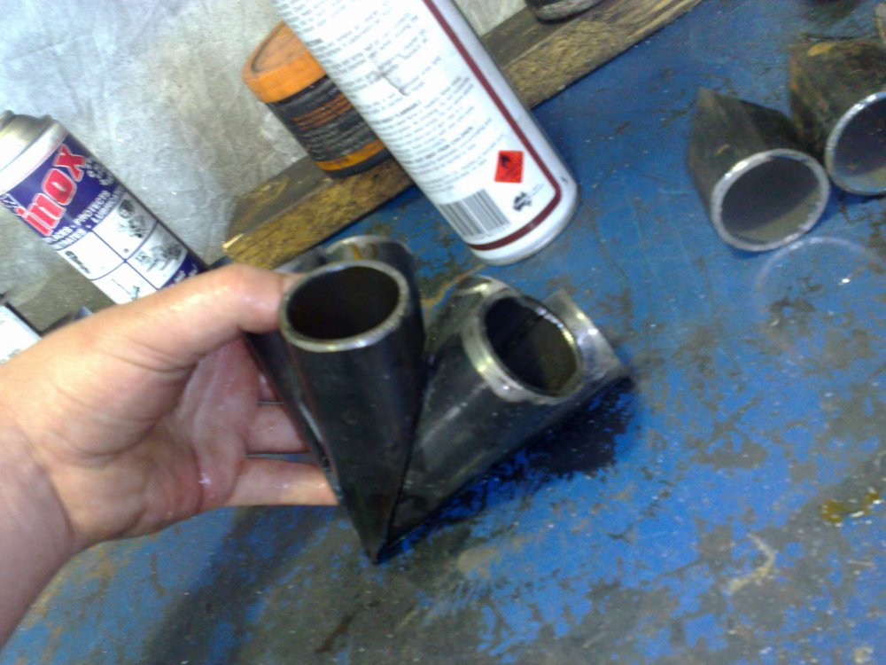

Step 2: Start by welding the collector tubes together in a set of 3 (2 sides of 3).
Step 3: There will now be 2 sides of the collector tac welded.
Step 4: Linish the bottom of the collector halves so they are flat.

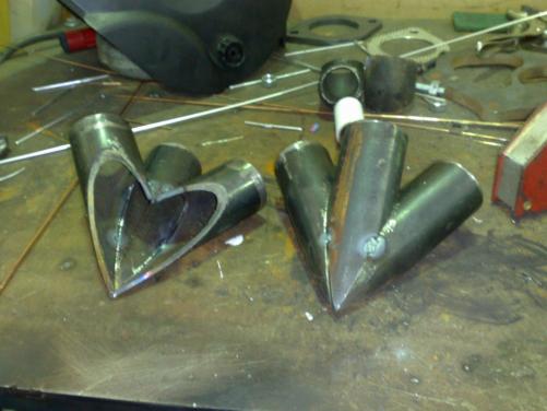

Step 5: Weld the 2 halves fully and then weld them together.

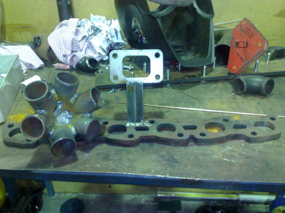

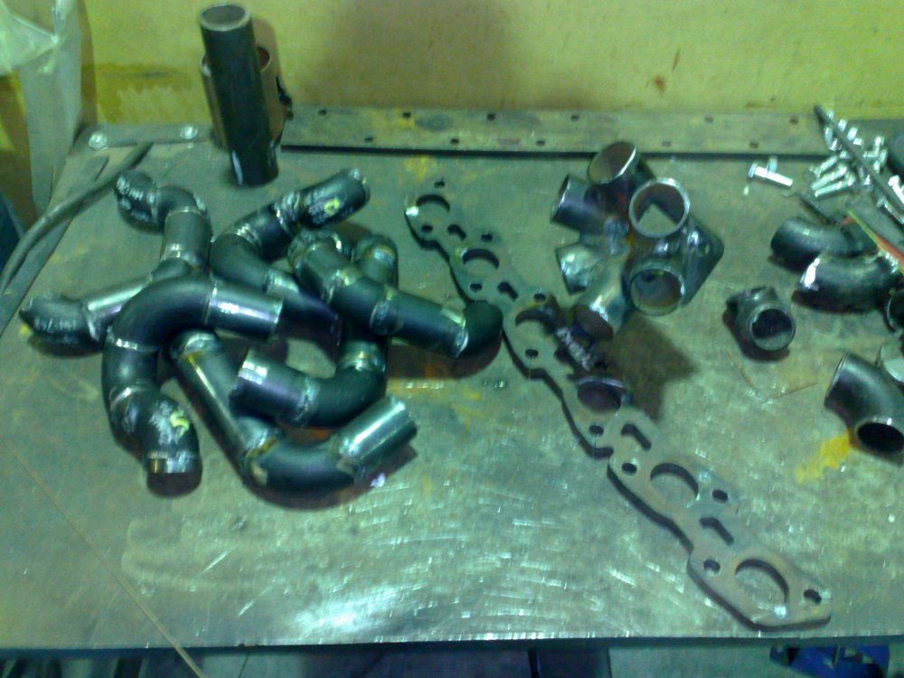

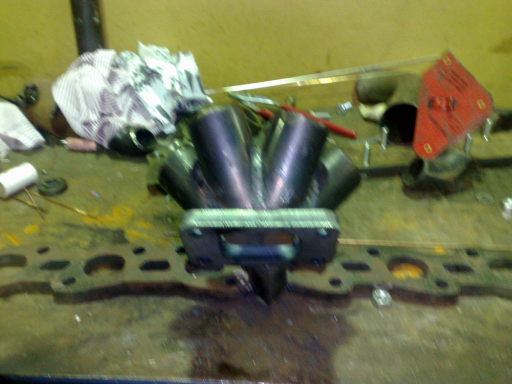

Step 6: Put the head plate on the engine and position the turbo where it is going to go with the turbo plate and weld a brace on.

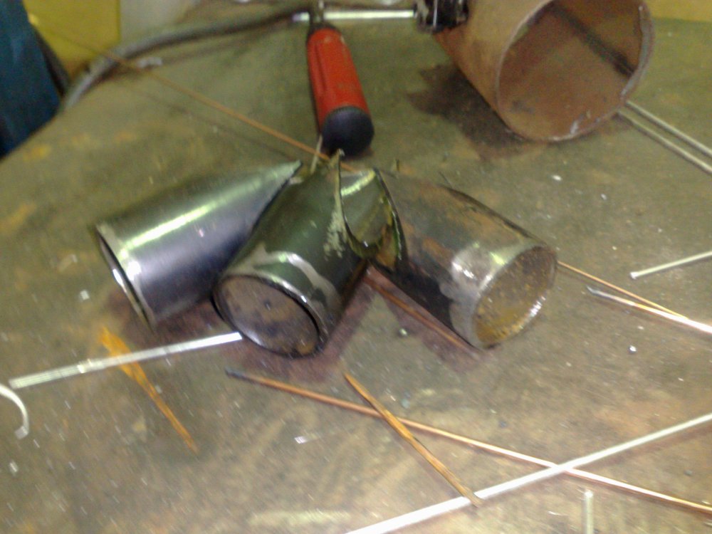

Step 7: Cut the collector to length and flange width.
Step 8: Tac the collector to the turbo flange.
That is as far as I got today but I will continue the steps until it is complete.

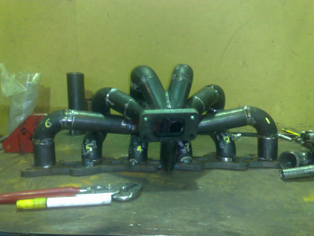

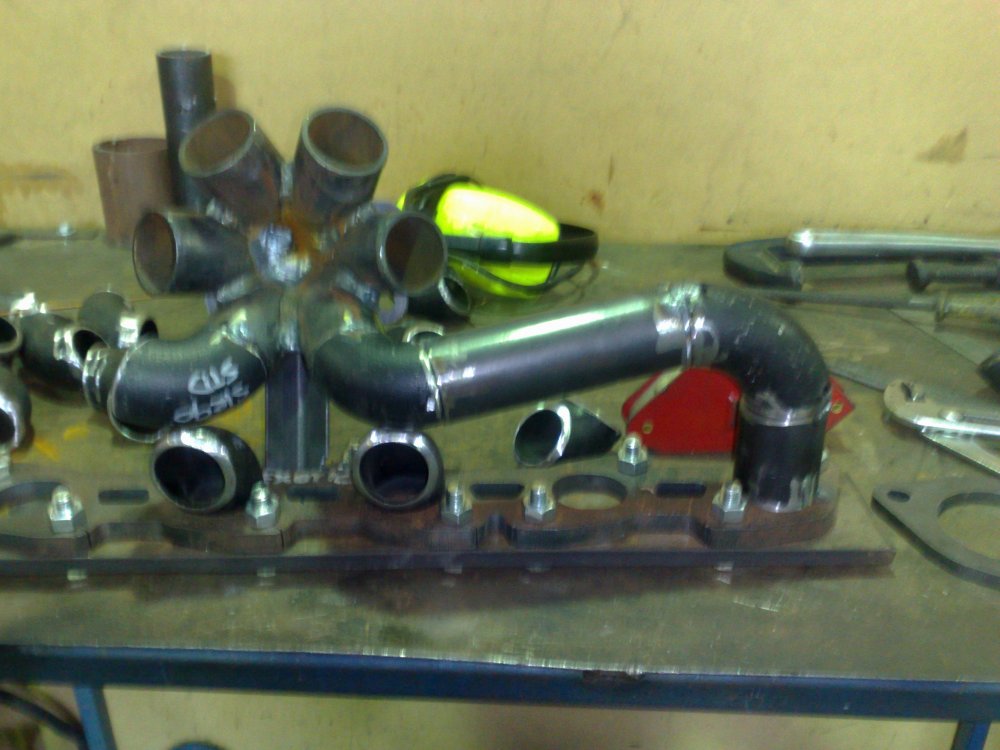

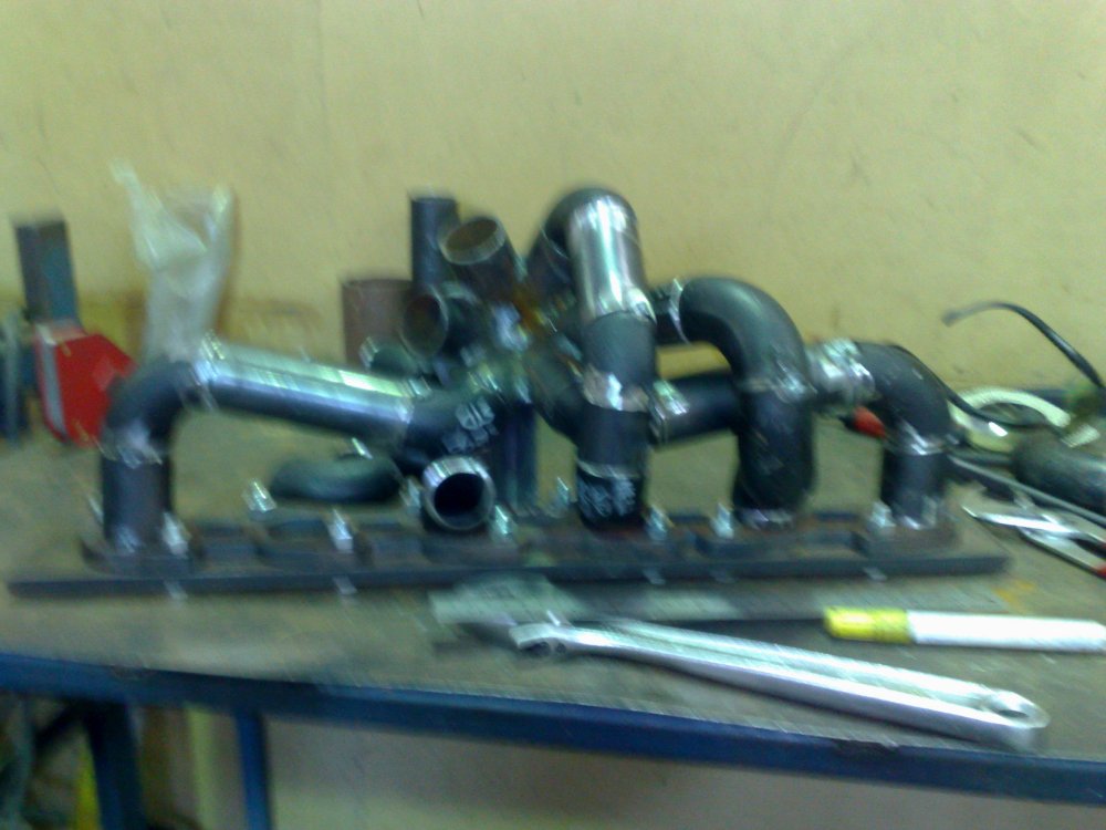

Did more today and now for the fun jig saw puzzle like part...
Step 9: Get various steam pipe bends (tight and wide) as well as some more tube.
Step 10: Start by making an outer runner 1st (tac weld only).
I started with number 6.
Then number 5.
Then number 4.
Now onto number 1.
Then 2.
Finally number 3.

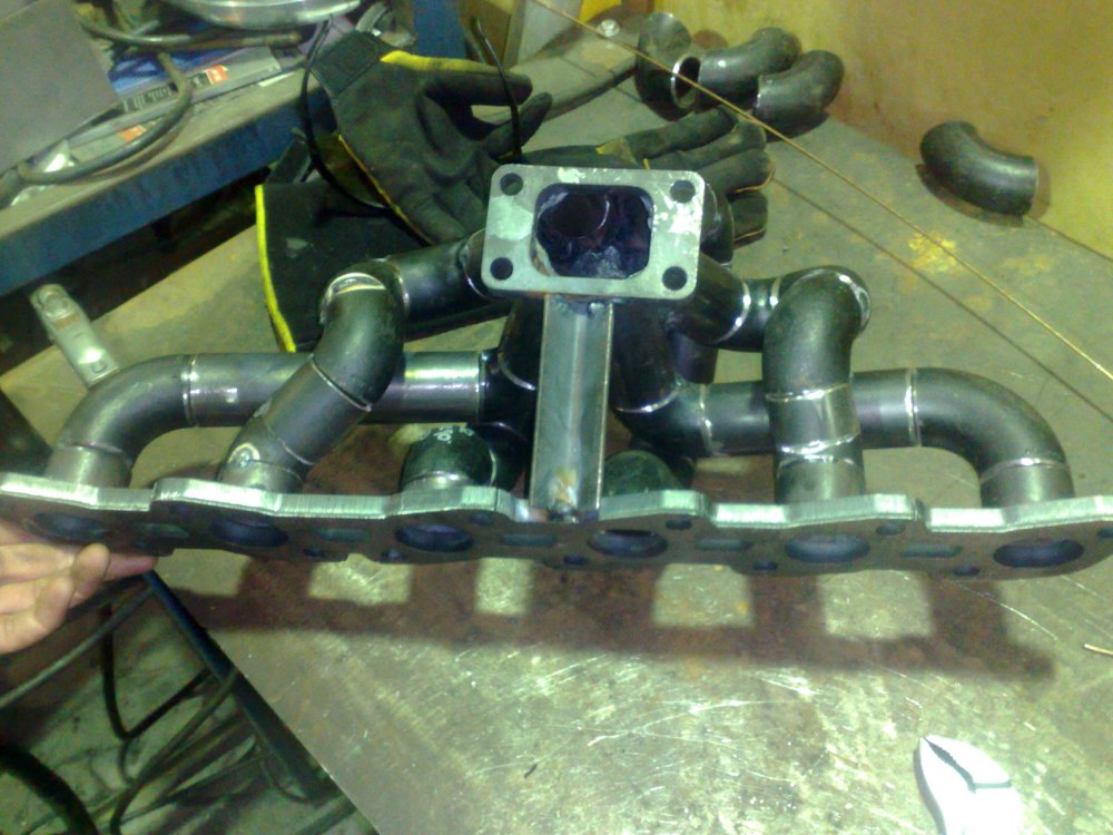

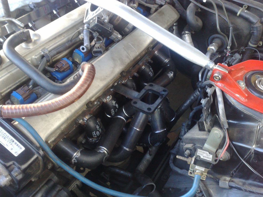

Step 11: Test fitted the manifold so the external gate pipe can be sorted (looks hawt :lolcry:).
Also put the turbo on for photo purposes.

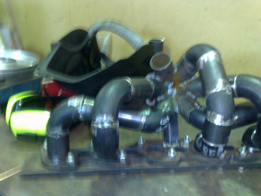

Step 12: Tac weld all joins (apart from the collector and head plate) so they don't move or come apart.
Step 13: Remove the runners so they can be fully welded:
I think I will be finishing it tomorrow pending other work.
