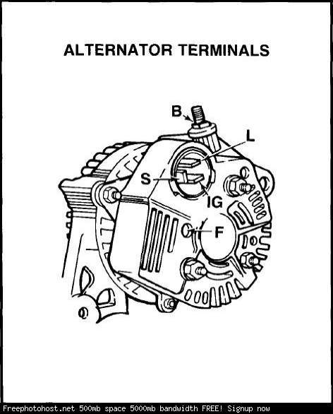

Got a new problem lol the alternator isnt charging enough and i think its because the battery sensor wire from the alternator plug isnt wired to anything i was wondering if any of you know if i can wire S to B as seen below in the diagram as B is the terminal that connects to the battery and S is the sensor wire.... thanks again

Cheers for the help guys alternator is hooked up and working sweet

cheers heaps guys theyre is currently no positive lead running from the starter motor to the alternator pretty sure thats my problem it was decieving though beacause the alternator has the positive lead on top so it looks connected but i checked the starter motor and it was not connected theyre. should i just run a new line from the starter motor to alty and should it be the same thickness wire as what is going to the starter motor from the battery???
