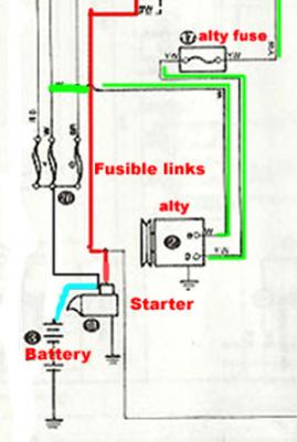

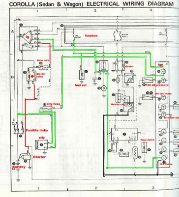

the gearbox to chassis link doesnt need to be that big, i think it will only be there for your reverse lights.
in fact i don't recall there being one from the gearbox to chassis on my ke70.
you just need a chunky wire from the engien block to the chassis for your starter motor, and other electrical stuffs (temp/oil pressure senders)
kinda sucks driving at night and all of a sudden you lose power
I would imagine its an alternator problem and nothing to do with your battery. You should be able to disconnect the battery and run the whole car on the alty, that is what they're for, but don't do it because they don't like the voltage spikes!! However, if you are draining the battery while driving the charging system is faulty.
Once you have checked the earth connections put an ammeter on it or see an auto-sparkie & test the alty. I assume you ahvea full-size +ve lead to the starter?? Don't forget the longer the lead the more the voltage drop.
I hit up a battery shop when I moved the battery to the driver's side and had them make up a +ve cable the right length with terminals crimped on.
That still won't affect anything except the starter motor, that's the only time the battery has to produce full power. The rest of the time the car runs off the alty, and it only needs 25-30amps to run a car at night. So you're not getting much at all from your alty.
