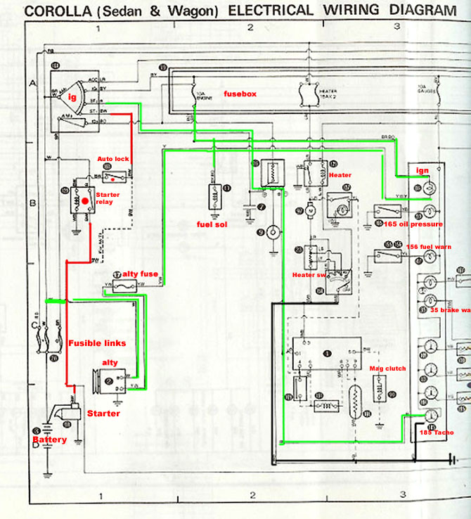

Here's the layout. I coloured it for a slightly different reason, but basically turning the key to "ignition on" loads the green lines, and turning it to "start" loads the red line.
That red line is the low-current wire that goes from the ignition key to the starter motor to activate the solenoid. The heavy current line goes from the battery to the starter and is still in black.
The green lines go through the coil/rev counter & run the motor, and your part goes through the ign light then alty fuse then to the alty to power the windings. Once they are activated the alty produces electricity that feeds into the fusible link to run the electrics generally and charge the battery.
You shouldn't have to touch anything to move the battery except the high-current wires. However if you are losing power like you said then you have a fault in the alty circuit.

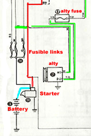

The alty +ve goes off to the fusible link circuit, on mine its part of the fusebox/relay box that sits beside the battery in the stock position. The battery doesn't wire directly to the alty, and the alty only uses a low-current wire as it charges much slower than the battery discharges.
Wire it like this- The battery heavy-current wire is the blue one, it goes from battery +ve straight to the starter. The other wires (fusible link wires) go on the same terminal of the starter, (shown in black). The red one is the solenoid activator that is on the solenoid tab of the starter. Mine fitted perfectly, and while you are under the exhaust manifold in that incredibly cramped place, check the fusible links carefully as they wires burn and break.
