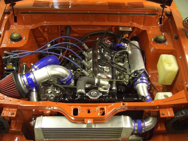

  7. That build ^^^^^ is awesome love the supercharger setup
  8. Wow bro this is going to be awesome really good job keep it going :y: :y: :y: :y:
  9. I will be starting a supercharger setup on my 7k as soon as I move home next month, I already have a most of the parts, sc14, intercooler, blow through carby, pipe work, surge tank and pumps. But what I want to know is what would be the best diameter exhaust, hotdog, muffler ect to run on this setup? (already have extractors) Thanks for your help :y: :y: :y:

  14. I am also doing a similar setup on my 7k in my ke11, I will be running twin blow through carbs with a fixed supercharger pulley running off my gilmer drive pulley kit so there will always be boost. Say if you have your supercharger is setup to run 10psi @ 5000rpm this will mean for every 500rpm there will be 1psi of boost, So in this case at idle there would be no more than 2psi which means the spring in the BOV will have to be really soft to take any unwanted pressure off the throttle butterfly or carby. I'm not sure how this will affect the performance of the BOV at gear change or shutting of the throttle at 5000rpm or higher. Not sure if this has actually answered any of your questions but thats my two cents :y: :y: :y: good luck with it mate.
