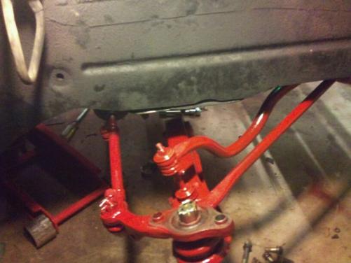

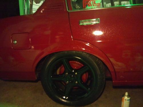

    righto gents, another evening another few hours work put in. firstly got the steering rack bolted in and all set up as per how i wanted it. heres a pic of everything all ready to go... Oh and yes I'm aware both the ball joint and tie rod end have split boots (if you can even see it in the pics), these will both be replaced when i go for wheel alignment, have all these bits plus a new pair of rack boots but no splitter and no press to do this stuff at home. May even go a full remanufactured control arm yet, see if my supplier has a listing for corona. Ok and after all of that i lifted up the back end, fitted the handbrake cables, cleaned/serviced and set the tension on the rear brakes then painted the drums and fitted up the new wheels. Sorry guys as per previous posts I'm no longer interested in crazy pumped guards and huge dish, i have a another car with all of that happening (not that ive touched the dx in weeks lol) as it is these wheels sit nice in the stock guards, show off my nice brakes/front end and more importantly fit over them! You can kind of see the metal flake in this shot too! pictures just don't do this poor cars paint justice!
