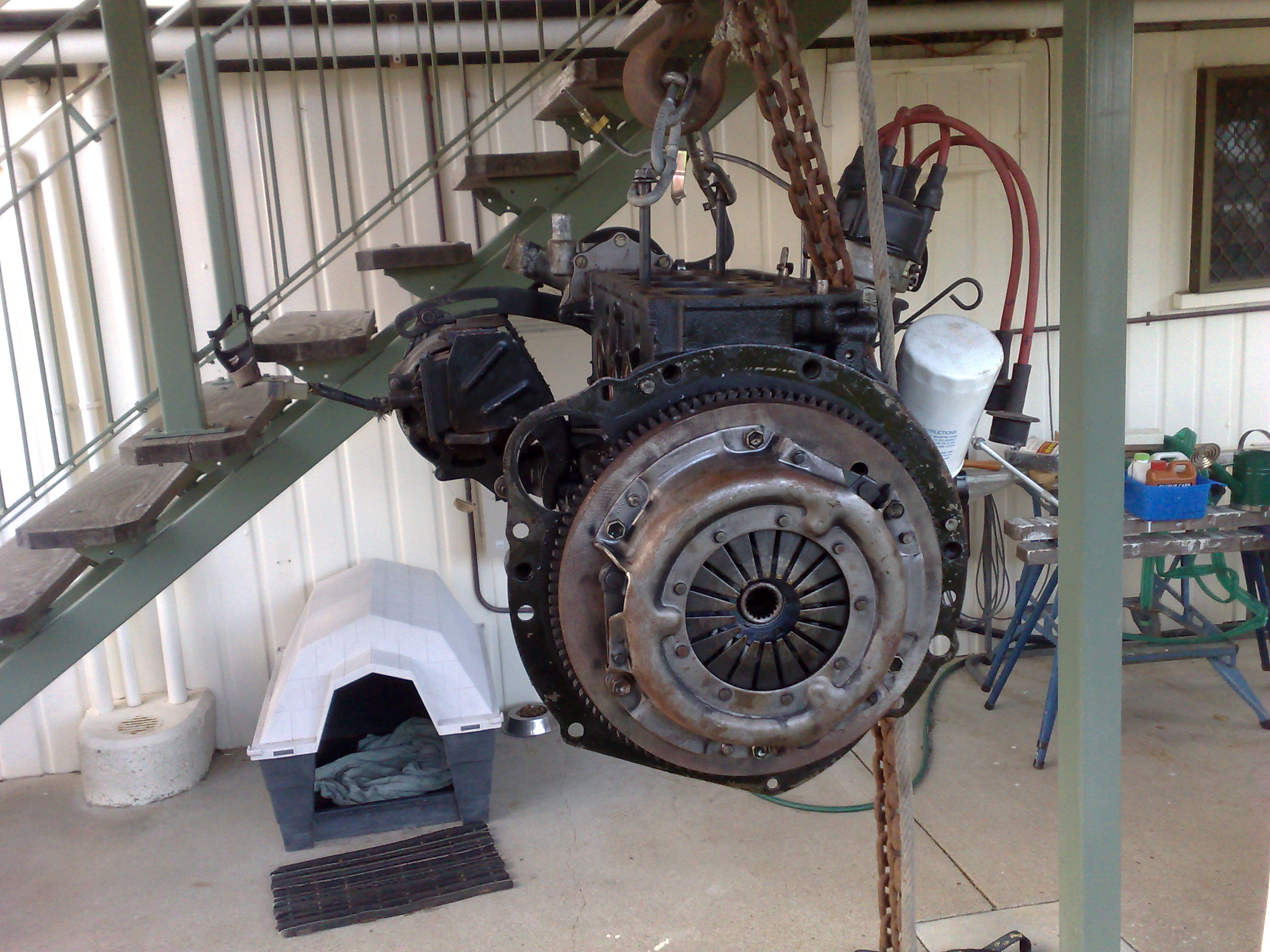

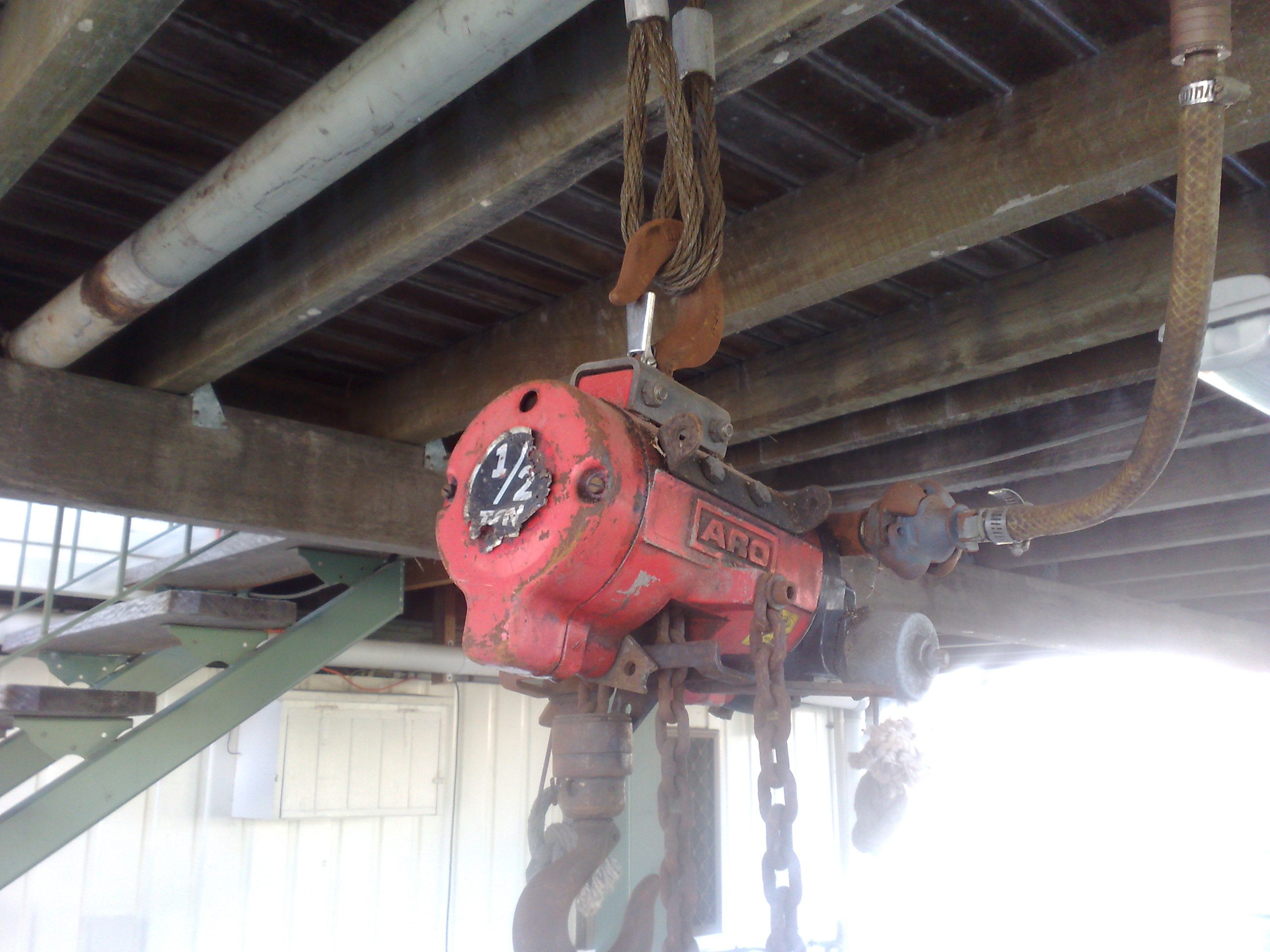

righto then more was done yesterday arvo.. here it is with everything else disconnected ready to liftizze out and heeerrrreee say hello to my little friend, thats a air operated block and tackle, fark man made things so easy haha.

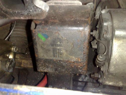

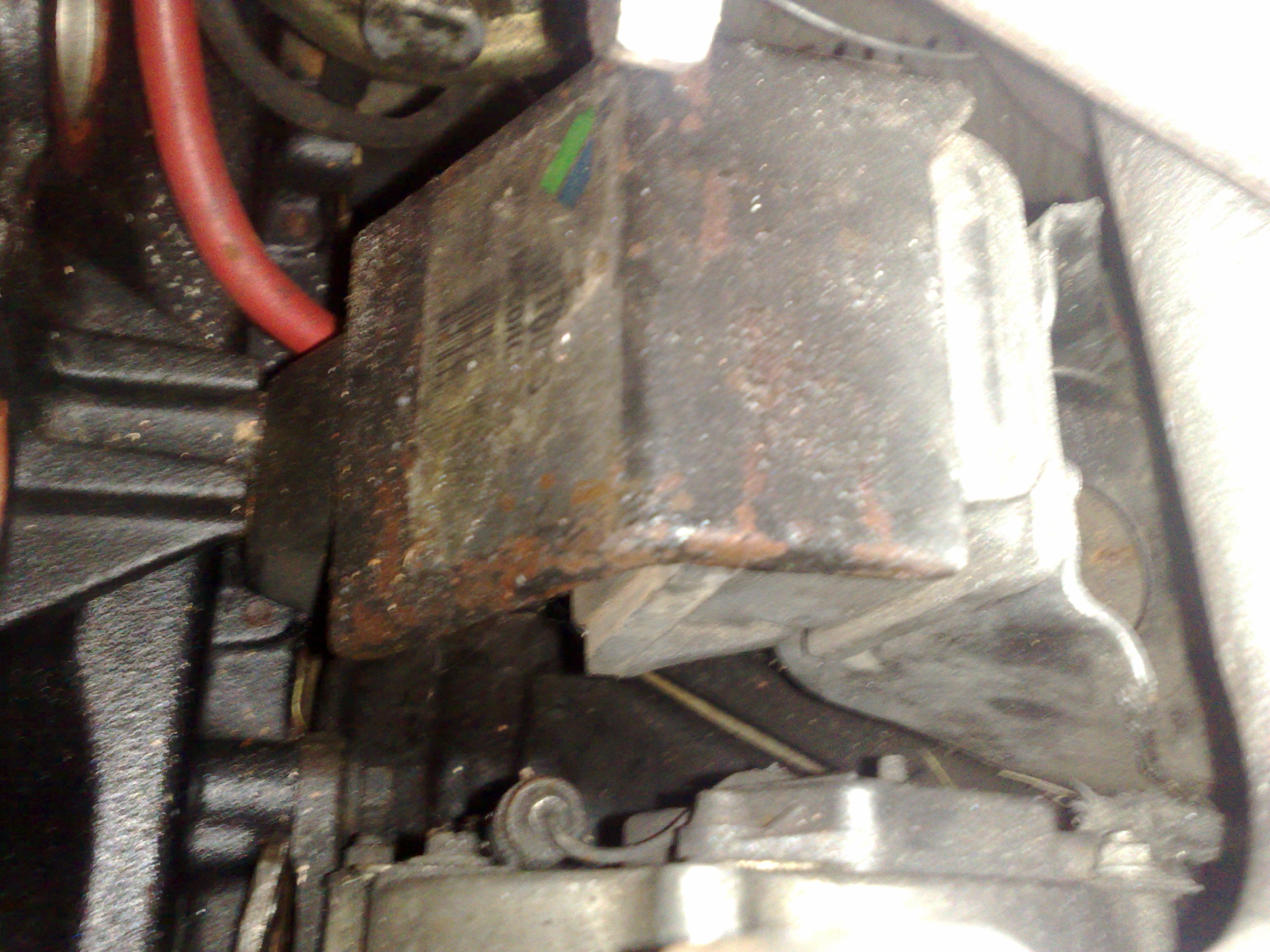

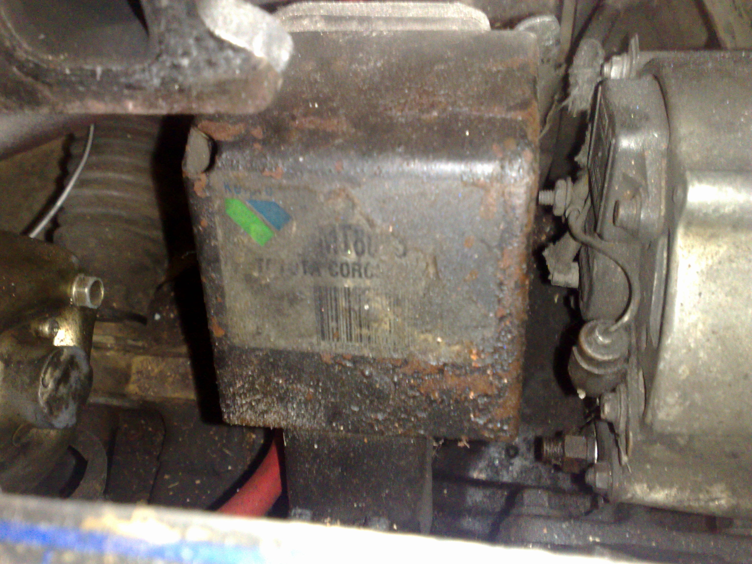

sorry the sticker with the part number is only half there.... but here the pics anyways... there ya go :P

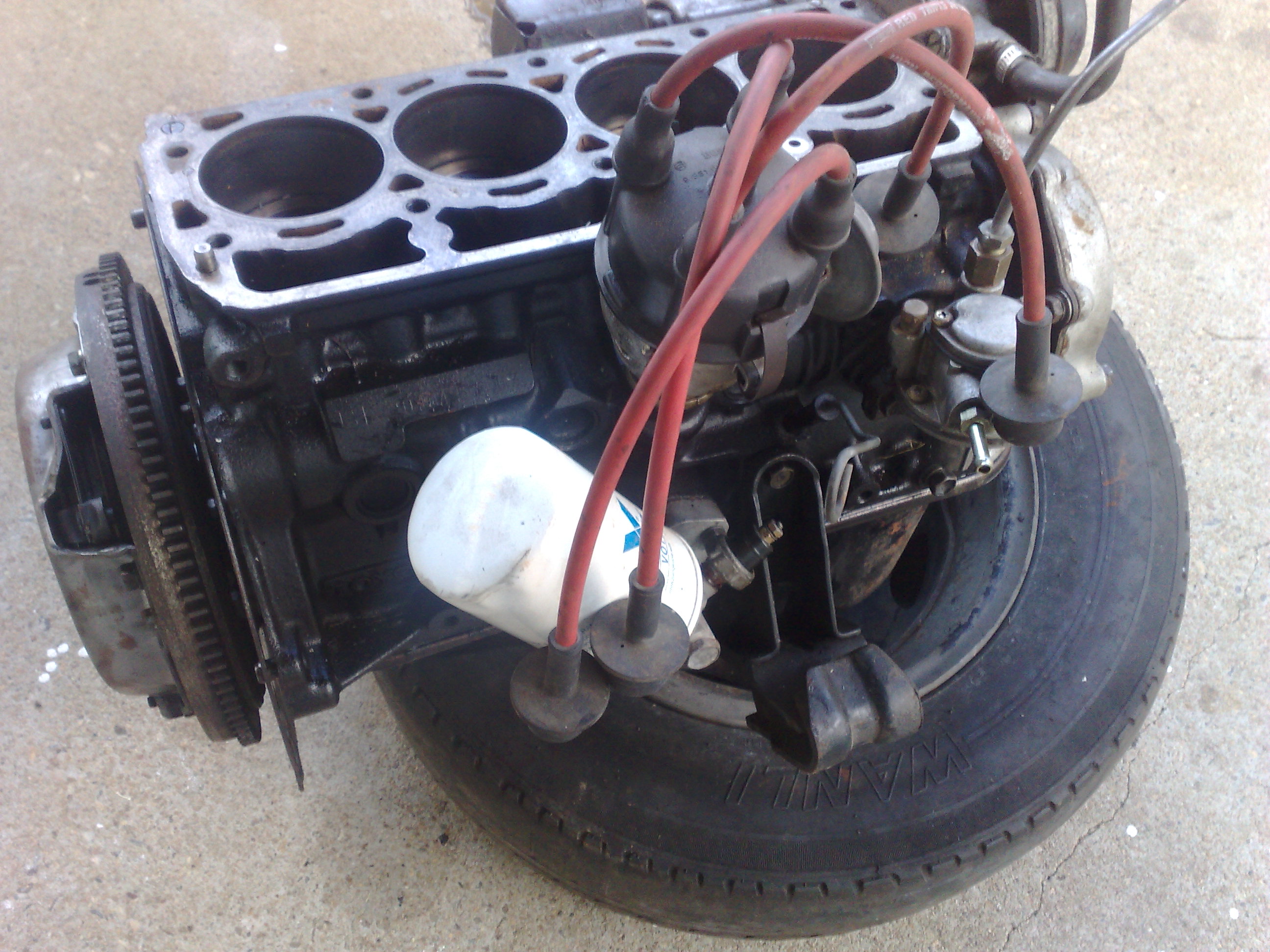

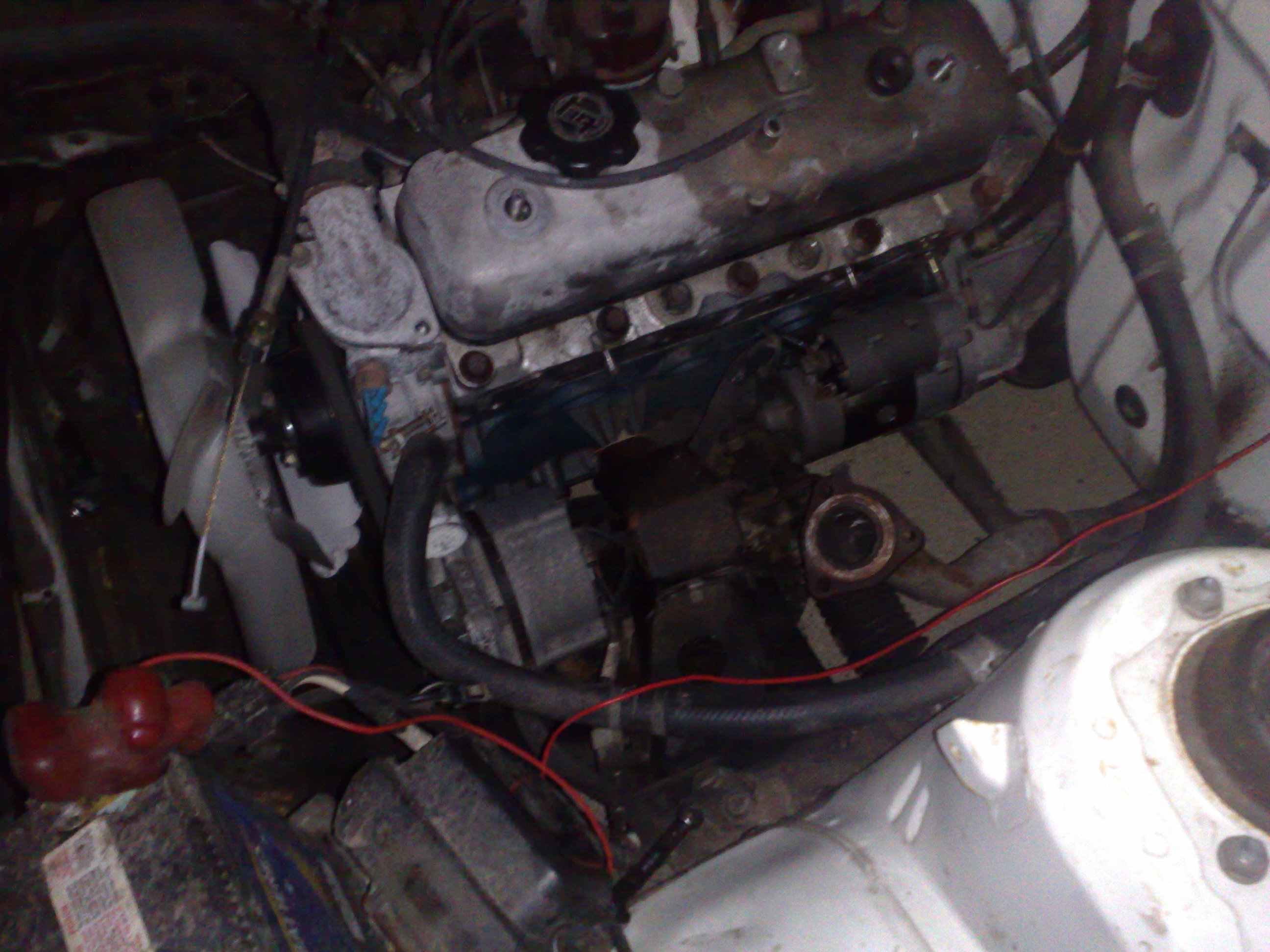

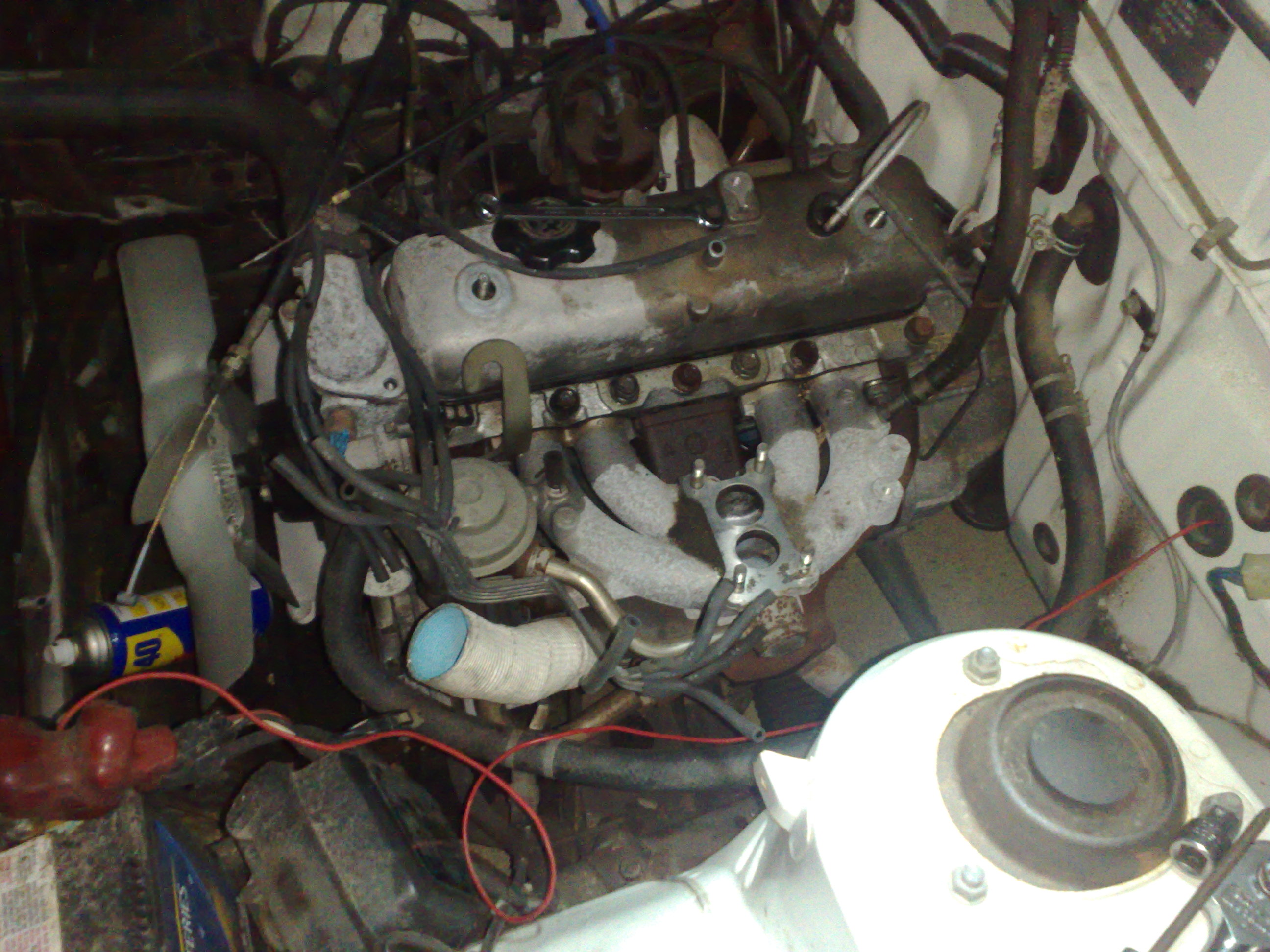

righto then, started stripping the manifolds and other pus off the 4k in the other car cause it looks like I'm going to have to swap it in to get mobile... the 5ks going to take too long to get bits for and I'm going to go all out on it now hey. see my thread in the general mechanical section for that bit) here's the donor motor with the carby off! and here it is with the manifolds off, just gotta get the eleecy bits off tomorrow and bellhousing and torque converter woo

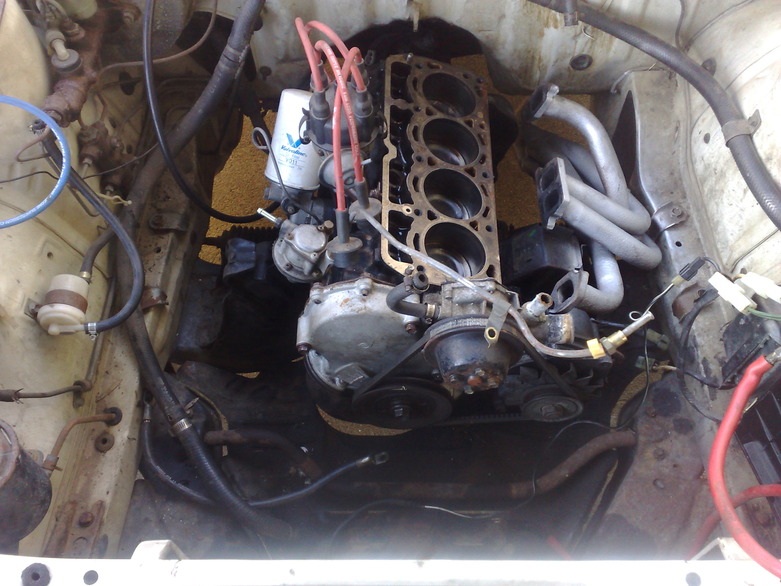

got covered in oil pretty fast so the idea of handling my camera (a 1000 dollar nokia N95 8 gig) didnt really appeal to me... but imagine similar photos to last time i took the head off, only minus the bloody lifters, tho that bit was like childs play with the lifter removal tool...

well ive just come back home from repco... new lifters on the way at 3.80 each I'm doing the lot. about to go pull the head off and remove them, got the tool i need from a mate of grandads :y: will post up pics of the epic fixorness :D

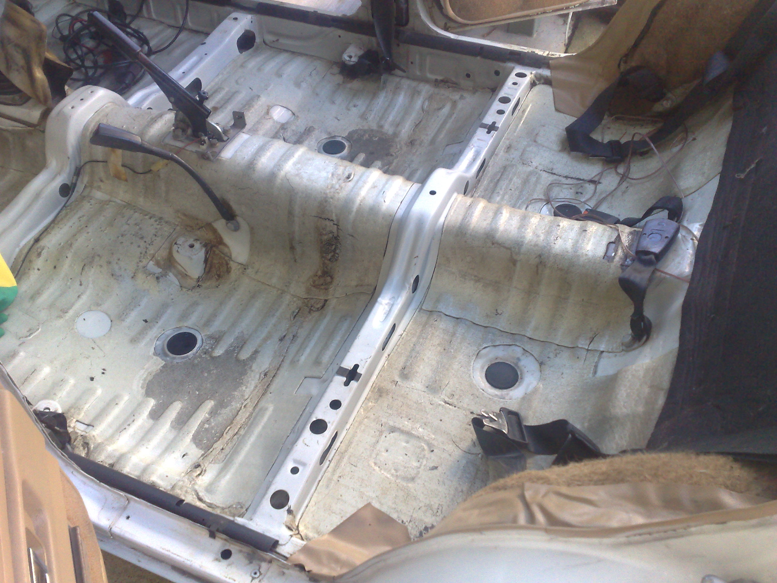

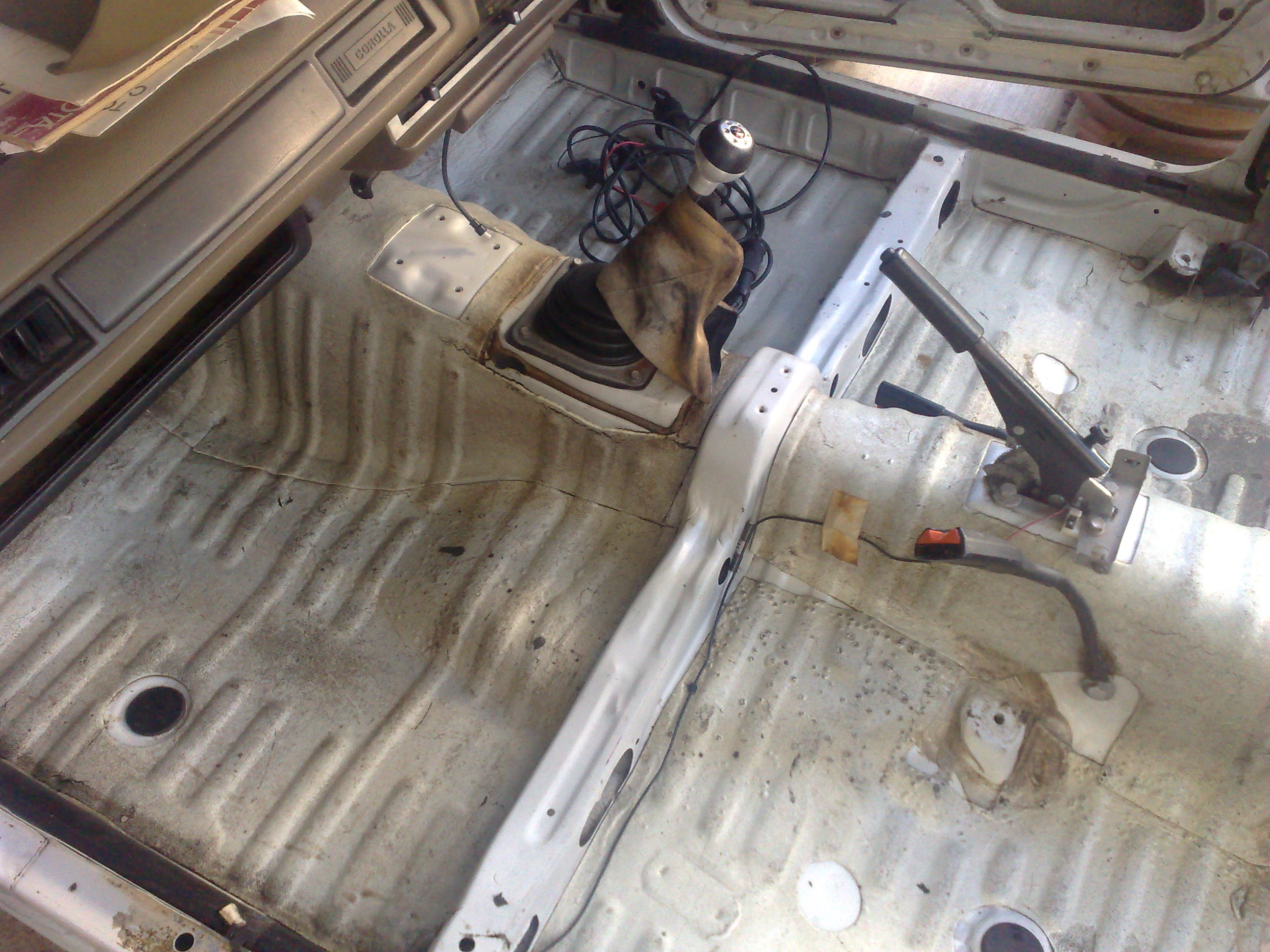

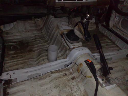

well now i've cleaned out the floorpan so well you could probably eat from it :P now to start transferring the interior over :cool:

umm i have a ke70 with a 5k... will that do? going to work on its shit now... will take a piccie for ya :cool: i think it has the part number still on it too :2thumbs:

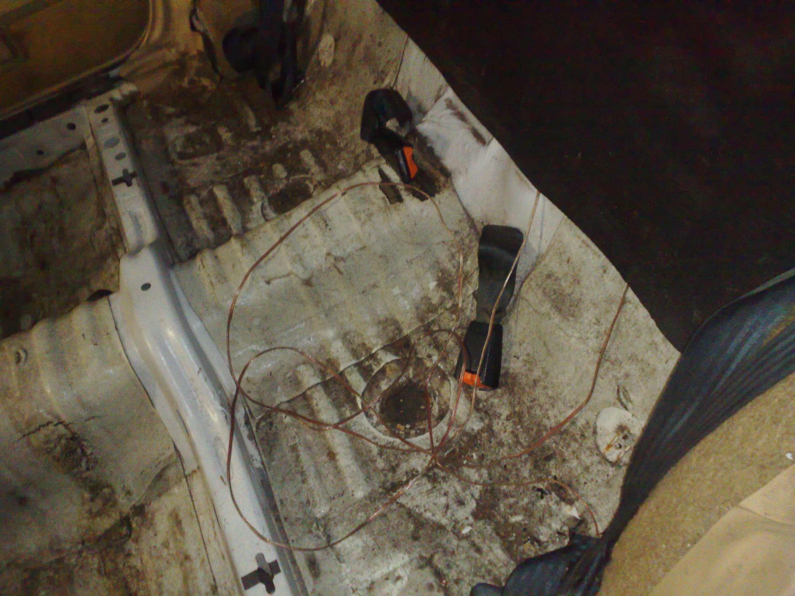

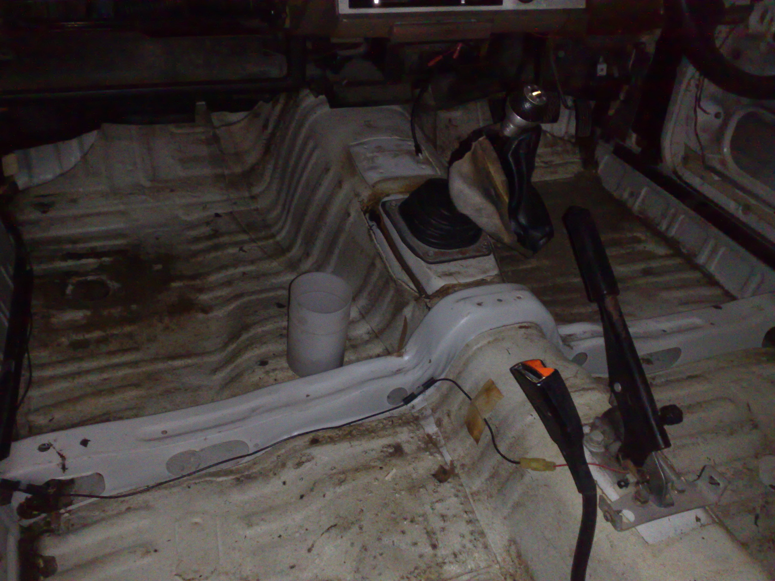

two more pics, the interior is now stripped ready for the bits from the nice one! the rear bit and front floor will post again when its all vacuumed and clean! does anyone know where i can get two Very good condition door handles? (from the inside, the bits you use to pull the door shut) the only bits neither car has, will kind of let it down having such a overrated interior and no bloody handles lol.
