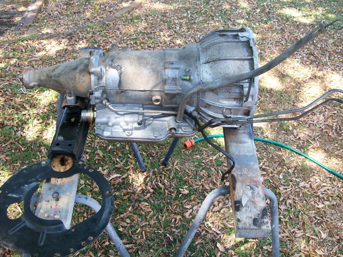

  2. Road Trip done, A big thankyou to Bruce for all his help with the Trimatic i bought from him...top bloke. Had nice hassle free drive from strathpine to maryborough and will get crackin this saturday....Again out with the motor/box from the ke38...do the swap over and fingers crossed all is sweet... If so rego n new plates real soon.... Cheers Teza40
  3. All things required to be replaced or fixed......DONE!... TA DA....passed safety inspection this morning :) Now waiting on the word that another trimatic is out of a car,then drive to Maryborough to pick it.....change auto`s...cross fingers tight...then go get new registration n plates... Cheers Terry

  5. For sure matty it aint right.....holds onto first like a hooker that just made her first dollar........i have no idea on service history condition of the box...i did only get to test it up n back Chris`s driveway at the time... Havent as yet pulled the pan mate...been too busy doing all the other things the roadie guy said needed replacing..that shit is all done and the trans is the spanner in the works....Yes it has vaccuum tho i do wonder if it is strong enough to pull the diaphram fully open. There are two wires the exit the right side of the box near the middle but on flat surface above pan....have no idea if they are for neutral safety swithc etc....but i have the safety switch all working in anycase... Has got me stuffed...but i reckon personally it is stuffed...rebuild...worth it ?????? maybe not... Thanks for your help Matty
  6. Hey Matty..... symptoms are...can take of steady and dosen`t seem to want to change up,give it a boot full and it takes of ok (strong under load), back off and settle it down it feels slushy/doughey as it trys to change into possibly 2nd....so once up too speed as such it gets real vague/lazy,possibly slipping feel.....then have to give it more to keep it moving... Cheers Terry
  7. Hi all.....well hooked up the vaccuum for the kickdown to the inlet manifold...took the van for a drive this morning up the street, seems like hasnt made much of a difference to the upshift 1 2 3 automatically in the box... Took the vaccuum modulator/diaphram off the back of the box,it is pulling in on suction and releasing.So this tells me that with vaccuum it should be doing it`s job...yes i have vaccuum at the modulator end of the line.... So who on here is the automatic specialist??......any assistance would be much appreciated.....this box is untried n tested but i believed it to be sound enough...so not sure if there is other problems that occur,as this is the very first vaccuum kickdown box i have messed with...all other have been cable or bar kick down I.E. chrysler borg warner 35 or chrysler 727 auto`s........long many long years ago... Regards Terry
  8. Well the ke38 finally went for a safety inspection today.....no go for rego at this stage.. Have found out, disc rotors are undersize,left seat belt frayed to badly,idler arm and pitman arm worn,rear gearbox mount needs replacing along with shackle bushes in leaf springs. Indicators not self cancelling out An oil leak somewhere (pretty sure from oil filter),speedo for some reason wasnt working also.... Along with needing to drill an tap a fitting into the inlet manifold for vaccuum to the auto kick down module/diaphram...they sure don't shift gears these traumatics (GMH trimatic) without it... So in all,not ready yet for the road..but considering none of those items got my attention due to time and dollar factor.....I'm happy that they are the only things stopping it from rego...they are after all mainly safety items... Cheers Teza
