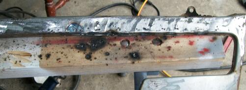

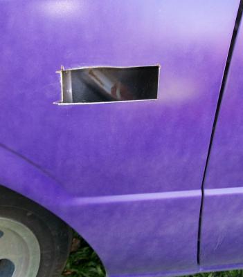

  1. Ok so a bit more work on this little customisation of the tailgate over the last couple of days,made up the inner panel that will hold the rego plate. Well hell yes its starting to look like something and very cool. Just need to fully weld it to the tailgate now ,hopefully slowly and with minimal warpage/heat.Then skim it all over with bog and sand back to smooth with the correct shape etc.. Enjoy the pics cheers Terry

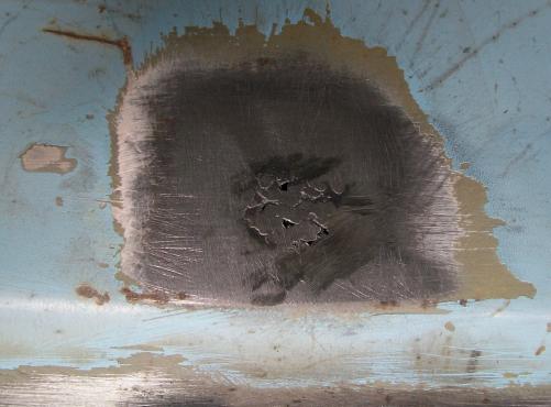

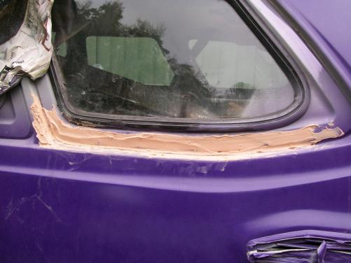

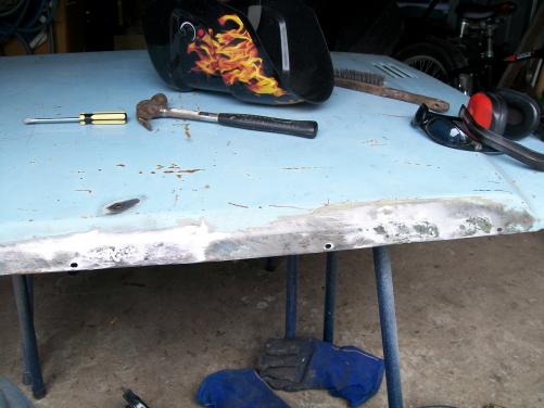

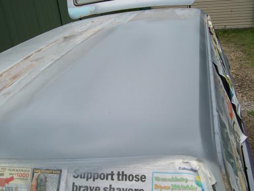

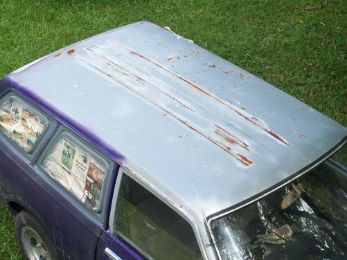

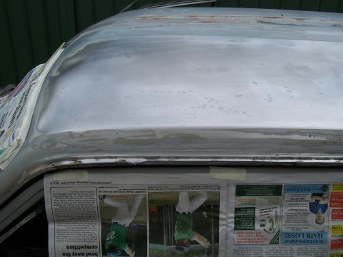

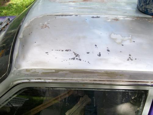

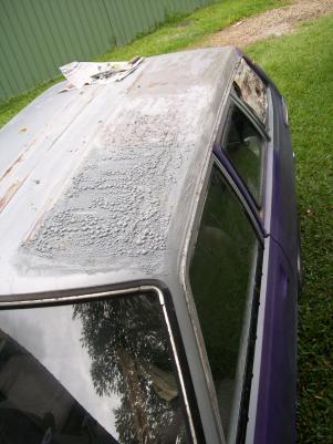

  5. Ok with so many things needing doing and not lots of dollars to throw at it at moment (going on lil trip) decided to sort n fix some stuff i have worked already..seems like go over a few times to get right..but thats cars.. Also started on the roof..now this is a big job due to the fact of the surface rust imbedded in areas in the metal.. Will clean up ok in the end tho,just lots of work. Cheers Teza reworked this area due to deep scratches in the paint..somewhat fussy..is me Back to bare metal and offending surface rust spot

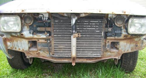

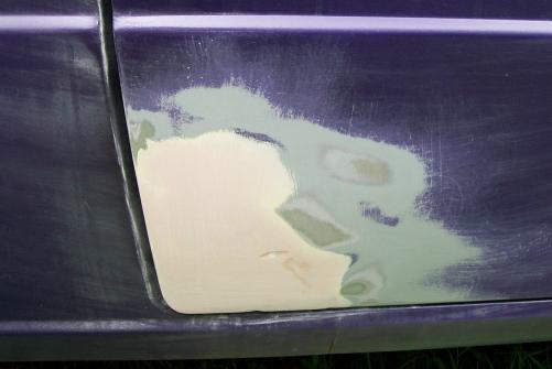

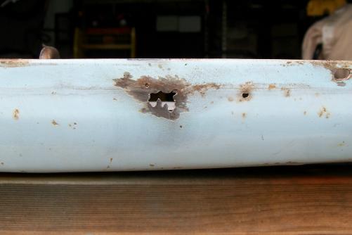

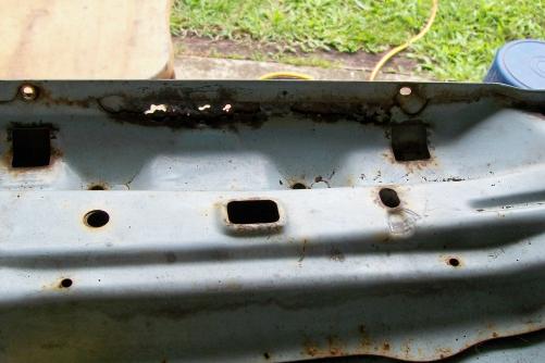

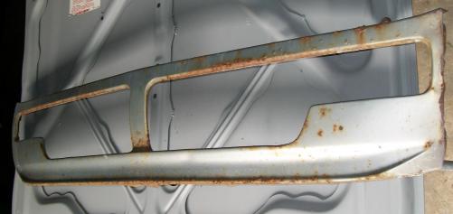

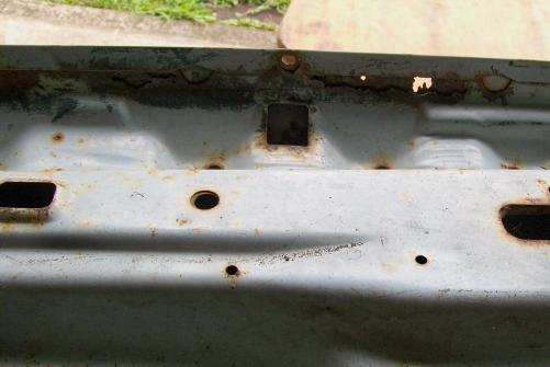

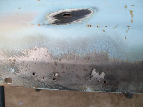

  6. Ok so got back out there thursday arvo for a few hours,decided to take the front apron off.Now i new it was rusty but far out.. So have the metal version of swiss cheese to repair,yep weld the holes up etc..Will also make the radiator panel all pretty too don't worry.. Hada chance to sand back the lower door repairs also while i was messin about,before the rain came again.. So yep little bits at a time,will get me there eventually.. Cheers Teza40

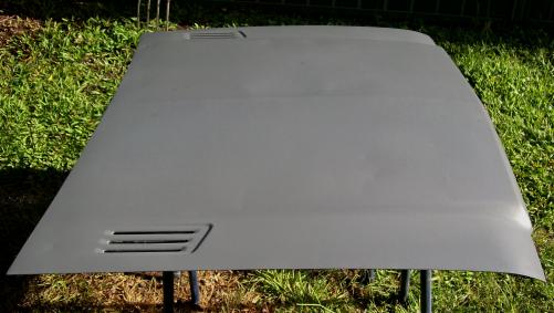

  9. Progress slow this week,Bris vegas weather has been sorta shite again and I'm feeling old (lol). Tho have managed to wet sand back the underside of bonnet and give light coat of primer,bonnet will need some topside bog work to sort out some low spots. Not overly fussed as the areas the lows are in will most likely have the silver paint over them. This is not or never intended to be a show car.. Hopefully the weather improves for the weekend for more serious effort.. Side note: so far outlaid around the $220 mark in materials to get this far.. cheers Teza40

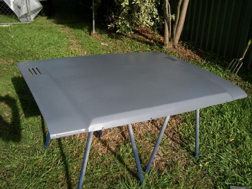

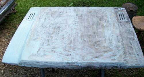

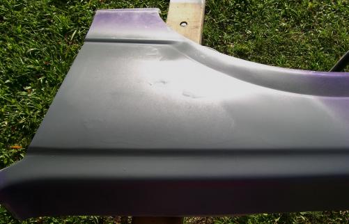

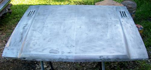

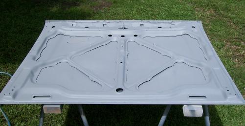

  10. The end of the sunday effort... Stripped the topside of bonnet back to bare metal,is now wearing a heavy coat of etch primer.has got a few low dings n dents etc that i will fix along the way. Also gave the gaurd a coat of etch primer,will do until i get the hi fill primer during the week. Also as a side note...Emma sat for her learners last week and got it first time with only 2 questions wrong..well done darling..now get the confidence for some wheel time.. Cheers Terry

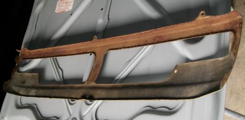

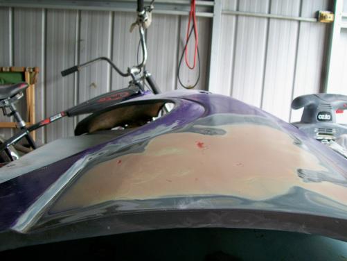

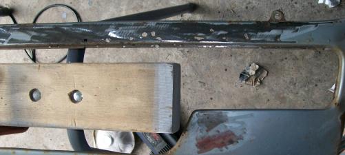

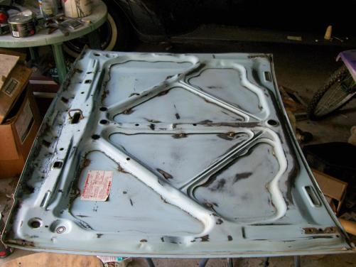

  11. Sunday 6th march...corolla log.. Ok the bonnet i bought a few years ago to replace the original is now sad and rusted on the inside front edge,i have had another laying around for years and have decided to put it to good use. Tho it is in need of some minor work also rust in the front outer and inner edge,(minor compared to the other bonnet)...so that was todays lil effort so far,along with tack weld of the inner and outer skins together as the two had seperated (pics),also the first sand back of the left gaurd,more work to do there..need to get some more hi fill primer (the saviour of all bog repairs)...

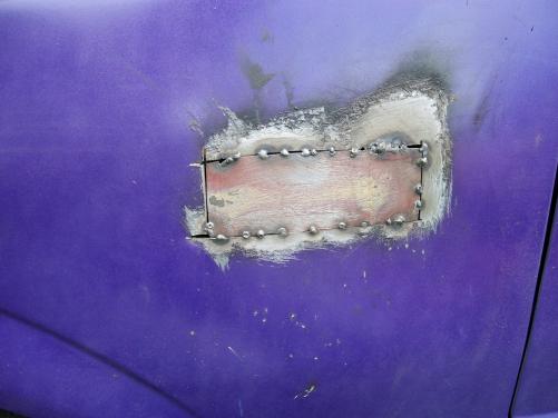

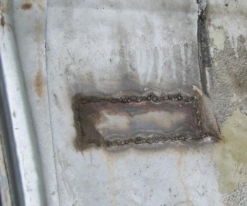

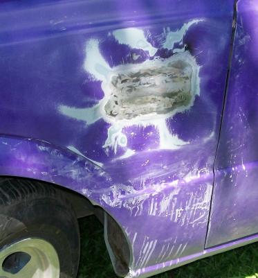

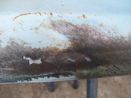

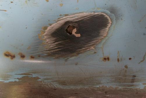

  16. Ok our crap bris vegas weather is back.. Tho managed during the week to do some work (damage) on the left front guard,it had rust holes behind the corolla badge.so cut a sizeable section out and put a new piece of metal in. Not without massive warpage tho..oh well heat is a killer on thin metal.All good and can be fixed easy enough tho having to take the fender off the car to do so (can see the penetration on the inside). At bog stage (saturday) and bogged other areas in need also.. Glad to have got some more work done whilst the weather threatened again... Enjoy the pics Cheers Teza

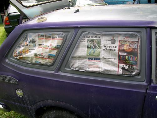

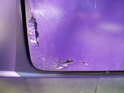

  19. Hi and thankyou 67Rolla-Ken.. Well yes it has helped with the colour choice by having started paint before rust repairs,bit of a tease i guess..lol.. Tho as i explained in my 2nd post car is being prepped outside.. So have gone about this a bit unorthodox yes,car is being preped outside in the weather elements and the way things have been in qld so far this year,very unstable.A WELL THAT GOES FOR EVERY WHERE LATELY REALLY. So just to have the primer covered up (as primer is pourus and likes to suck in moisture) i got top coat so as to give it a thing coat which also helps me see how straight i got the panels.. Rust repairs are minimal really and the paint isnt yet to final top coat stage..so i am able to go over areas and make sure things are all good before going the whole hog..Time and dollars are a factor also..so far i have been able to get onto this project at a good speed,but if for some reason the weather turns foul,i have no cover for the work i have done.. Previous experience has led me to think get paint on it now..i have an austin a40 in primer and under cover,and i have to do it all again as surface rust has broke through the primer..and that suxs better than a hoover... Cheers Terry
  20. Hi ya Phatke30.. Nice to hear I'm not alone in the blue car curse..lol.. Ok the welder i have is a gasless mig,trade tools recomended and does alright..is good for up to 270 amps i think. Has multi settings in amps and with thin metal i have found it easier and best to use on number one setting,so yes very low amps. With this welder i have taught myself on thin metal,that it is hard to do weld runs,so i do spot weld type welds.Which as you noted usually leaves the bulk of the weld topside.there is however enough heat and penetration that if you hold the trigger too long it will do a blow hole for ya...so the trigger is held on for like maybe anything up to or more than 10 sec intervals. Yes with the amount of heat always get distortion,the only way to combat that is to take longet to weld area..EG let metal cool longer between welds..tho I'm impaitent enough as it is..lol..or to use the wet rag system,yest again impaitence of mine. I accept that any weld i do will need some form of bog to final finish it,as i said i have taught myself how to use this unit..some days are better than others..but ya get pretty good at filling blow holes in time :) Cheers Terry

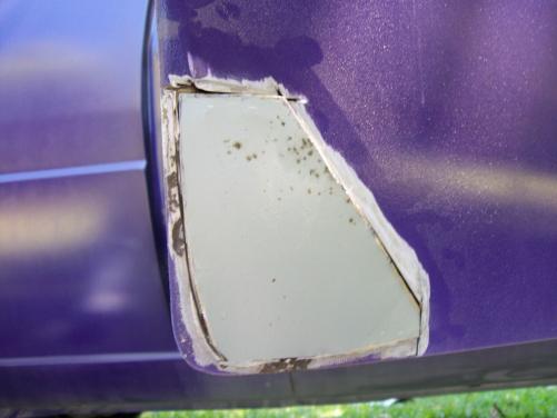

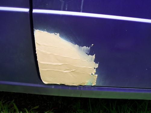

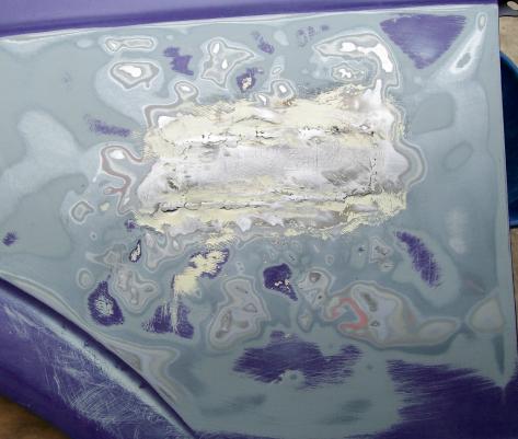

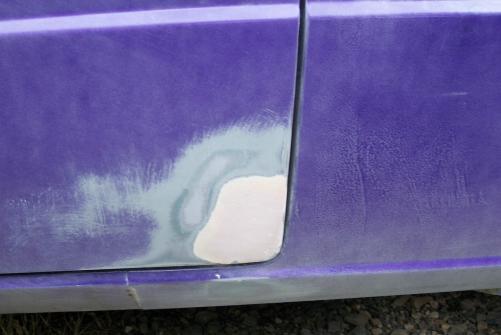

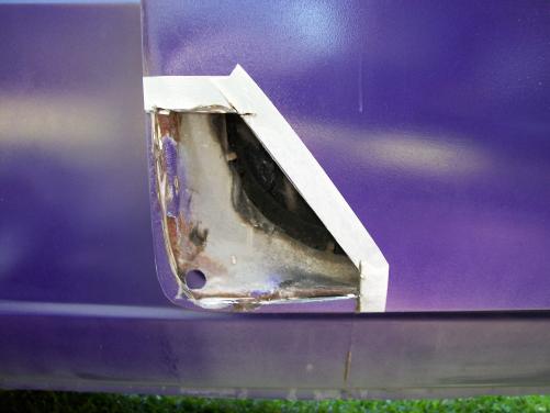

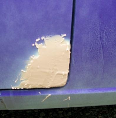

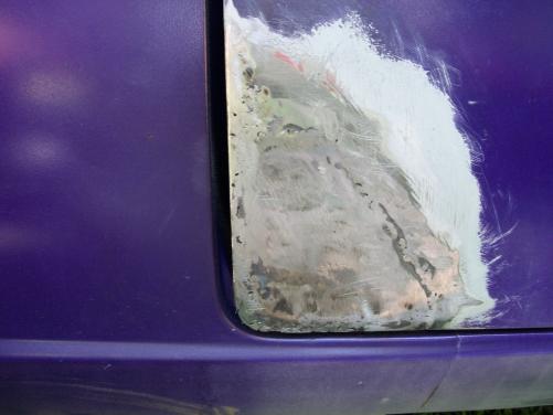

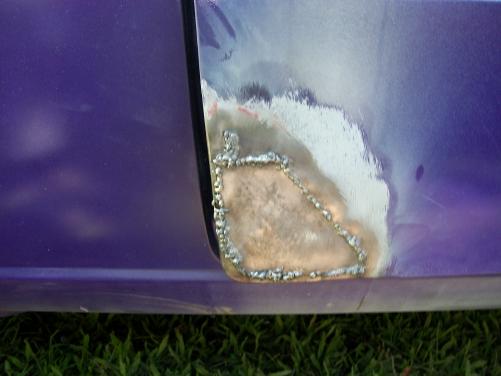

  22. Todays lil effort...drivers door rust repair in rear lower corner... Just a light skim of bog to finnish it off now..happy with the fact it has good metal there now.. Cheers Terry
