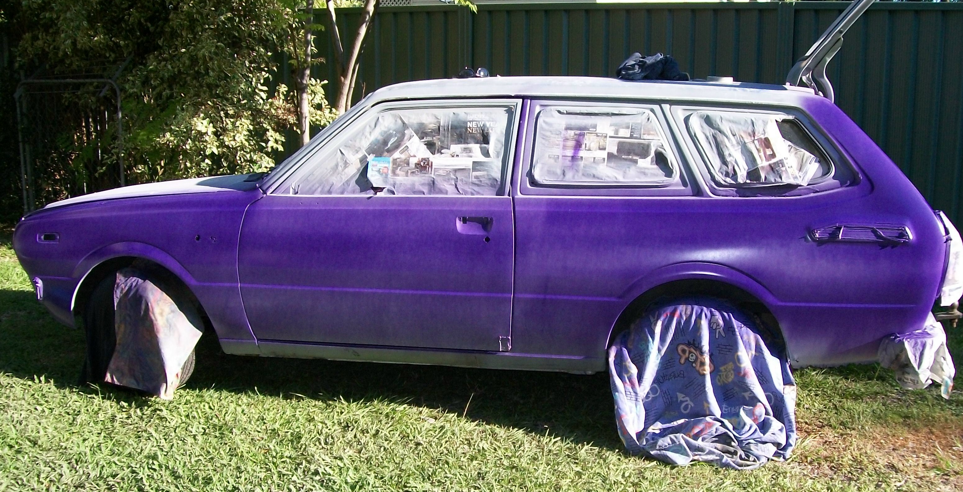

So have gone about this a bit unorthodox yes,car is being preped outside in the weather elements and the way
things have been in qld so far this year,very unstable.A WELL THAT GOES FOR EVERY WHERE LATELY REALLY.
So just to have the primer covered up (as primer is pourus and likes to suck in moisture) i got top coat
so as to give it a thing coat which also helps me see how straight i got the panels..

Looking good so far teaza, surprised this van didn't sell, your daughter is going to love it.
Cheers Crowie.
OMG! looking good tez, you have certainly gotten stuck into the body work! Good job fella!
Wow. Looks good Tez. :y:
Josh :cool:
Thanks for the kind words everyone :) :rolls:
