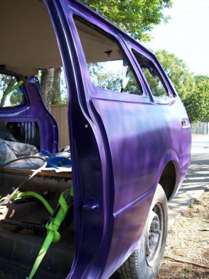

Alrighty....as of now I'm on two weeks off from work (holiday....hardly)...have to get this thing done.
So saturday 12-1-2013....happy birthday mum.....along with more work done,Ugly front apron made to look decent enough - left front fender now all dressed up in wild violet and left rear quarter given a few coats also.all straight off the gun (clear coat comes much much later).
Sundays task are to get sill panels finalized and get right rear quarter and hopefully bonnet done in wild violet...
Wednesday i should have my daughters at my place.....about time...some hands to help put the ke38 back together- body wise at least :).
Enjoy the pics

Ok 2 days into time off from work,well it starts monday 14th jan....lol.
The pace still good n steady....Today see`s right rear 1/4 and sill panel painted - neutral safety switch wired in and working correctly (thankyou altezzaclub and medicine_man) along with reverse lights and light for gear selector wired up.
Bonnet turns out to be not so good,highs n lows in many places,will make do for now and most bad shit should be hidden in the custom painted stripe/flame desgin I'm going to do,got very humid in Brisvegas it seems this arvo.
Was painting the bonnet and it moisture bloomed as can see in pic, oh well sort that out later...
Enjoy the pics
Teza40
