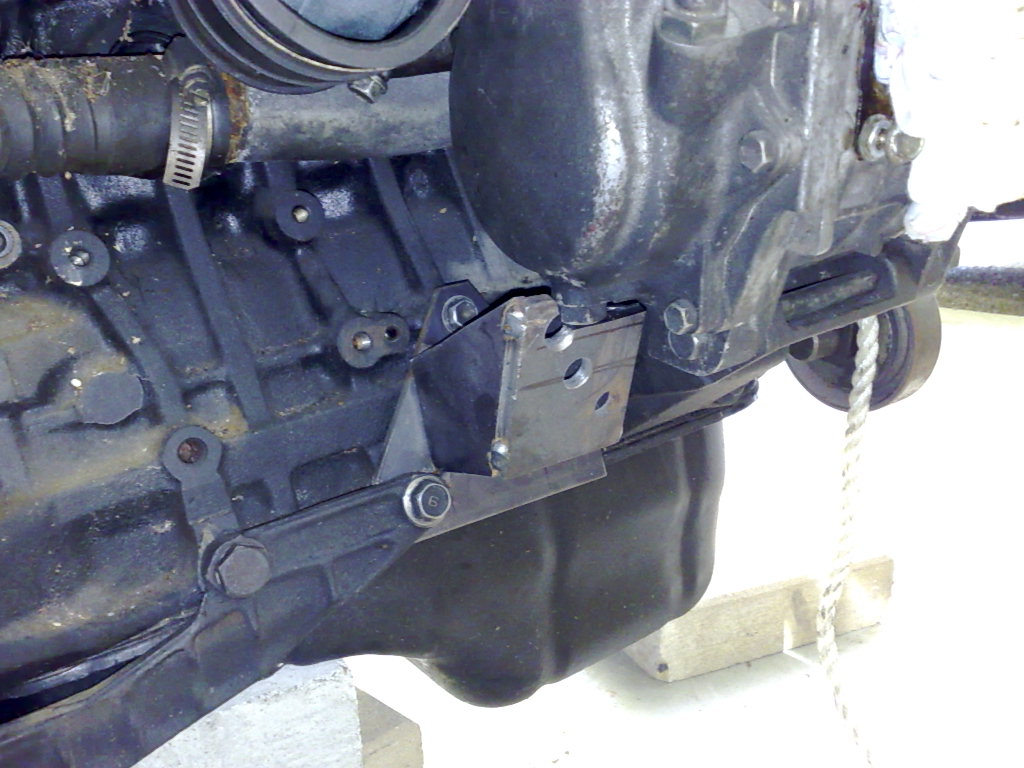

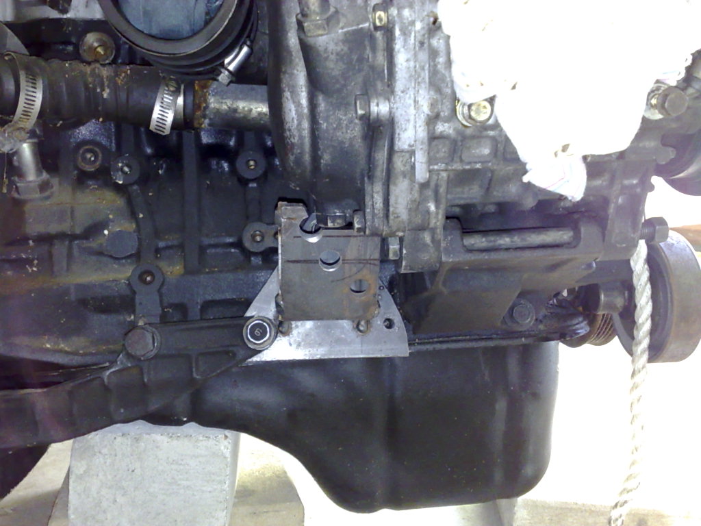

  15. Hi all, I'm in the process of putting a 4agze into a 55 coupe. I've searched and read a lot of posts about custom mounts for a 4a into a Ke. It seemed easy enough. The passenger side mount was too easy, but the drivers side is proving to be difficult. The Sc hits the rubber mount (the middle hole is the one, i would like to use the top left hole but as you can see there's no chance in hell) Are there any pics out there (that i can not find) of a 4agze mount for a KE crossmember?? Can anyone offer advise?? Also, At the moment I'm using rubber mounts from an AE86, they were lying around, very thick. I'm thinking of using a thinner (maybe smaller) rubber mount to bring the face out so i have some room around the Sc. Any recommendations for thin rubber mounts??
