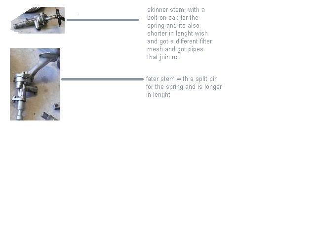

  11. i don't have a clue all i know is that i have 3 3k motors striped and that there are two different oil pick up and ones fatter than the other.. plus i have never striped a 4k... sorry
  12. hey these are for people that don't know about them. i am building a 3k motor and got up to putting in the oil pick up looked for the best one then cleaned it up and went to put it in but didnt fit and i was like what the f##k look at it and worked out to big and i was pissed so i got the different one and it fitted and worked out ones fatter than the other. here are some pics
