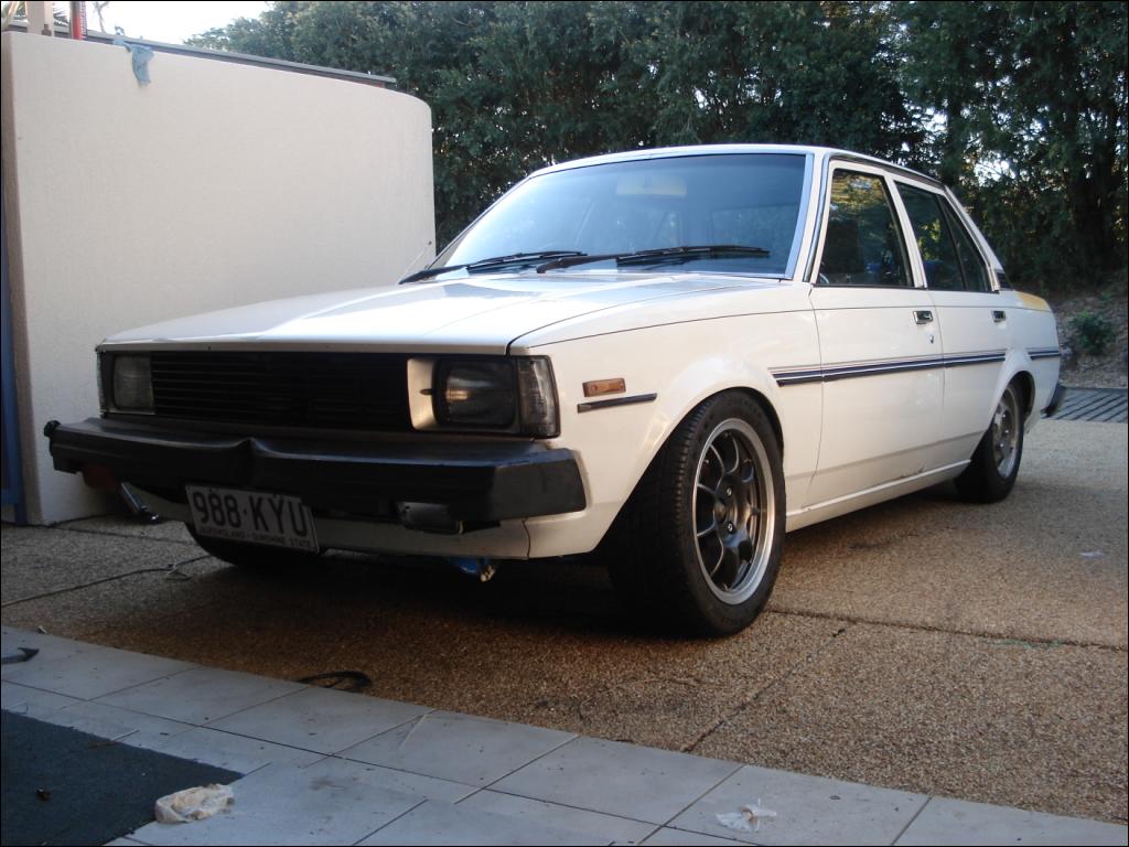

    put my meshies on the rear, had to lip the rear guard because of low down spec also got a pair of meshies for the front but the tyre profile is huge so they look crap and i brought another pair of meshies i think these are a the winner for meshies they are only 15 x 7 +13 but still sit out side guards due to the lcas, i like how the dish inst stepped like my other ones so going to get another pair the same as this maybe in a 8 for the rear going to get them restored so they are all shiney and still debating about going silver or gold centres also raised the front coilovers by a inch so its at a good height now just got the back end up, waiting for my struts hats to get back so i can start making the new strut towers

    she so pig now with the primer spots when i put the radiator in and put my battery in the boot i will show you the engine bay after i get this on the road it going down to the panel beater to fix the rust spots and paint them, i don't really want to respray the whole car as the paint is good enough for me. also got some meshies for it, nothing exciting but i can't really see the point in paying 2-3 as much for a extra inch or 2 of dish. I'm getting the centres powder coated so what colour should i do them, i don't like black so i was thinking gold
