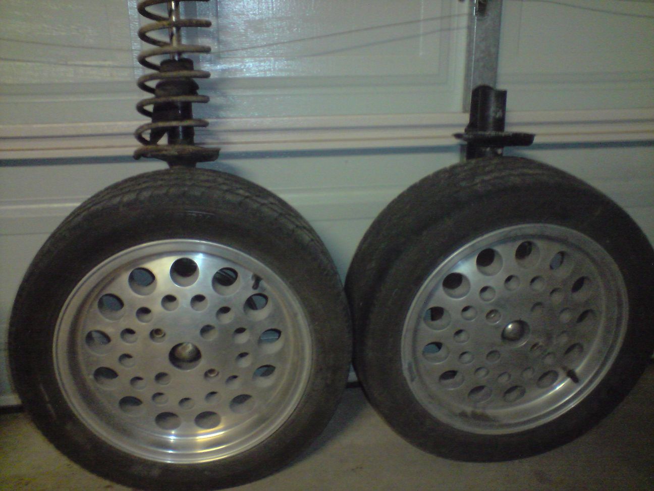

  1. I'm currently running Cressida rims which are 15's, alloy and sit correctly on the centre hub. I don't know the year but it was the last 4 stud Cressie.

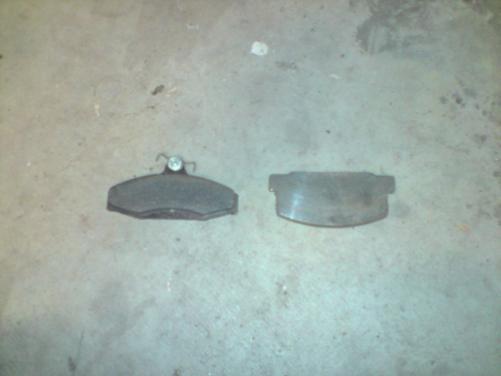

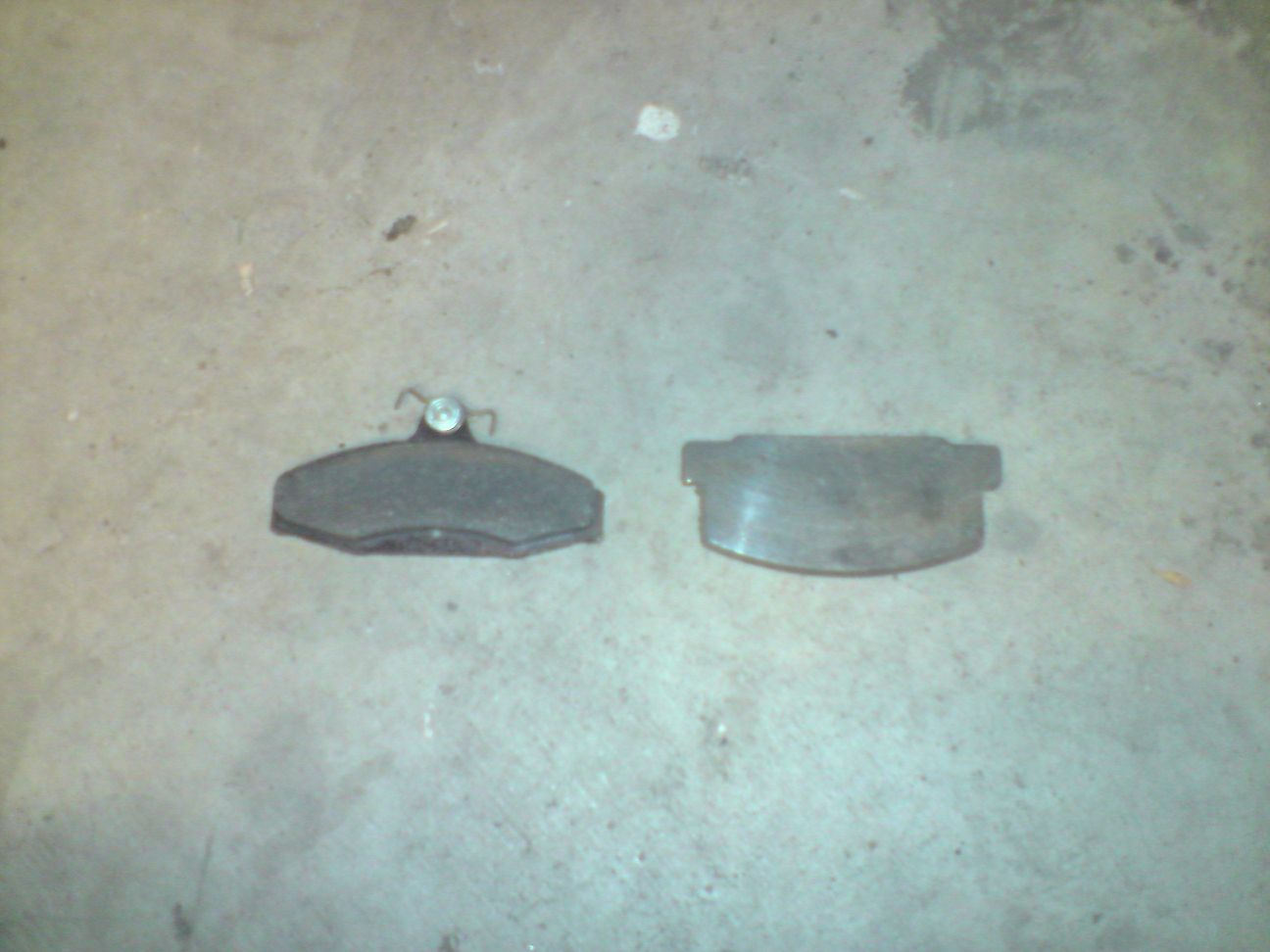

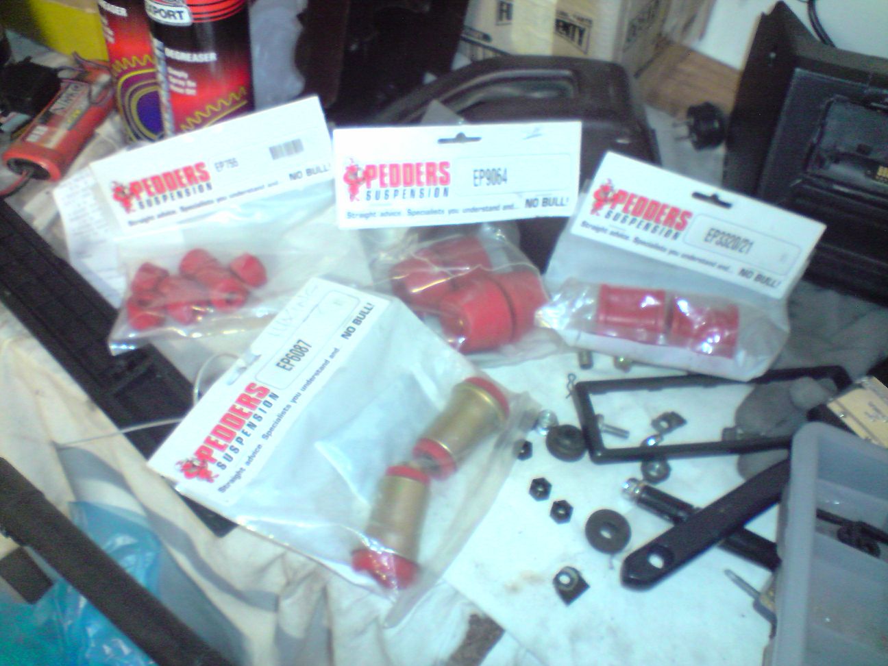

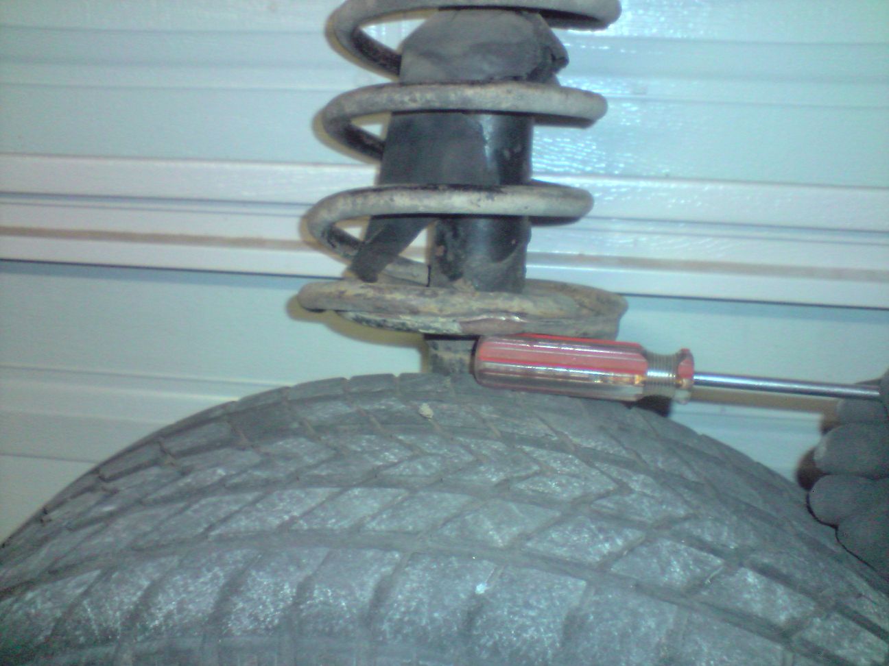

  9. It's great to know that my suspension is identical to the AE86. I wish I knew this BEFORE I ordered the springs and shocks. It might also be worthwhile mentioning that the struts are not interchangable, unless you also change the lower part that connects to the ball joint and tie rod end. I don't know what it's called :) Here's a pic of the brake pads as well.

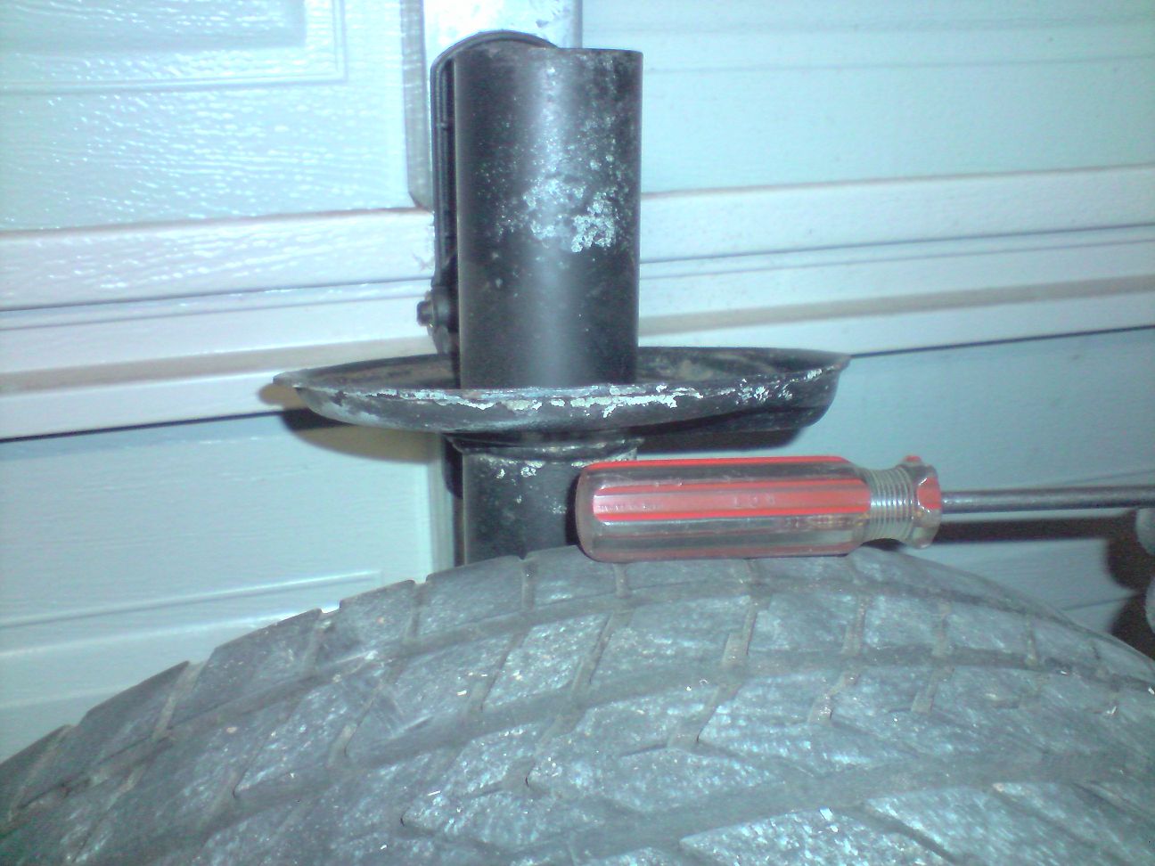

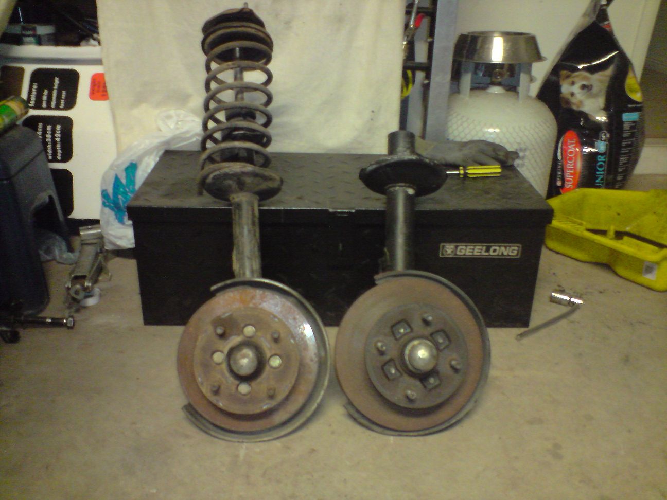

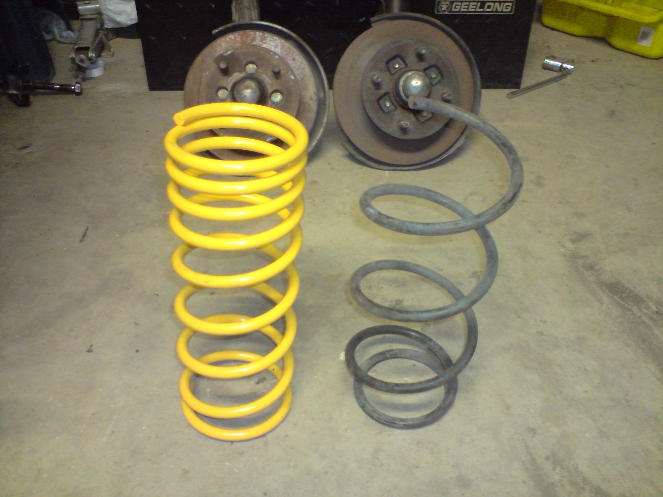

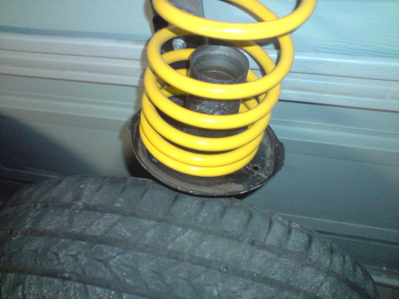

  10. I thought that some people here might find this useful because ordering suspension parts for the front end of AE71 Panno has been a nightmare for me. The parts were listed as fitting KE70/AE71 and as the pictures show, they are different. My car is a 1984 AE71 Panno and the KE70 parts are off a 1982 model sedan. KE70 parts are on the left. AE71 stuff on the right Tyres are 195/50/15 King Springs Low (part no. KFRL-16) and Stock Springs Low (part no. Makita angle grinder) Strut clearance pics of AE71 and KE70 KE70 spring on AE71 Strut

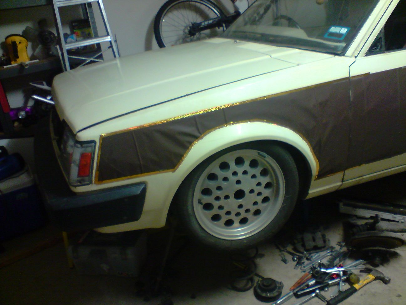

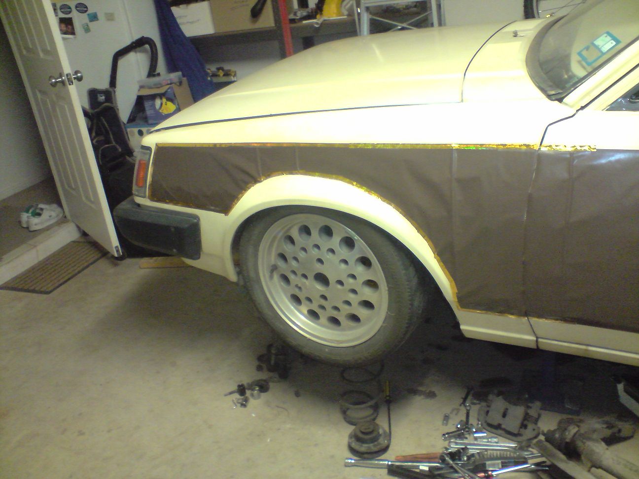

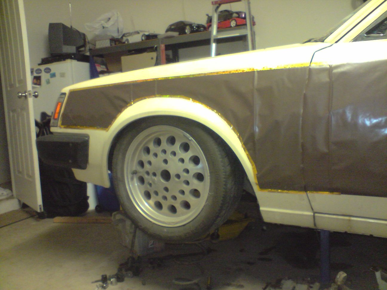

  12. Ok so I went to Big W today and bought some brown and gold contact because I couldn't find any place that had a timber look contact. Here is a mockup of my 3rd colour/style choice which was also suggested by Chobis. Is it a winner?

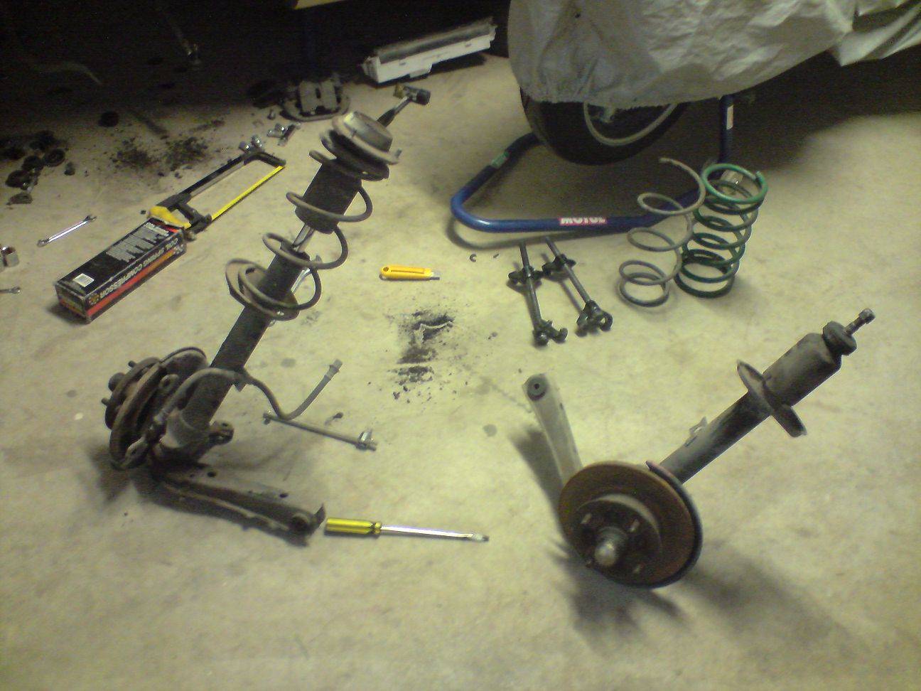

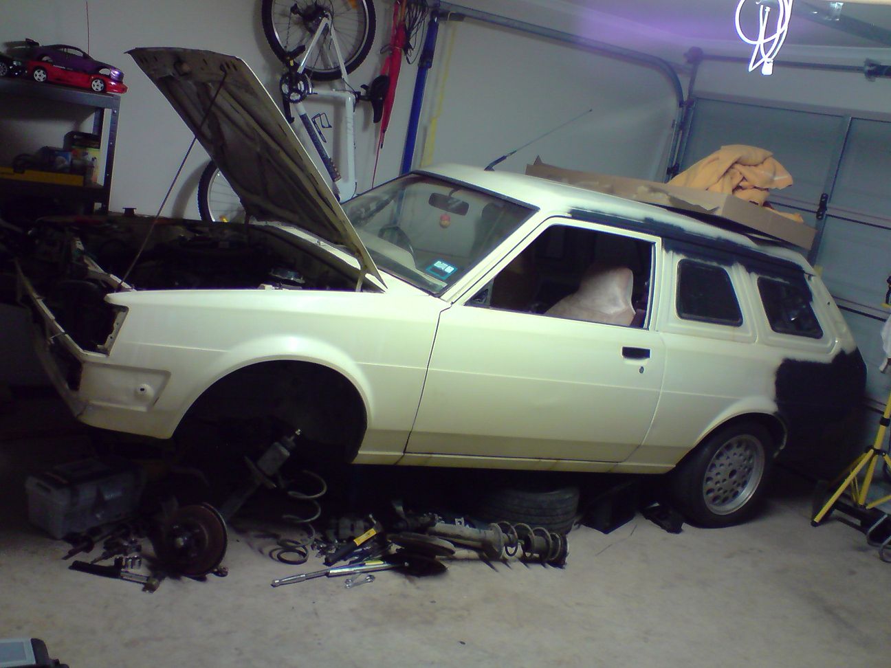

  14. Here are some pics in it's current state. Left side: Front suspension removed: Will eventually get new bushes throughout: Thanks for the opinion CHOBIS, i'm gonna try and get some timber look wallpaper/contact tomorrow to see what retro will look like.
