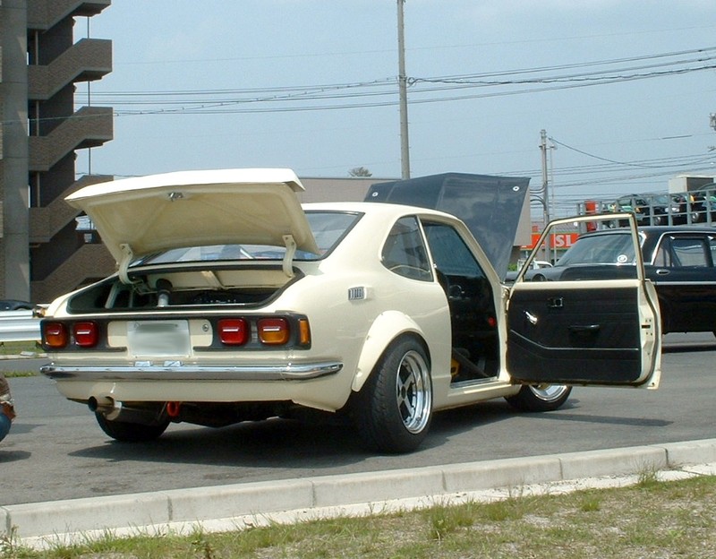

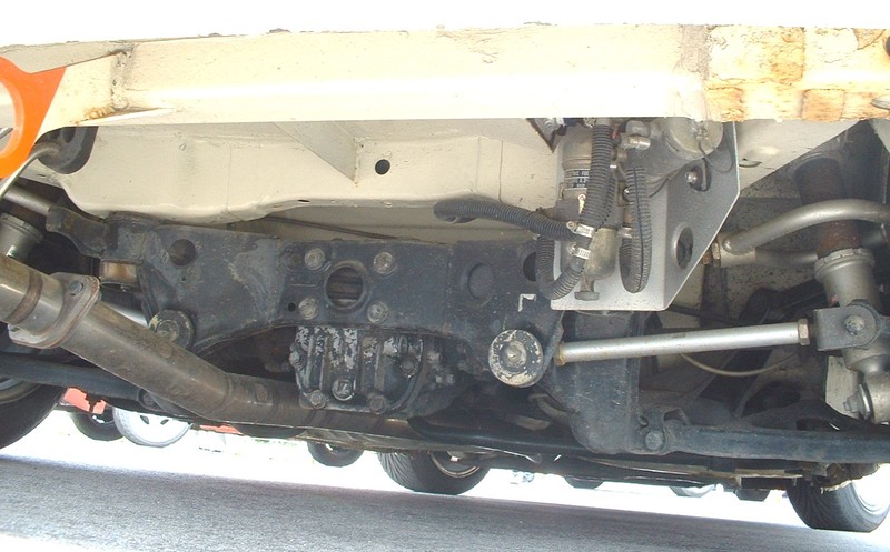

  22. For anyone interested, here are the pics of the te27 with the s13 irs in it. Not that helpful, but beggers can't be choosers!! At least it shows that the conversion has been done. Fyi this was/is in a historic race car - technically it should not be as it is not a period modification! This shot is slightly more usable (only a little bit though) pity he didn't get right under the car... some people are so inconsiderate of others!! :)

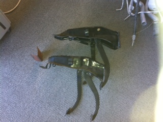

  23. Pedalbox modified & installed Ta22 pedal box partially modified & unmolested version Pedal box installed into car with the modified column
