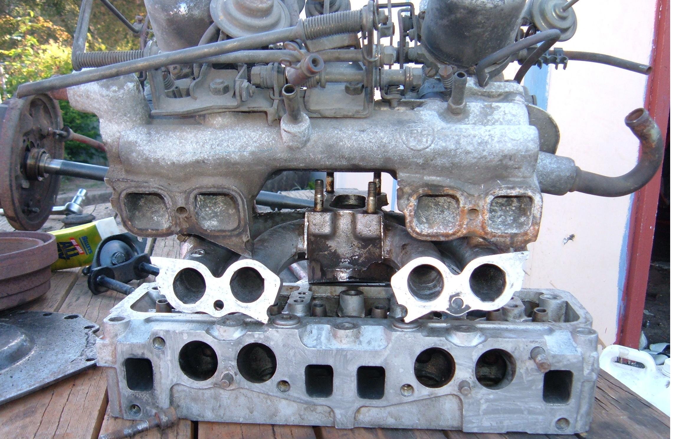

November 4, 200619 yr comment_149463 as the description says i found some asian sus and just want to know a few things about them 1. what are they off? 2. are they a good size for a 4k or 5k? 3. are they worth repairing? 4. what would you pay for them? pics http://www.rollaclub.com/board/index.php?a...5506&st=225 Edited November 4, 200619 yr by flat out Report

November 4, 200619 yr Author comment_149497 thanks mate, pulled them off the manifold and they have abit of crap in them and coroded, nothing a soak in inox wont fix i hope hehehe Report
November 4, 200619 yr comment_149513 They are twin Aisan SU carburettors, like a copy of the HIF british SU's. They came on the later corona's, on the 18R. Where as the earlier Corona 1600S had the SU's with the fuel bowls off to the sides (HS). The carbs are pretty rare. I don't think there are any genuine parts available for them; though some british SU parts may fit, with a little modification. I got some twin Aisan SU's up at a wreckers in Launceston (Foster Street) as well. The guy reckons they were off a dasun, but they weren't Hitachi's. After researching for a while, I found out they were from a corona. Though mine were on a galant like manifold, water heated, with adaptor plates. I found out that it was highly likely that they were originally from a Mitsubishi Colt Galant, since they came out with them as well: Twin Aisan SU carbs What code are on them? Mine had a tag with the code "HF40D" Have you got any pictures of the manifold, and the bolt pattern on the other side of the carbs (carbs to manifold). Mine were a triangular bolt pattern. Report
November 4, 200619 yr Author comment_149530 yea i do have pics but i still can't post them up in this section Report
November 5, 200619 yr comment_149557 yea i do have pics but i still can't post them up in this section Try now... Report
