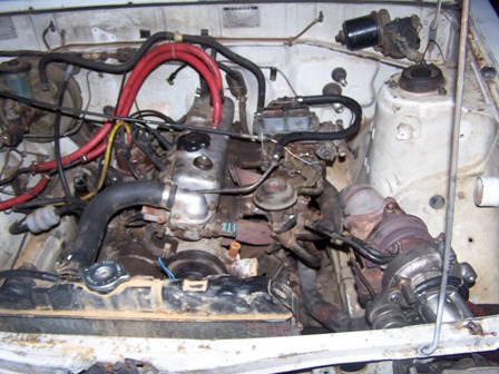

:y: She fits ok then?? Yeah the air filter was right up against the front panel in mine, thats whats with the 90o bend to fit it in. the bend is actually the pipe that bolts onto a t25 outlet, and then has the cooler piping start off that!!
How does the exhaust fit btw, got him all tacked up again?
exhaust isnt done yet, had to give the part of the crossmember where the engine mount bolts on a few taps so the j-pipe would fit.

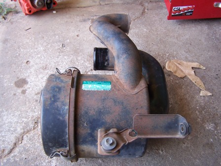

I'm thinking about making my own box out of sheet metal, but ill see what i can find at the wreckers first.
Cheers, Rob
Thats basically exactly what I started with!!! :y:
I'll take some more detailed pics of my box for you and you can just copy it......lease we know the box design works anyway!
Use the rounded end in the left of the pic to bolt to the mani, just bash the centre as flat as you can first and drill some holes through. with the other end, cut off the pipe, and block up the hole on the top of the box. thats what that chequer plate circle on the top of mine is for. cut the air filter attachement out of the middle and use the pipe on the side for your inlet. :no2:
:D so did I!!
Its pretty hard to do cause for 1 theres the oil fires, but also its hard to get weld to stick to oily metal!! :)

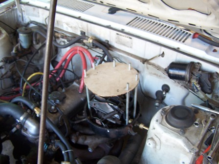

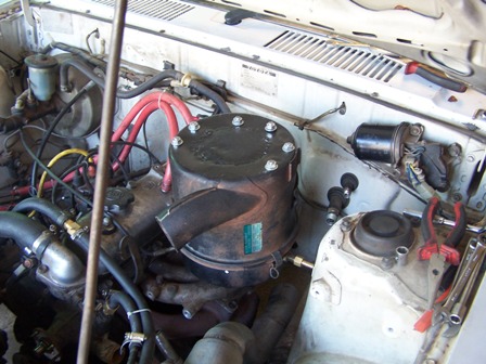

Box is looking good though, might just want 1 more rod on that front side so you can get even pressure pushing down the whole way round it.

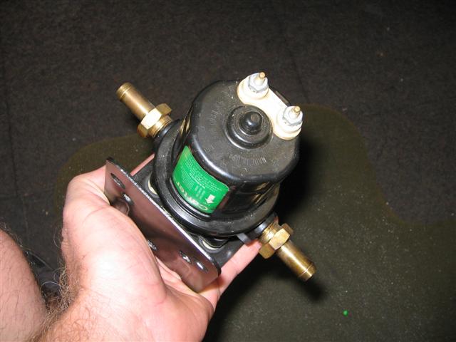

UPDATE:
Everything is done, just waiting for fuel pump.
Then all i have to do is fit it and wire it up.
Note: not my hairy arm :D
