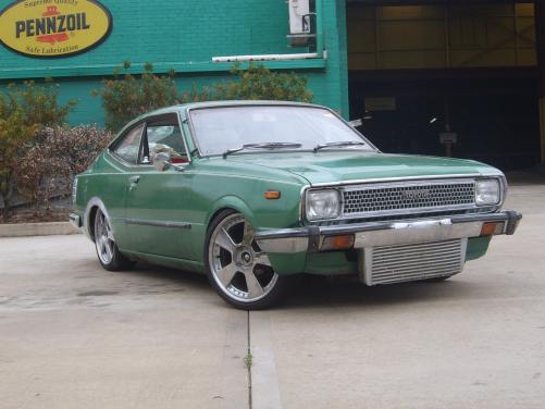

THERES NOTHING WRONG WITH PUTTING BIG WHEELS ON THE CAR, AS LONG AS I KNOW IT WONT GET IMPOUNDED AND NO BIG FINES OR LOSS OF LICENSE I HONESTLY COULDNT GIVE A F#@K ABOUT THE DEFECTS AND ALL THAT SHIT
You better not live in NSW then, as even a minor defect is $231 and 1 point. A major defect (no idea what those wheels would qualify as though, but they're definitely defectable) is $308 and 3 points. 3 points is all you get on your red Ps, so heres hoping they don't find something else wrong with the car that they can canary. Gone are the days of simple fines for defects, it hurts your license now. Basically, 2 or 3 defectable things on your car and it's bye-bye license, and a good wad of cash

you are wrong buddy, there is no points lost of defects but there is a fine. hopefully the car will be enginered before it gets on the road so i can just sit back and laugh at them
Perhaps I wasn't quite clear enough. Obviously a defect is just a notice to tell you to go and get something repaired or fixed, but in your case the 20s can't be "fixed" unless you just take them off. The RTA clearly states on its website that driving a vehicle that breaches a defect notice carry a fine as well as the loss of 1 or 3 demerit points. If the cops pull you over and you've been defected before, they'll check to see if the defects have been removed. If you're still driving around on 20" wheels, obviously the defect hasn't been removed, and you'd be screwed.

you could be rite but ive never heard of the demerit points on a defect. ive been defected before and i obviously cleared it but there was no demerit points taken just a fine. if the wheels are enginered they can't defect me can they??
and i could just take the 20's of to clear the defect and put them back on after is that counted as breaching the defect or what ever its called??

I'd love to know what front suspension you are using, as my 17's with 40 series tyres only JUST clear the bottom spring mount on the strut
ive actually chopt the front springs and ive turned the back leafs springs upside down which is possibly 8 inches low and theres a good old saying."theres nothing a hammer can't fix" :jamie:
It doesn't matter about the front springs. I've chopped mine too. My point is, a 17 inch rim with a 40 series tyre just about touches the bottom of the spring mount on the strut, cutting the spring does not move this, there is nothing you can do to move it unless you have changed the struts. Show us a picture from underneath the front. I want to see clearance
ive hammered the front strut and if you have read the forum the car is at the panel beaters i havent got access to it. but again ive hammered the front struts
