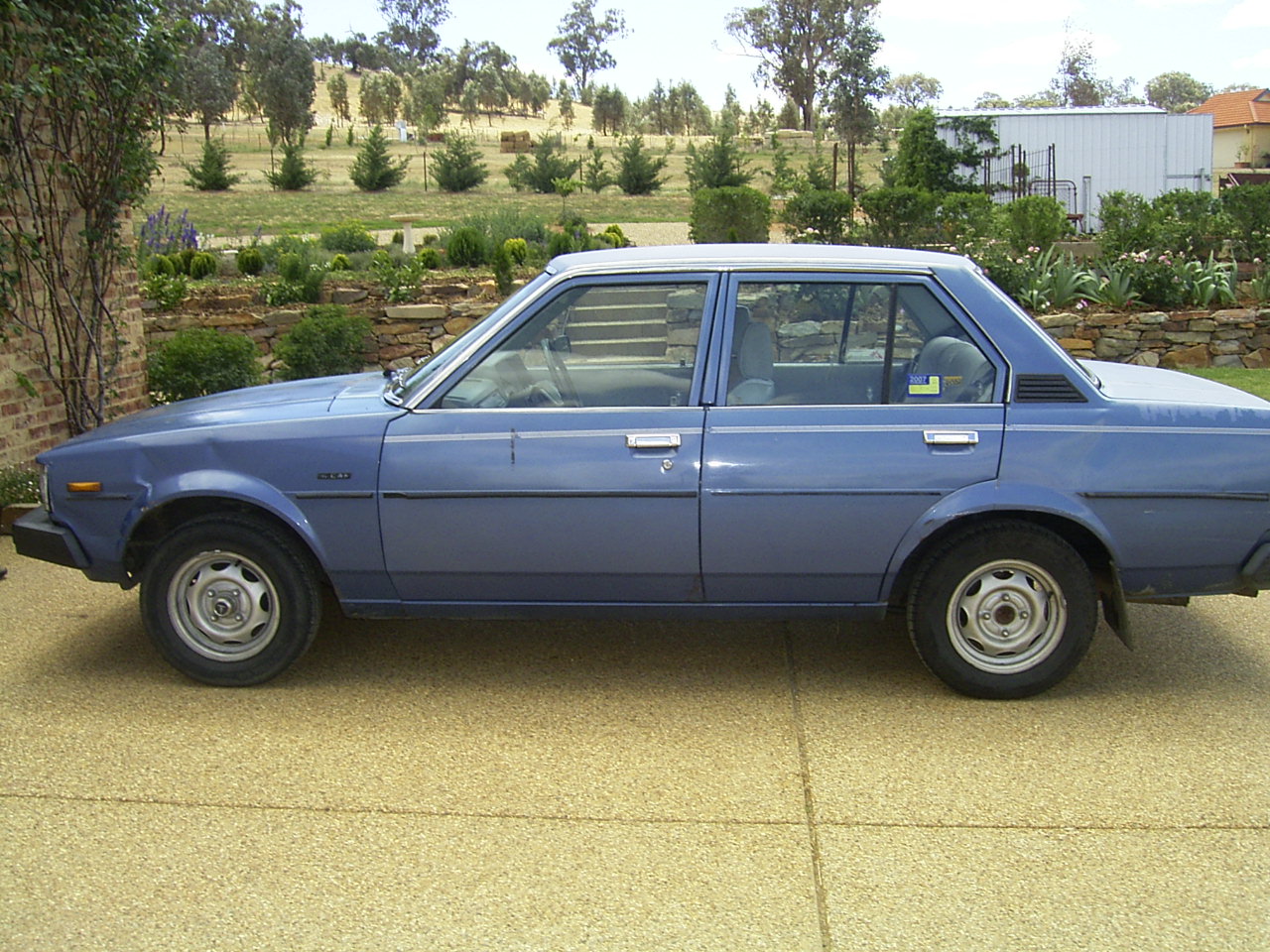

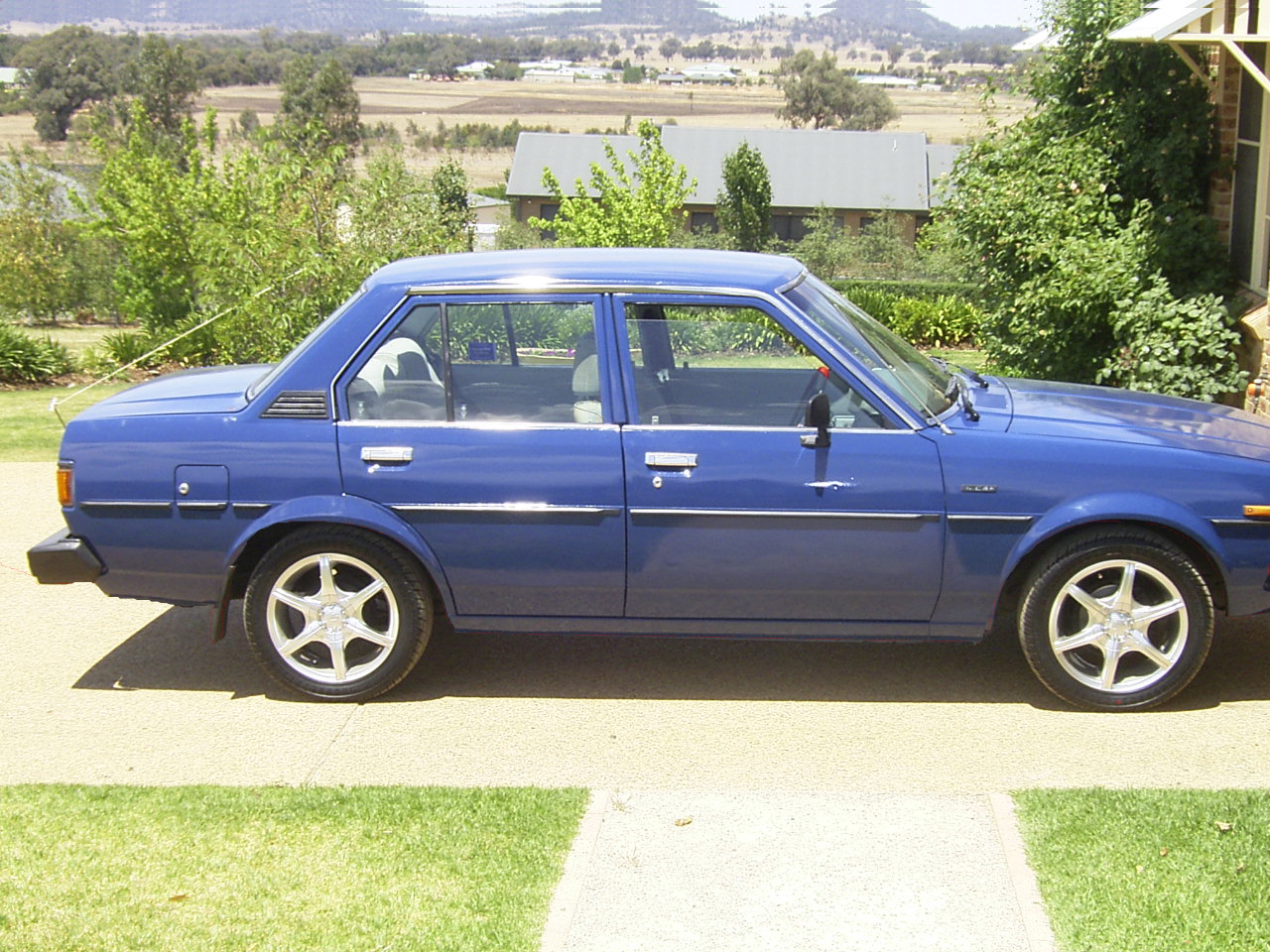

So I got myself a 4-speed manual KE70 Corolla for $500 and started "sprucing" it up a bit. The car was in Okay condition when i purchased it however it needed some panel beating and fresh paint. also the rims made it look a tad better. Ive got most of the interior and exterior done, however the stock 1.3L engine doesn't quite have enough go for my liking :jamie: Does anyone have any suggestions for a higher power engine that is relatively easy/cheap to come across that works well in a KE70? Any suggestions welcome.
here is a picture of the car so far...
