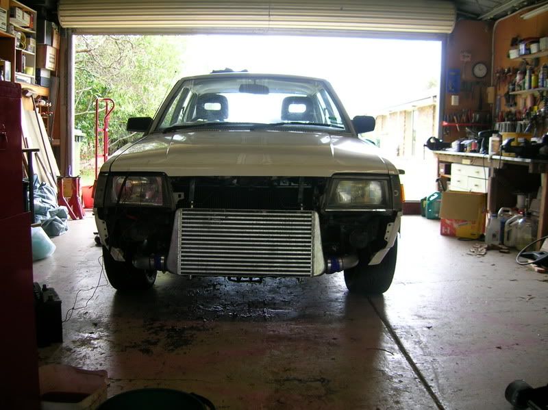

unlike ones like mine...
...finding pic...
thats with the bumper removed. couldnt find one with the bumper on
but u get the idea
it stick outs 100-150 below bumper

Ha, well you don't see mine and its (overall) 630Lx320Hx70D so i should be right.
