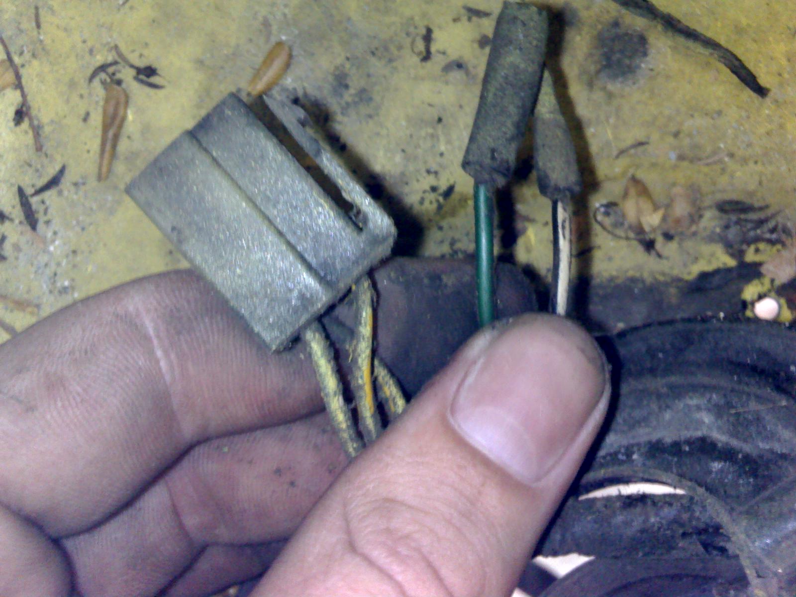

Hey hey,
When i pulled up the cover for the fuel sender in my ke70 there was a plug for the fuel level sender and 2 more wires that were not hooked up to anything, What are they for ?
more likely a switch for a low fuel light, maybe it was an option they prewired them all for.
Yeah, I think he is on the ball with that one..
It was the number plate wiring but someone has made their own that cuts into the parkers. :D
Still makes me wonder why they made their own wiring.

they would have had to unplug it to get the bumper off... lol
anyways...told you so des :D
:D
They probably didn't know the wiring existed down there as its covered up normally..
:yes:
Number plate light's see attach pdf, white wire with black strip = earth, green wire = power from tail light relay
