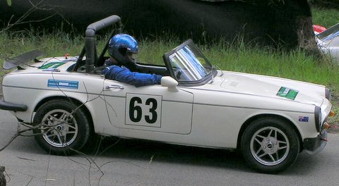

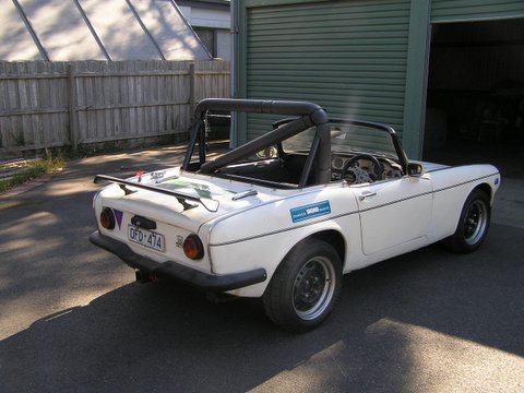

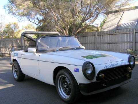

a couple of shots of my horolla or toyonda. Honda S600 with a bigport 4AGE. Initally had a mild 3K in it but was sadly underpowered at hillclimbs. After reading your forums and Phil Bradshaws page I decided that a 4AGE would be worth installing.
as with all conversions this had some issues ( all overcome).
The car has been log booked by CAMS and I use it for hillclimbs. I am still fine tuning it but on the Dyno got 68kw ATW ( much better than the 34kw ATW the 3K got).
I am trying out the "flasher can" substitute for the SPD on the ECU this weekend ( thanks to all for this info). If this works the extra 800-1000RPM at the top end will be well used ( currently limited to 6700RPM with no SPD connected). The aim will be to use a 555 timer circuit down the track.

just finished an excellent weekend hillclimb racing at Mt Leura in Camperdown with the car. The flasher unit supplying a signal to the SPD sensor on the ECU worked a treat and I am now good for revs to around 7400-7500 RPM.
I am getting a mate to wire up a 555 timer cct which will reduce the size of the unit and remove the flasher signal beat.
