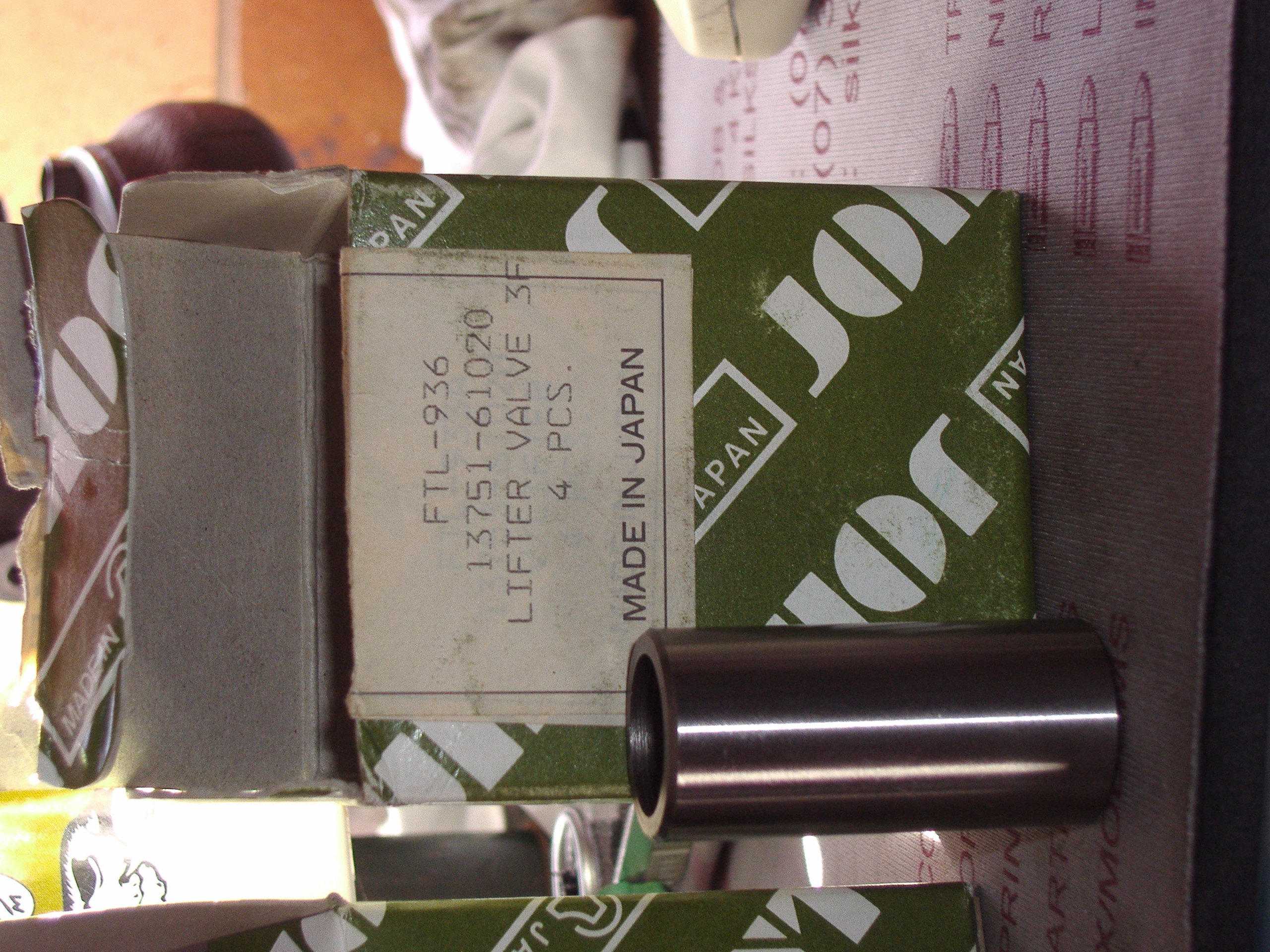

Hi,
Ok I got lifters today. I looked at all the prices of lifters went ot 4 car shops adn decided 3F original lifters wee the best to get :)
So below is a picture of the find:
The cost of these currently the best I could find was $13.95 per lifter :cool: And being a student I didn't want to pay this much..lol But still $13.95 is better than what Toyota quoted me for lifters they wanted $40 each.
So At this shop that was the cheapest (walkers A1 in ippy) I said if I buy 8 on the spot here now can you do them for $11 each. I though mm he might not drop it that far but worth a shot. So the guy went and played on the computer for a bit and then came back and said he can't do them for $11 but can do them for $11.12 SO I said SOLD and bought 8 of them. So pretty happy with the find as I did get them cheaper. As other prices for lifters were $17.95 each for holden solid lifters (this was the crow cams price as repco is a crow cam dealer) and , $20 for chev lifters even though there the same thing go figure so best bet is go to walkers A1 and get original 3F lifters it is the cheapest way out in the 5K lifter issue. And there original Japan made parts to :D

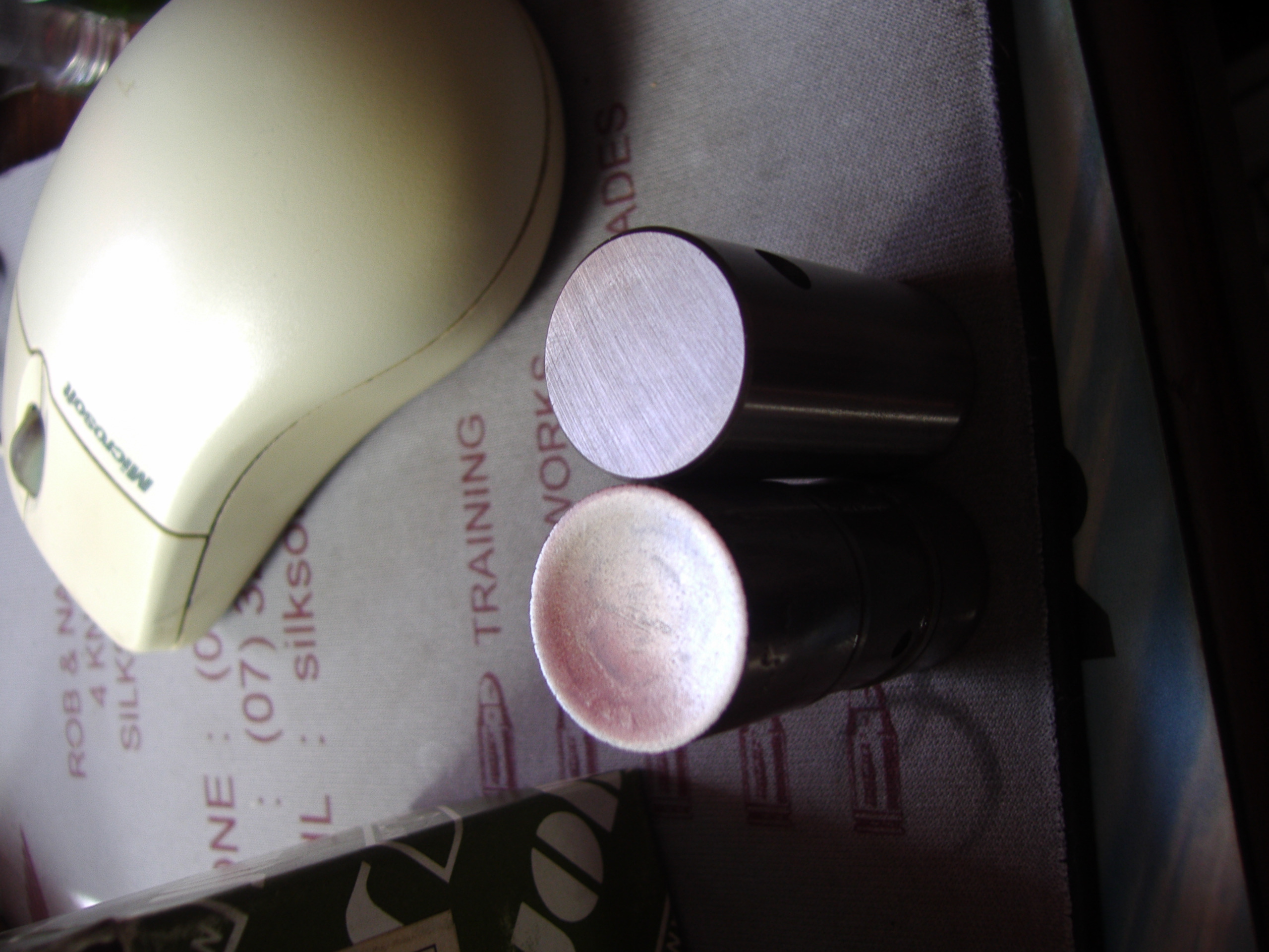

Now to answer Matt's question about missing lifter bottoms ok might of miss lead people there the bottom of my lifters are now dished..lol And yes there stainless steel but there was no damage to the cam shaft so goes to show a hardened nitride cam shaft is strong :dance: But below is a picture of a 5K hydro on the left and a 3F new one on the right:
Only about 3 are this bad the rest are better but have pitting and well d4ead anyway. As if these were still good I would of made dirty lifters and turned these hydraulic lifters into solid lifters :dance:

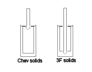

The pushrod end sits lower in the 3F lifters than the chev ones. I've attached a quick pic of what I mean. Note the chev ones may sit a little lower than how I have drawn it but you will get the idea.
Also yes there is two different rocker pedestal heights. The only thing is that they both sit the rocker shaft the same height in relation to the top of the head. ;)
Also yes there is two different rocker pedestal heights. The only thing is that they both sit the rocker shaft the same height in relation to the top of the head. :)
Hence WHY i use holden/chev lifters and there is no issue with using A12 pushrods, my 5KT is currently running this exact setup.
