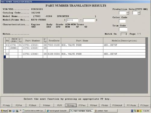

Hey Cameron, if you can't find one at the wreckers, you might have to try at a toyota parts dealer, with the part numbers

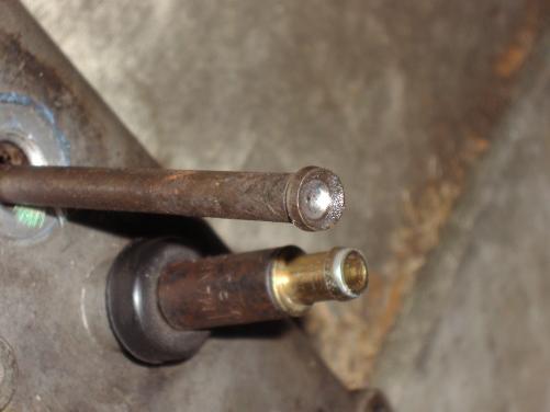

OK the problem I have is the stainless steel lfters I have in my 5K most of them are stuffed as well the bottom of them is missing..lol
I will get a pic tomorrow as it is late now.
But it looks like I will be going to super cheap tomorrow to price and order some AT992 GM Chev and Holden lifters off them. As then the 5K will be running as I have 8 A12 datto push rods in the post now so 5K will be running and ready for the sprinter.

Also whats wiht the STAINLESS STEEL lifters man, the bottom of them is missing????????
