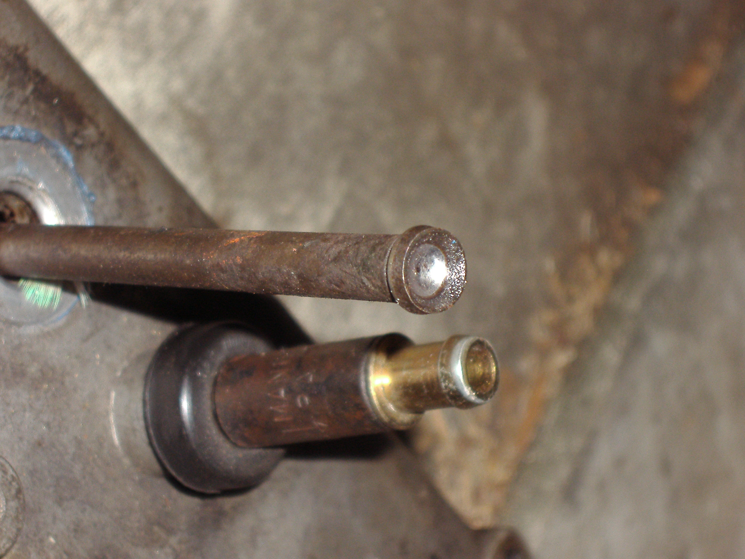

So I then put a push rod in that I found tonight in all my corolla parts that is believed to be out of a K motor as it was found in superjamies parts I got off him and it is also VERY similar to a 3K push rod and looks different to a A12 push rod. Picture below:
Above the push rod is sitting vertical to show you the shallow top. This rod is the SAME length of a stock 3K-C push rod, but the bottom of the cup at the top is higher up so the adjuster doesn't have to be wound down as much to touch it. Also the diameter of the rod is the same also the construction of the rod is the same as a 3K one so I am pretty sure this is a Toyota item.
Well when this push rod is in the 5K with the adjuster wound down so the top of the adjuster where the screw driver slot is level with the locking nut it is about 3mm off touching the bottom of the push rod cup.

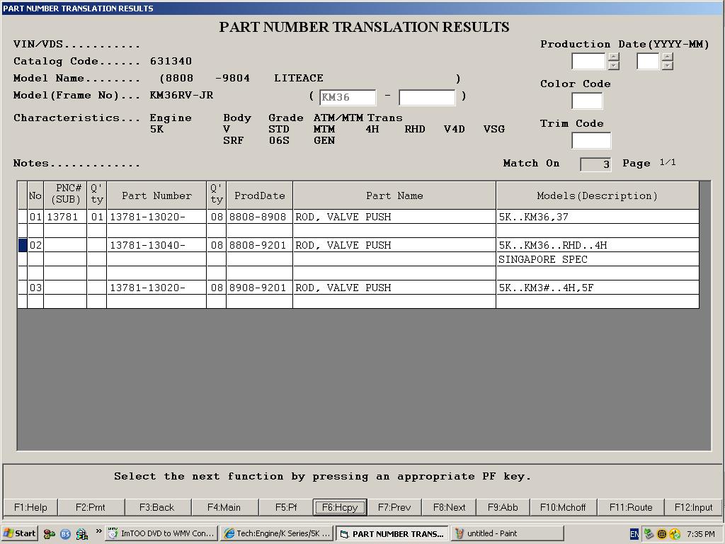

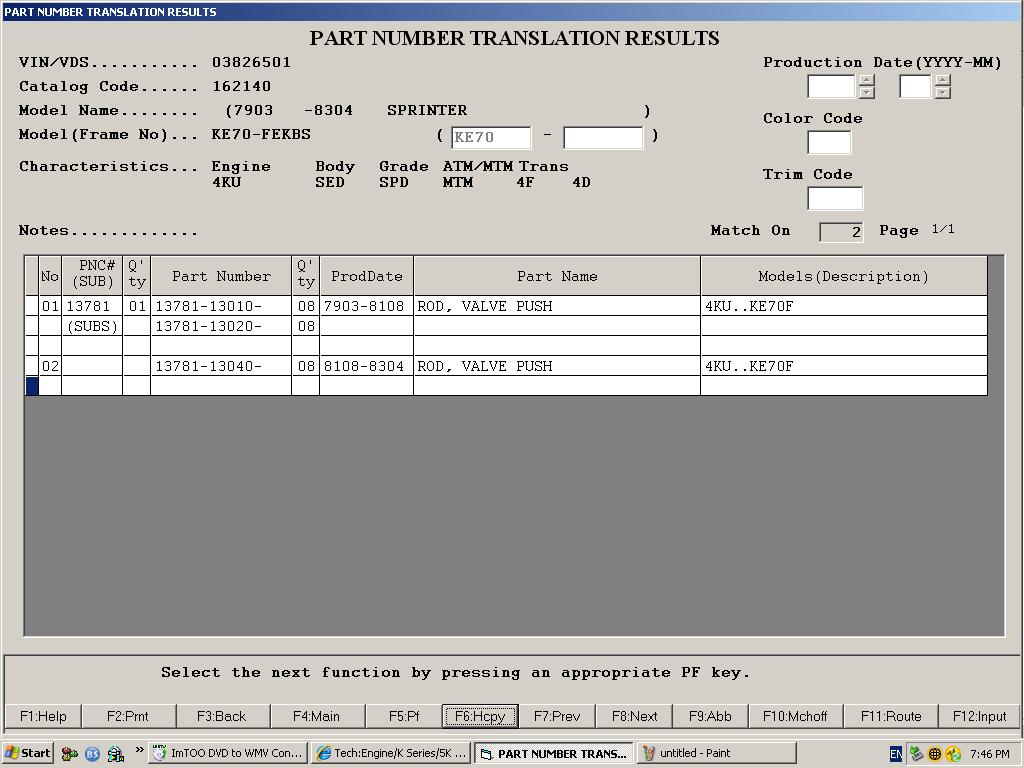

Also to make this reply longer the part number in the 5K solid lifter motor is the same as what is in the 4K-J and the 4K-U motor. I believe these were dished piston 4K motors?? I so all you need is dish piston 4K push rods and presto will fit and work The part number for the matching push rod is: 13781-13040 or 13781-13020. Also I found the australian released KE70E update model its 4K came up with having push rods the same as the solid lifter 5K so were late odel KE70's dished piston 4K's? As it didnt tell me if it was a 4K-C/E/J/Uetc?
Below is the IPC screen print of 4K-U push rods and 5K solid motor push rod part numbers so you can see there the SAME.
Above is part number screen for KE70 4K-U motor push rods.
Above is part numbers for the 5K motor that has solid lifters in it. Also from the same car as the wiki part numberpage for the lifters.

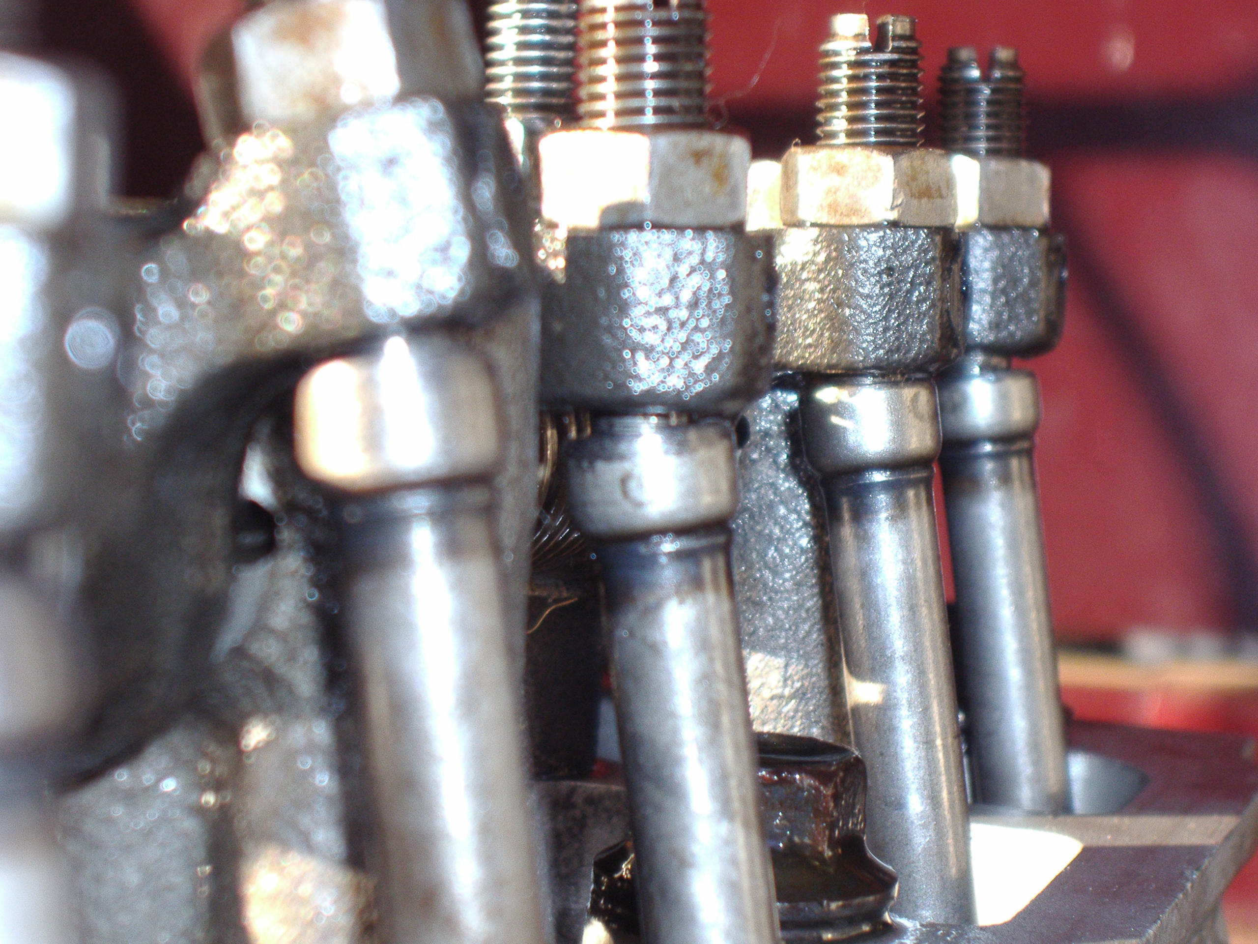

I found with 3F lifters and the short steel 4K rocker posts and the adjuster wound out a fair way 4K push rods would fit if the cup was smaller. So I went to my mates engine reco shop to ask him if it is possible to grind down the cup on a push rod to make it fit. He said this is OK as he had a hot 3K once the block adn head was shaved so much before the push rods foweled on the rockers so he ground them down to fit on the cup.
So I took 8 4K push rods I had to the grinder made the cups smaller and put them in. They fit :) Below is a picture of them installed and all the tappet gap set right:
I found but the casting of some rockers is POOR there are dags all over them. So I found after grinding some 4K rods down to a safe limit they would still hit slightly on about 2 of the push rods. So Not having the time to again remove the rocker gear I put the motor together and plan to test the motor running in the KE15 and see if I blow a push rod. If I do I can look to see what one goes and see if it was one hitting the rocker.
But some fit like they were made to be in there from the factory and have a good size cup on them still.

Those adjuster screws are wound up a long way. I'd say they will hit the underside of your rocker cover pretty badly.
Yeah i thought of that but its only a small cam i think,
Pay to check that cam as felix has said.
