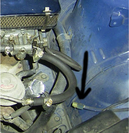

The 32/36 has no loose wires hanging anywhere, and as far as I can see, there isn't anywhere where it would be possible to connect wires to.
At the moment the solenoid wire (precisionly marked by arrow :yes: ) isn't plugged to anything so maybe that is messing with things. :hmm: I'll have another search on the carb for where wires may be possible to attach to it. Thanks for the help des, i'll see what i can come up with after another search :y:
