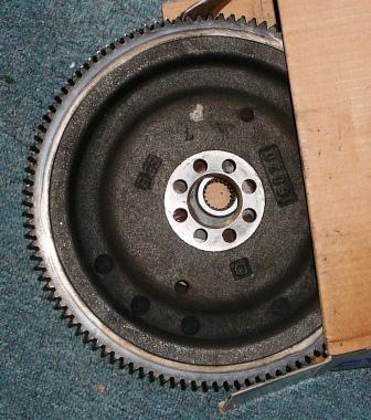

Fywheel and used clutch showed up today, hopefully the clutch in the AE71 looks better.
To finish it, all thats missing is -
-extractors and exhaust
-spigot bearing
-motivation

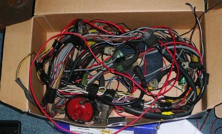

Completed the wiring today, I had 2 hacked looms that resembled a bowl of spaghetti and they combined perfectly to make a harness for the bigport after and hour of unraveling. A 3SFE camry power plug is identical to a bigport for anyone missing theirs in there loom. It's cheaper to complete the standard ecu setup than paying to tune the adaptronic, so it'll be on the shelf till some cam's or a turbo lands on the motor ;)

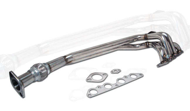

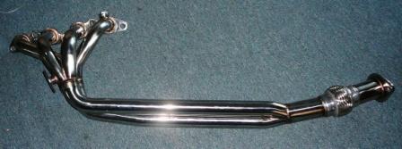

Payed for some ebay 4-2-1 headers the other day. Cheaper than anything in Australia and stainless! Really keen to see how the 4-2-1's go, haven't seen many bigports with them. Lets hope they welded the sucker properly.post-437-1189867077_thumb.jpg
Ha let me kow what they are like as i was lookin at the same one, The one thing i noticed is that the o2 sensor only picks up from 2 & 3 shouldnt be a drama tho.
