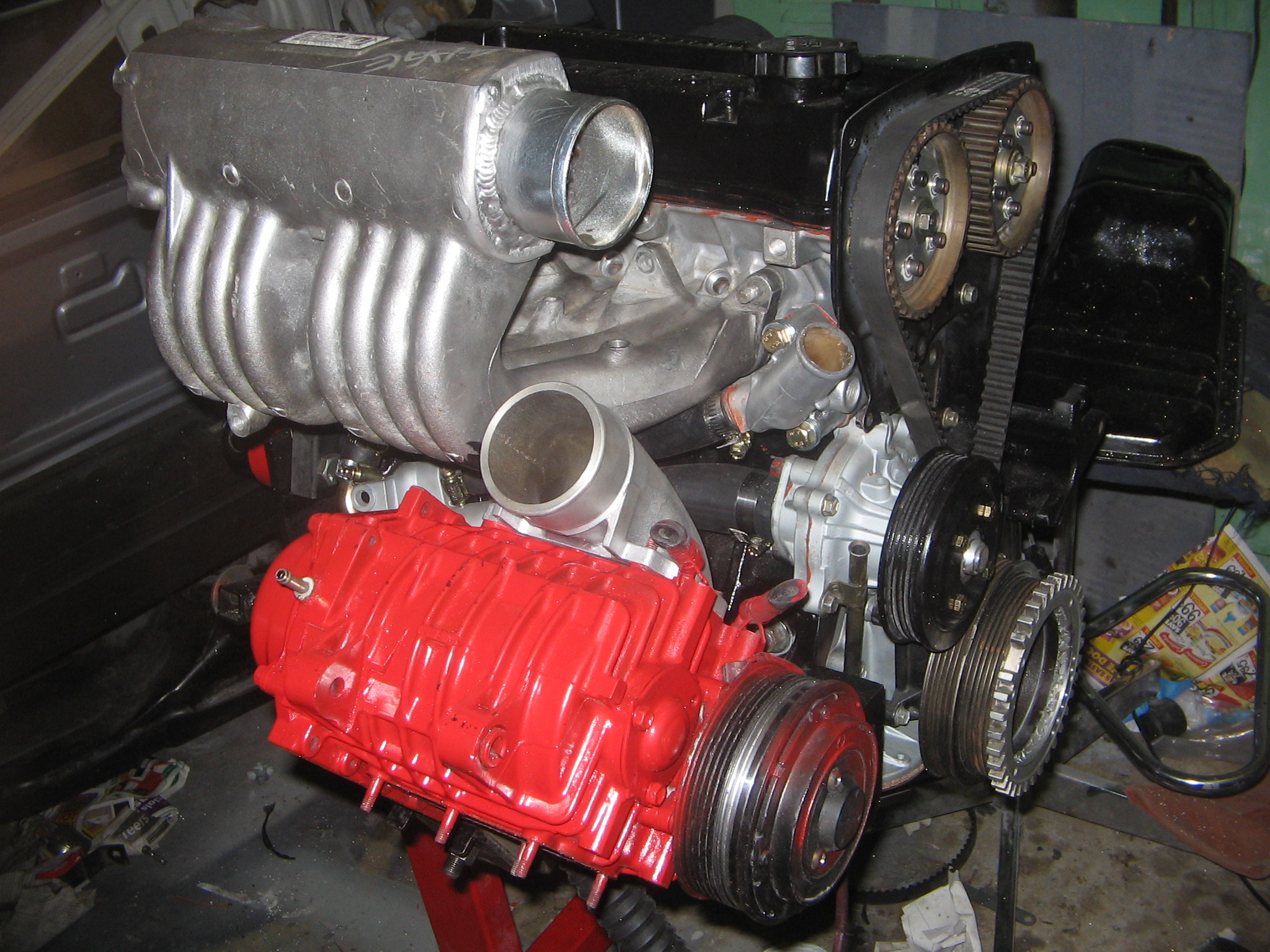

I've just updated my project page for Lola. For those of you that can't be bothered reading all of it, my current engine plan is as follows:
Bigport head
288-degree, 11.65mm lift cams
Metal head gasket (not sure on compression yet)
BIG valves
SC14 supercharger
160mm crank pulley
102mm supercharger pulley
Lightweight water pump and alternator pulleys
As for the inlet manifold, I'm still leaning towards quad throttle bodies. I could get a RWD inlet manifold and fit it much cheaper, but I don't like the long intake runners, and I'm concerned about air flow. There are also clearance issues, as can be seen on Jason's AE71 that he is building with 4A-GZE with SC14:
I'm thinking it might be best to make our own manifold to fit the quad throttles to the bigport head. This way we can angle the throttles upwards to easily clear the supercharger and it's piping.
I would like to go for 300hp with an SC12, but I think it'd be spinning the smaller supercharger too hard. SC14 has more volume, so it's take a bit more grunt to keep it turning, but I think the extra power produced will be worth it. :wink:
Good point, I have read if the supercharged is driven to hard and doesnt flow enough air it infact acts on a drag on the engine, not providing enough flow. I have seen a few people building 20V gze's, SC12 doesnt flow enough and causing a drag on the engine.
SC14 ftw Adam.
