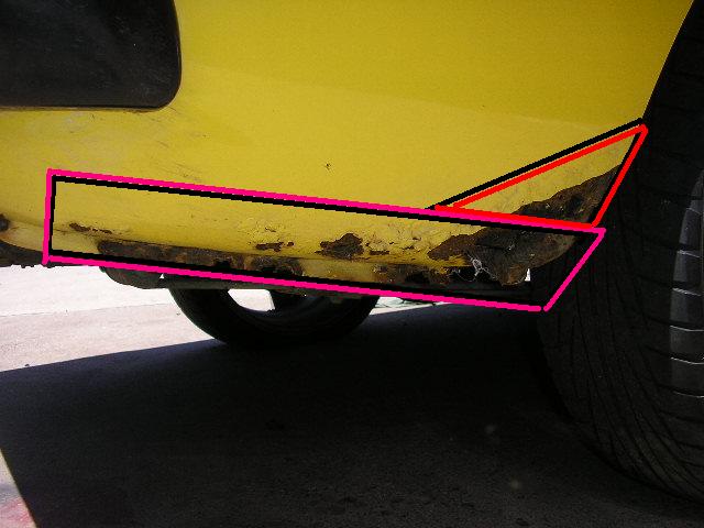

worst of the rust is here
the drivers side sill is not as bad as this, but runs along the same sort of area. also, any idea on what sort of sheet metal to use?
I'd hate to tell you but that is a little more than just surface rust. You should let somebody more skilled tackle that section as it definately isn't for the faint hearted.

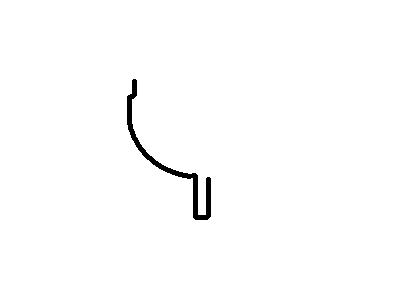

Easy just fabricate 2 new patchs or cut out of another car the shape shown in Picture. simply cut out as marked and weld patchs in place. seal the rear with hydro seal and its as good as new.

never said it was just surface rust? i said the minor parts are, thats all.
thanks KE30, thats what i thought had to be done. my friend helping me is pretty skilled with metal, i think he's a boilermaker, and i may be able to bribe someone else into assisting :)

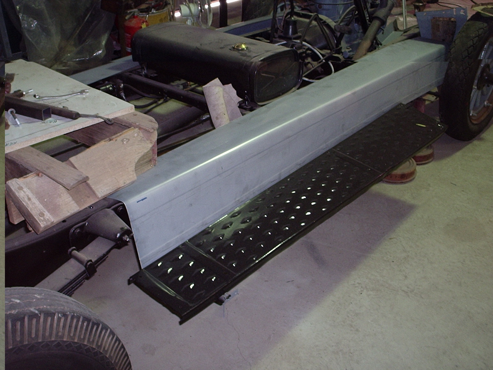

Here is a pic of a running board I repaired a few years ago, the diamond pattern was worn thru rusted out so i replace a whole section, I am Not a panel Beater or welder. practice makes perfect. give it a go.
get your self a off cut piece of new 0.8 mm flat steel sheet and have a practice first on a old panel.

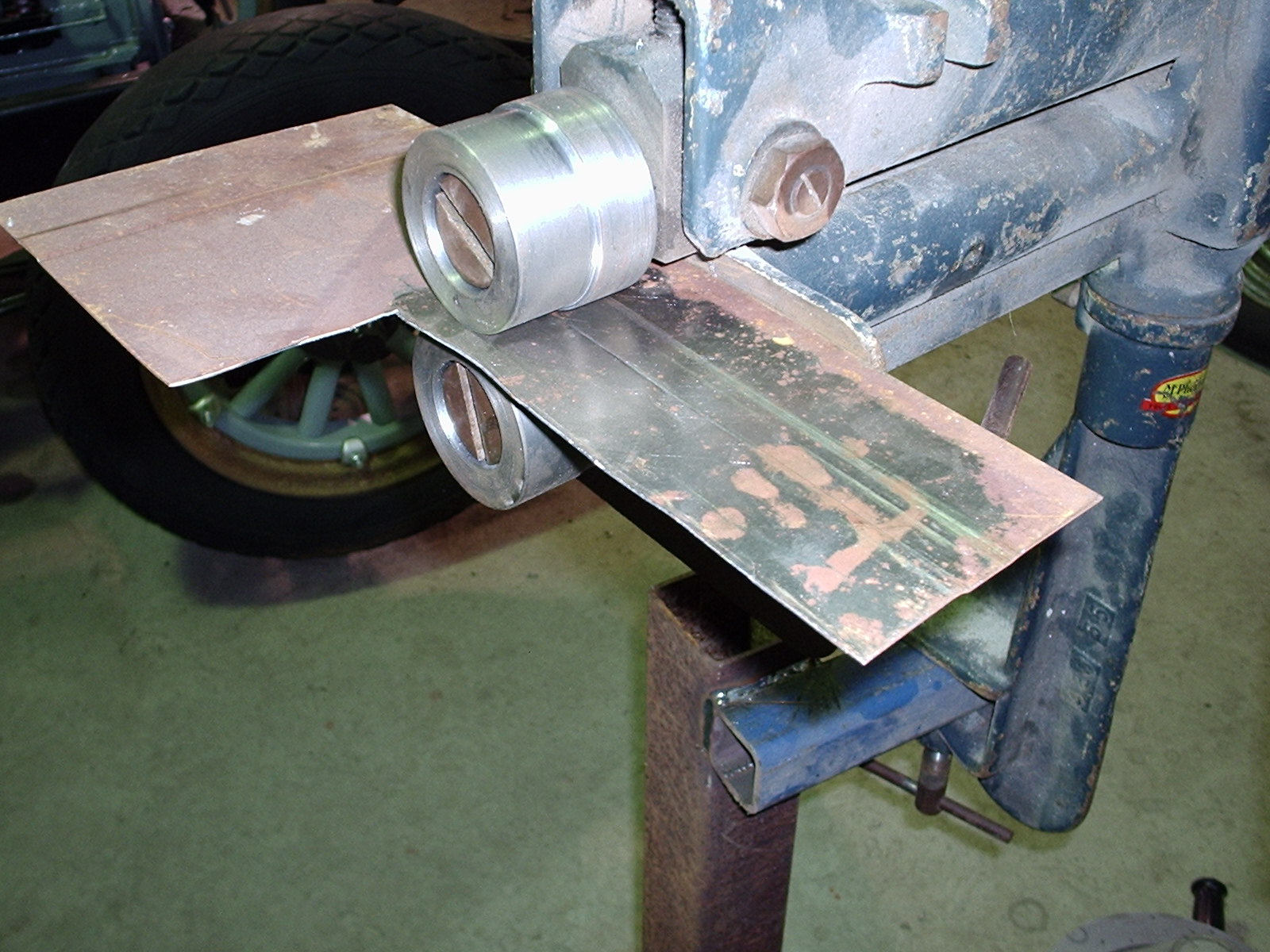

I have a big old 3 Phase MIG with a choke fitted it gives a lot more control than modern machines. The hard part is making the patch anyone can weld and grind ect. I use a combination of sheet metal tools like a jenny wheel pictured to recess patches so they fit behind but flush at the front. spot weld and check 10 times before the final weld.

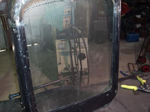

Butt welding is harder I used a replacement panel to repair my radiator surround pictured.

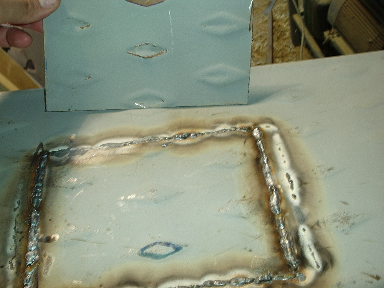

So the patch is larger than the hole, and you use the recessing so the recessed area is close in shape to the hole, you tack the patch in then run a seam weld in the gap between the recessed area on the patch and the edge of the hole?
Yes thats what I did with the running board,
With the rear quarter bottom pictured above i would use the recess on the top bend the 20mm around into the wheel arch curve the bottom then 2 sharp bends in a folder and overlap like a door skin. then at the bottom and weld at the back so it looks as the original panel.
