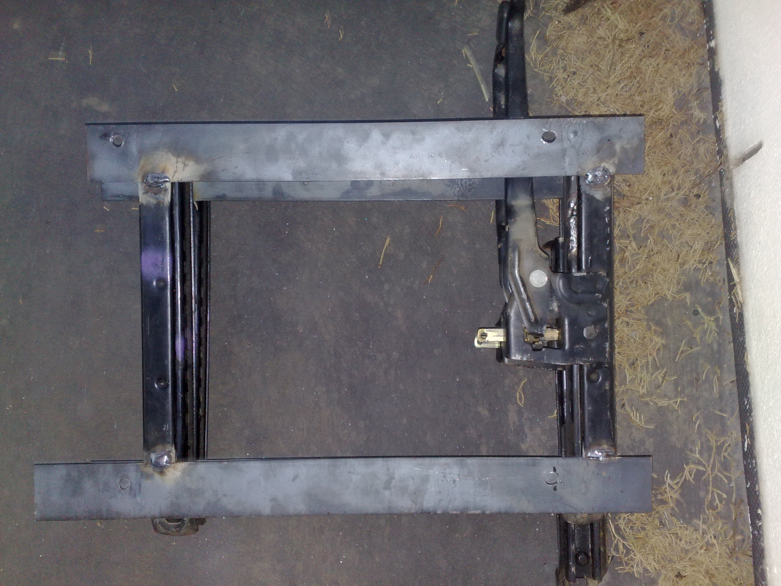

also started my seat rails!
just gotta weld em properly and paint em!

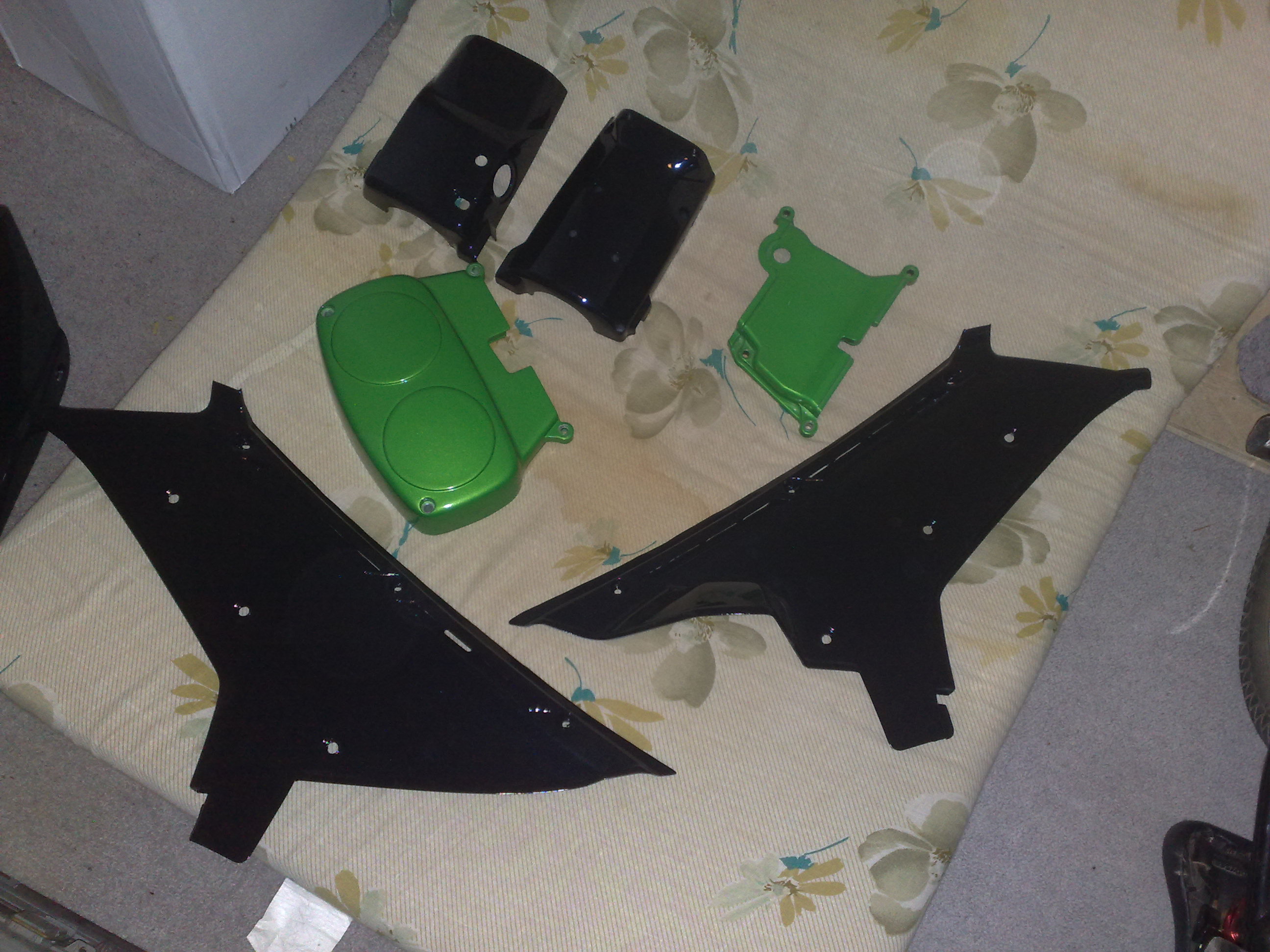

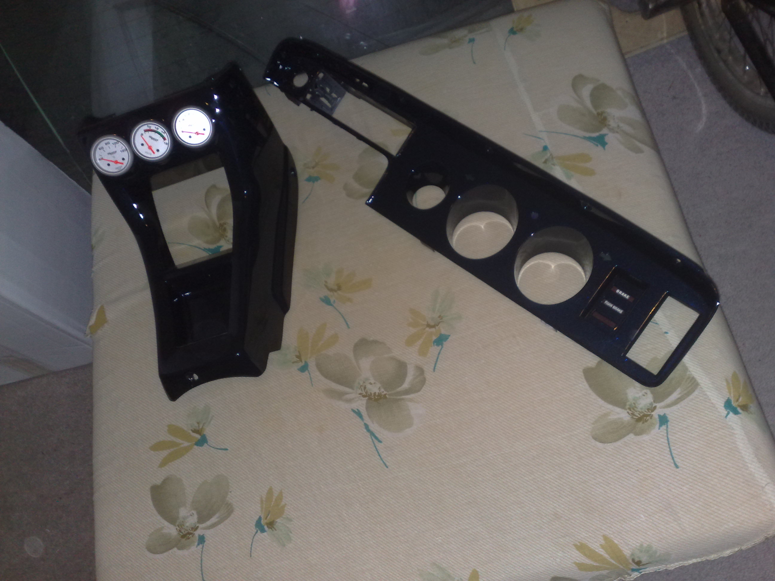

random photos of my collection of painted plastics!!

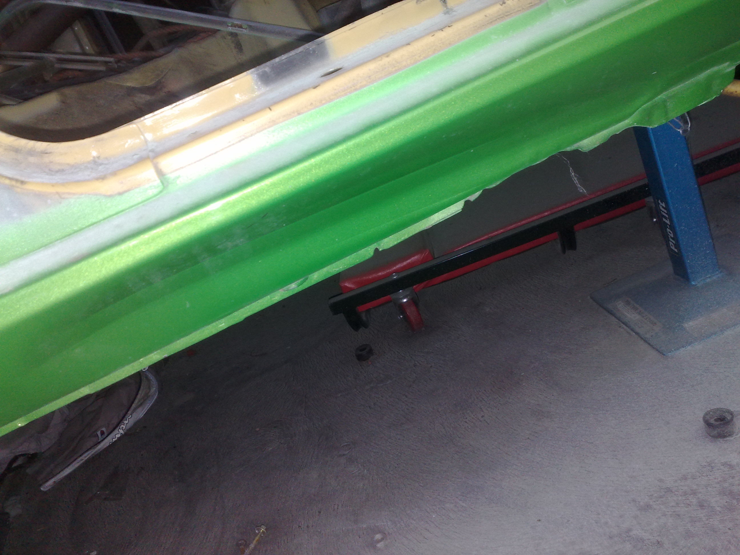

Got any ideas on how to get this out???????
can you not get a pair of pliers and just bend it back down (assuming its just the little strip has been squashed flat from jacking in the incorrect place?)
For the lip of the seam: multi grip pliers, hammer and dolly, and also a strip of steel clamped to the back to bash against to get it dead straight.
For the creases, weld small squares of thin plate with a hole drilled in them and pull out with a slide hammer with a hook attachment then cut and grind off. This is for those who can't afford those fancy stingers that weld rods to the panel.
The sheet metal will be under tension. That means that you will have high spots that cannot be flattened out and you will be playing whack a mole. Find the high spots using a file, direct a propane, butane, map, or oxy flame at the high point to you can see the grain structure of the metal expand (it turns blue), tap it with a wooden mallet or a waffled face shrinking hammer (if you can afford their ridiculous prices). This is to "shock" the sheet metal into contracting, your not "punching" it in so to speak. Then quickly quench it with a wet rag (i like to put ice in with the water that I dip the rag in).
wow thats good info thanks pieman.!
that whole section is dented in so really i wanna get it out as best i can then i can shape it with fibrglass
can someone draw a diagram?? not really making sense to me
thanks mate!!

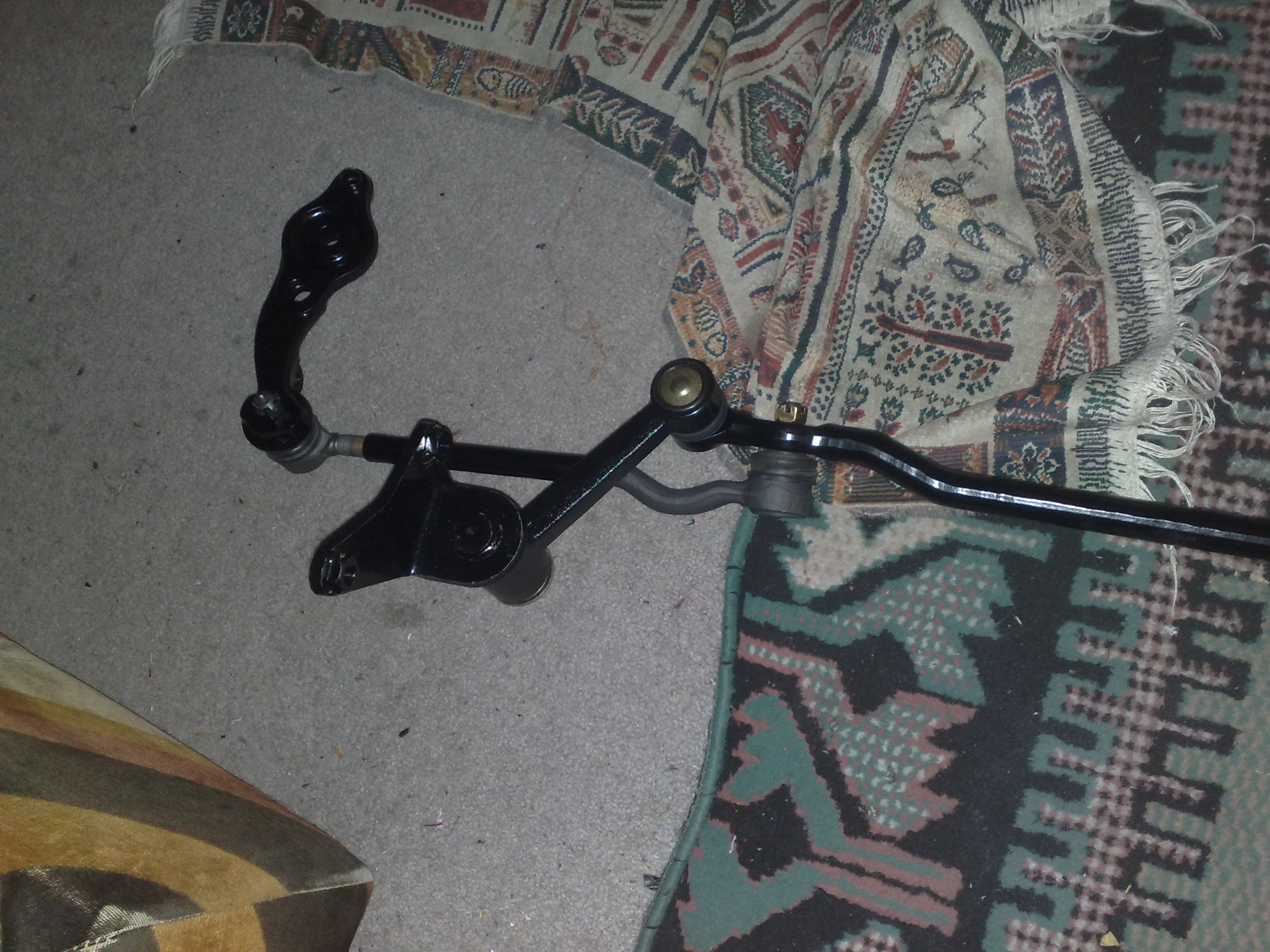

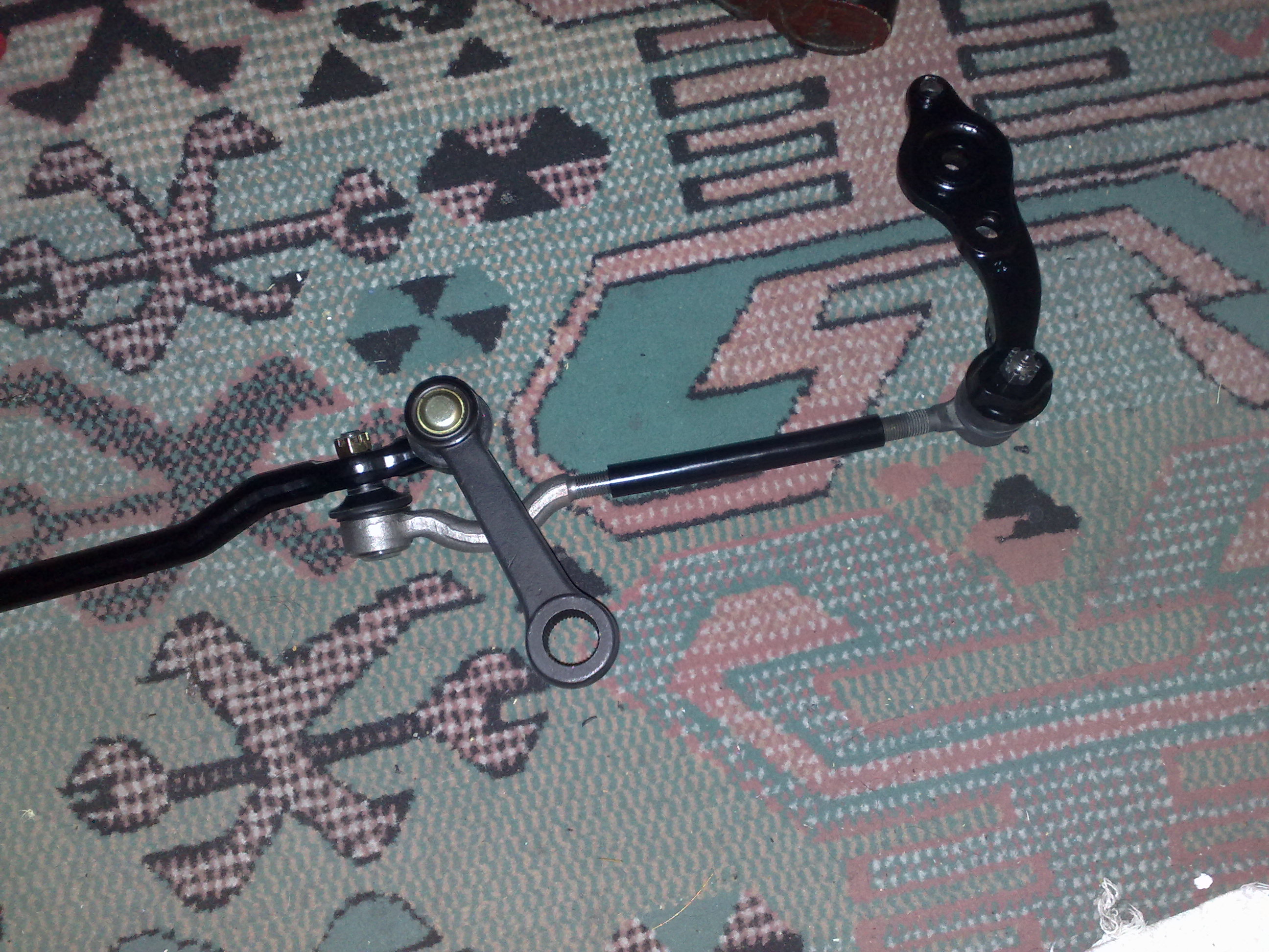

steering rack powdercoated and kinda together!
everything is brand new!! lovin it!!

He's not talking about the jack point. The sill has been dragged along something that has pushed it in, you can see a couple of scrapes there.
Whoops - didn't see them :D
