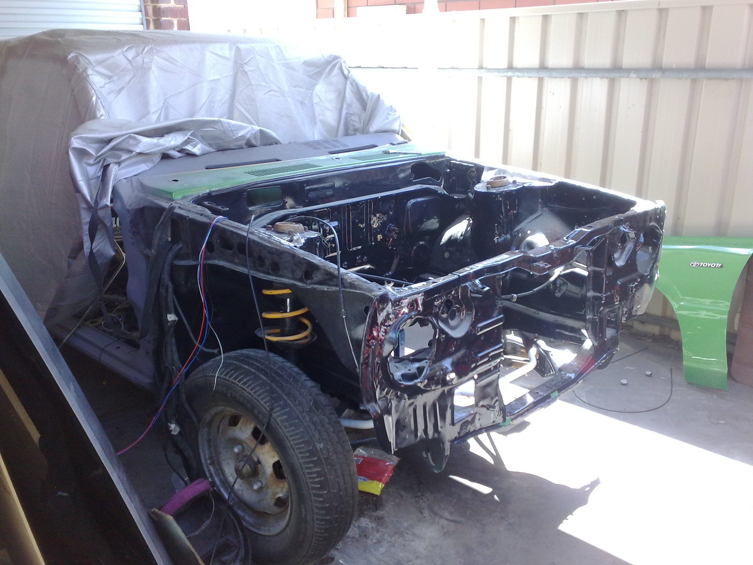

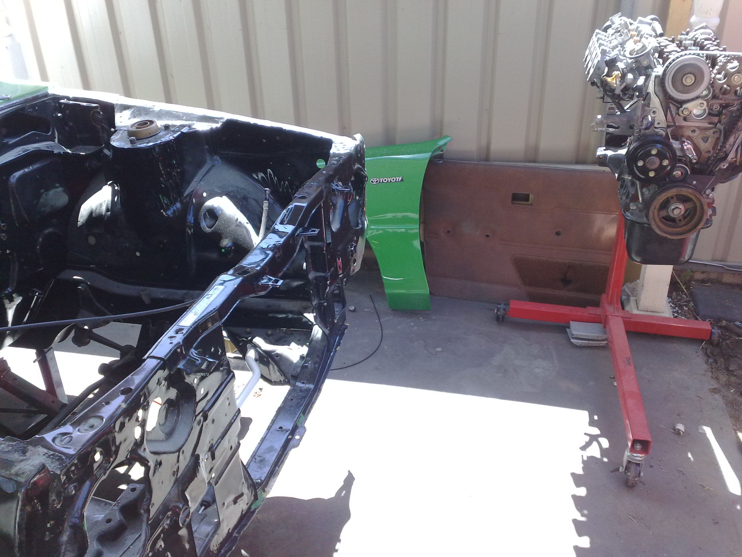

update!
motor cam back out! unbolted the gearbox
and pulled all the suspension gear out! and dismantled for powder coating!
everything is brandnew.
outer tie rods
inner tie rods
pitman arm
idler arm
bushes
and ball joints!!

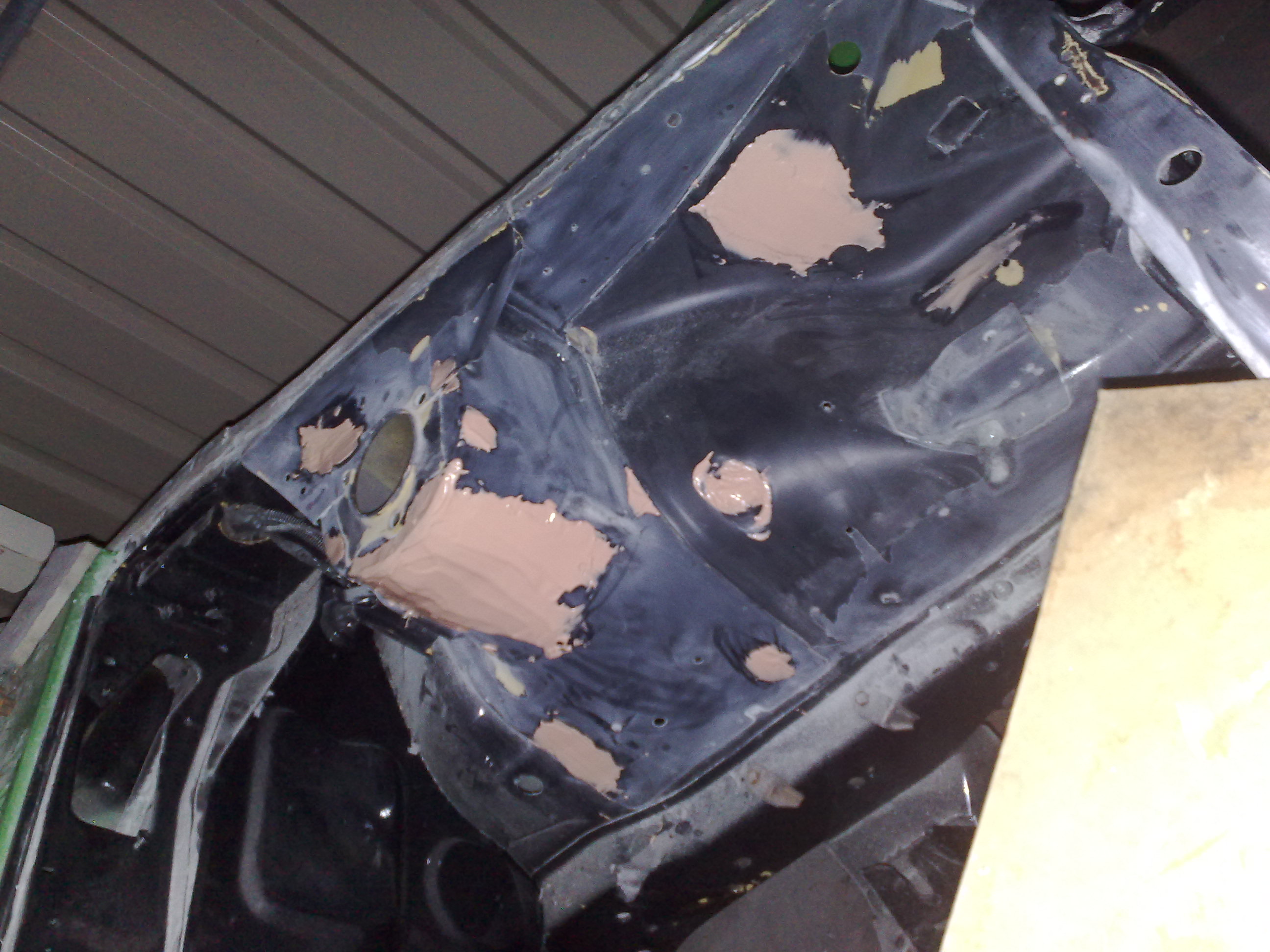

also started work on engine bay!
you can see the dammage my motor did while messing around with it!
and i've started boggin out all those ugly creases in the bay!!

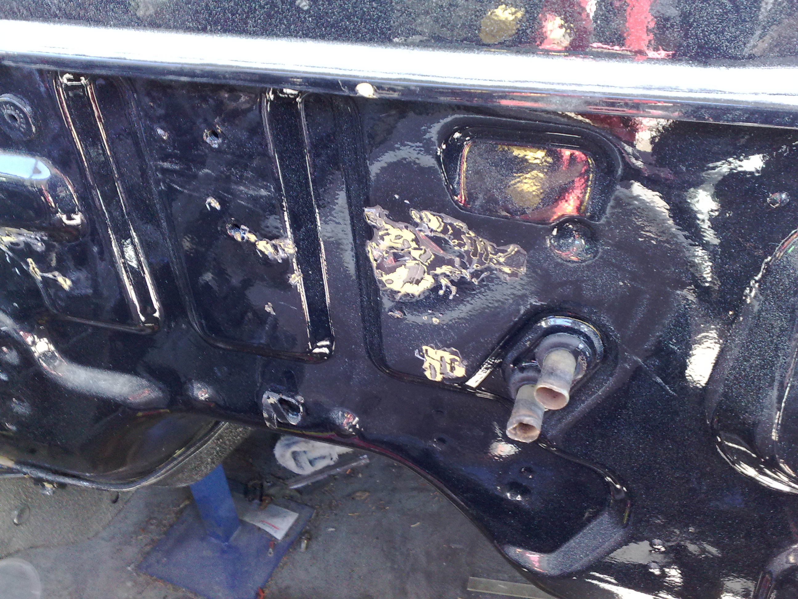

Looking good. what sort of paint are you using?
Du pont acrylic ss black
with protec 2k 2pack clear.
from the way the paint is chipping i reckon i didn't allow enough time between basecoat to clear.
the basecoat has stuck really well but the clear has f all adhesion!!
i reckon the solvents in the paint didn't evaporate properly!!
will be a lot more careful this time around!!

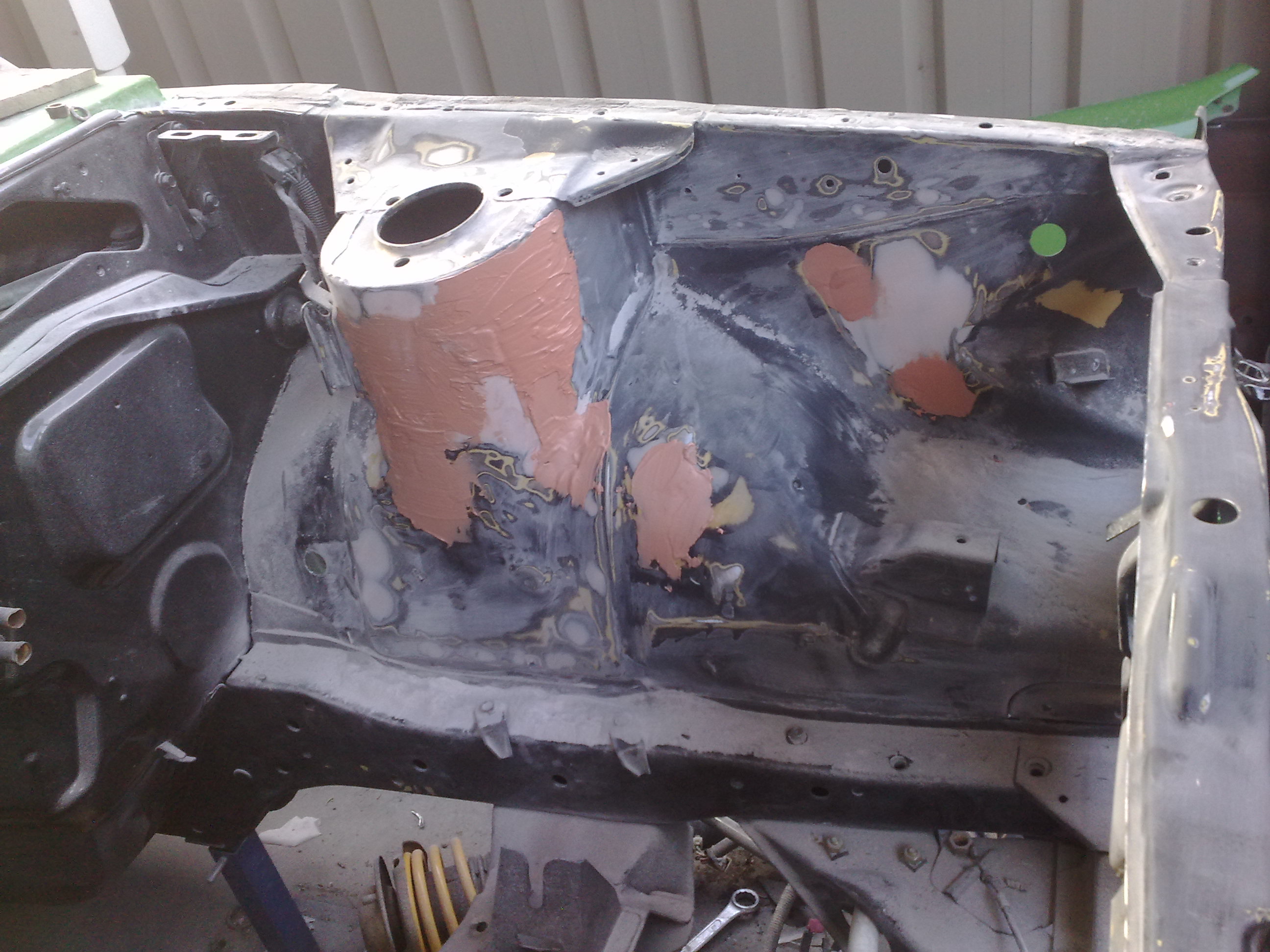

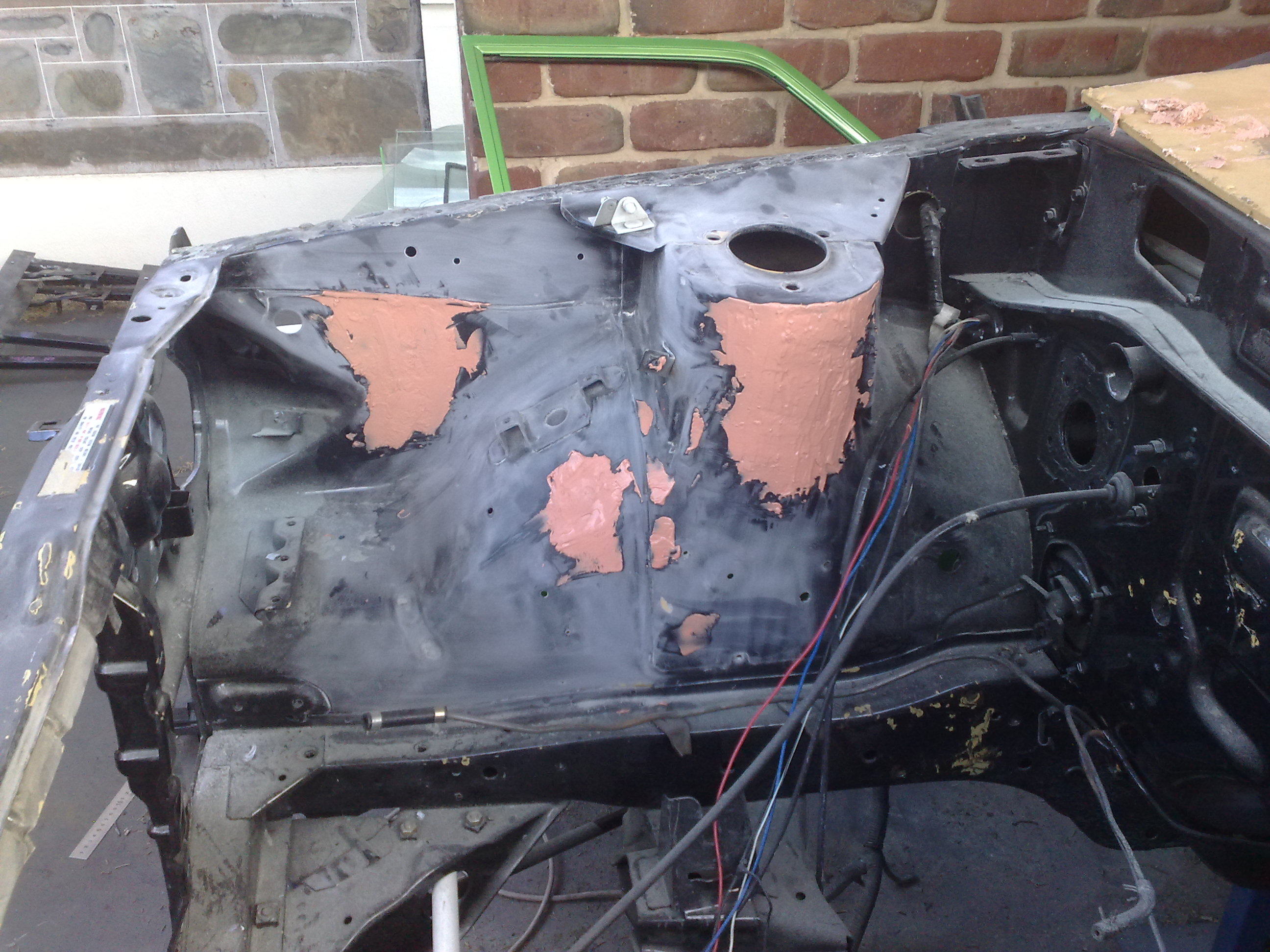

Update!!
more bay work!
not taking as long as i thought it would!
passenger pillar almost done!
drivers side to go!
