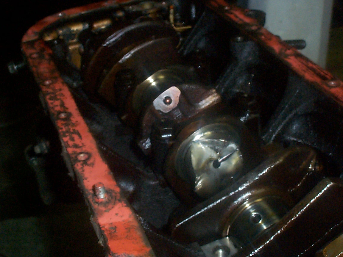

here's a couple of photos that show why Toyota went to a 42mm big end journal in the 100 kw engine.
this engine has only 160,000 km's on it and it wasn't driven hard?
came out of a blue MR2, i think you know who the owner is!!!

what power and what revs did it let go at?
he was driving home from work and it just started making noises, it's just a standard 86kw 4AGE 84 MR2 auto.
hasn't been played with at all!!! :lolcry:
rev's would have been under 4 grand, easy.
It doesnt look like its been oiled to well.
yeah i'd say no oil / low / shit oil
but omg that some serious dammage
Edited by ae174agze
if it had a oil problem it would have run a bearing not snaped the crank. the oil level was full, pressure was oil & it had not long ago had a oil change. i think the crank had fault in it. all the other bearings look overrated except for the middle main which supplys that big end bearing, it looked like it had run low on oil, but still wasn't bad.
