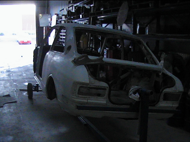

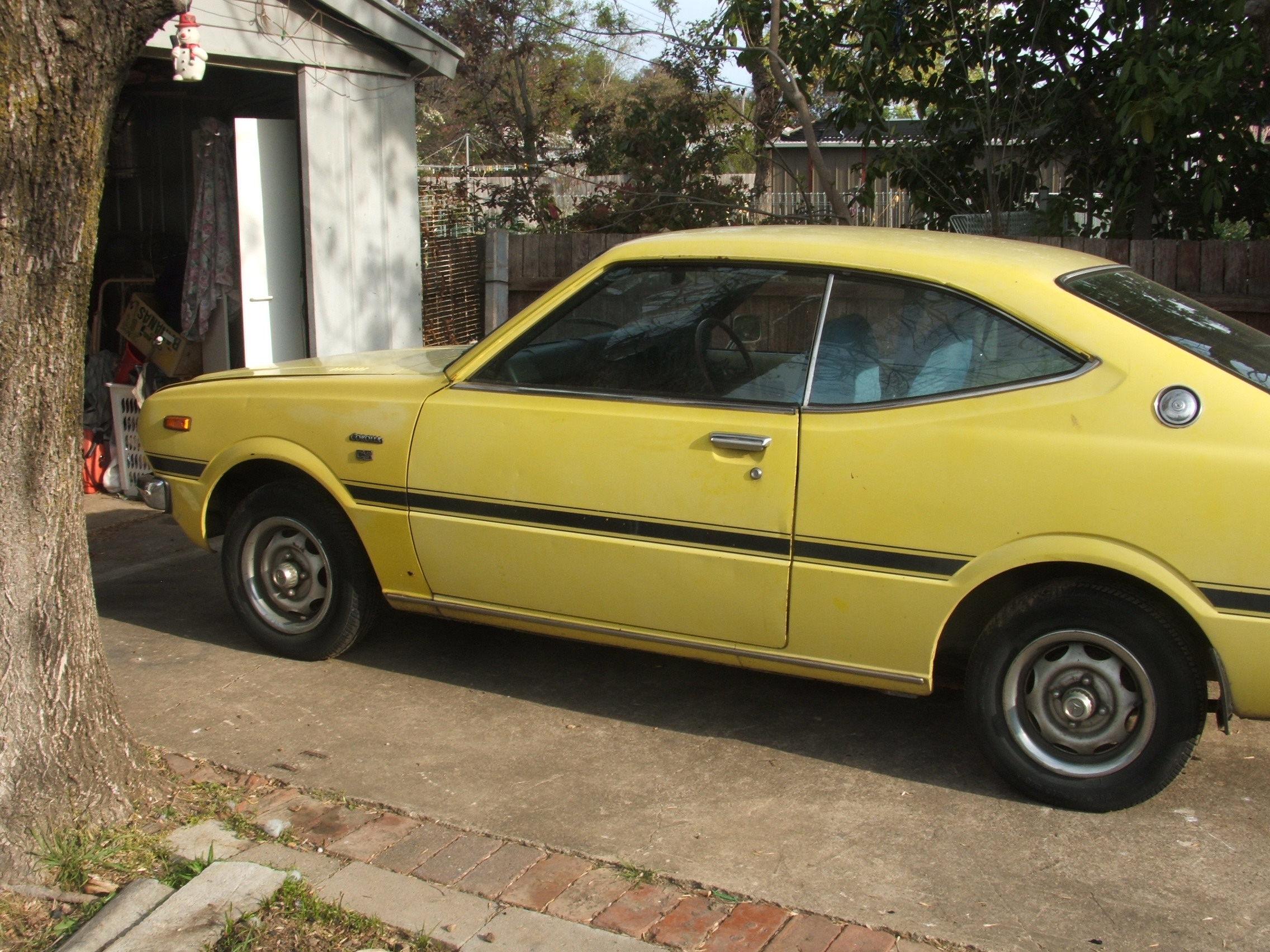

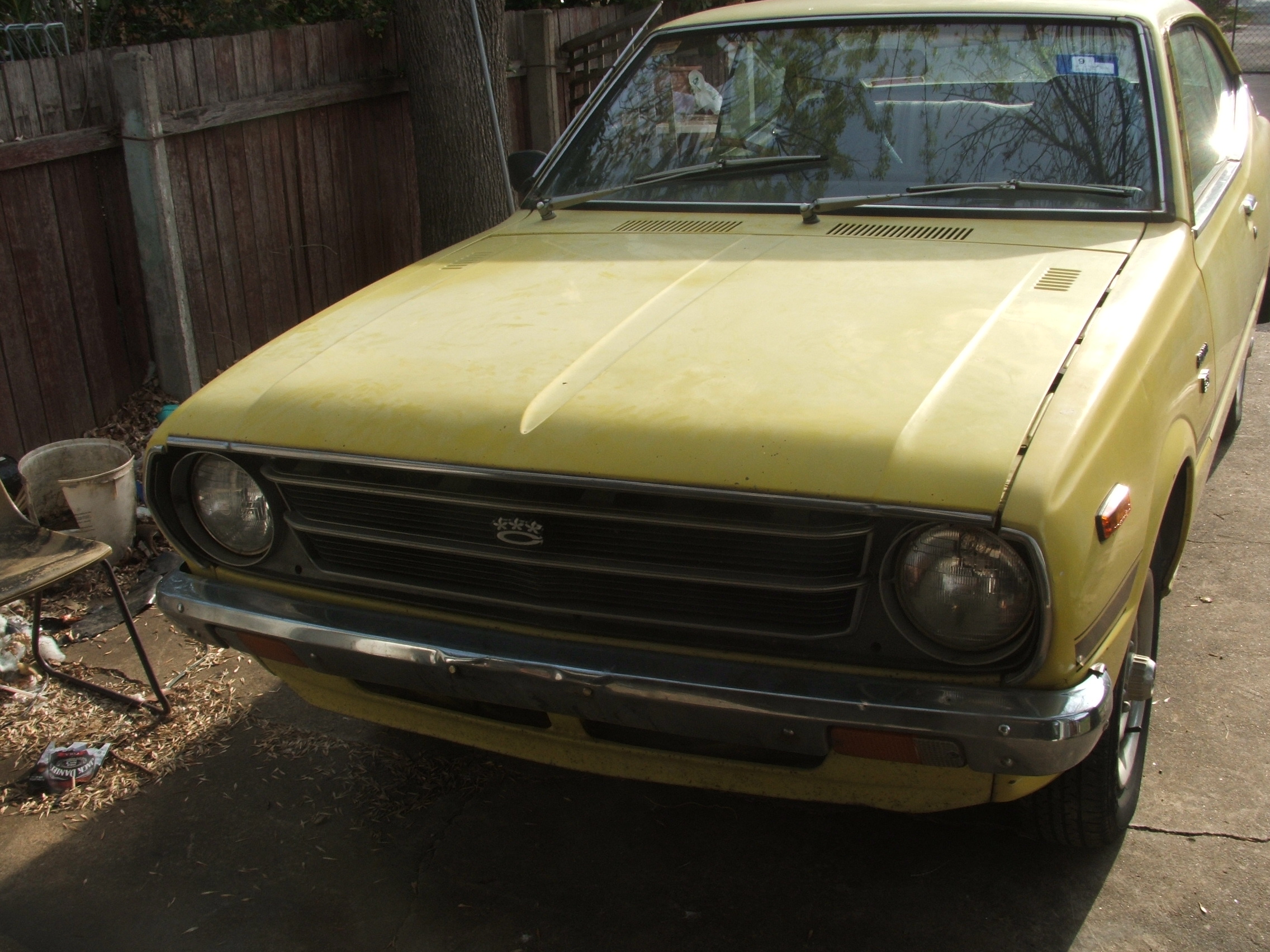

so I'm weighing up 2 options, the 20 (have 2), seam it, cage it, 2t, rules not exactly clear, any clue how a 30 wheel track/ stud paturn would fair? provided i use the right offset wheels its stock but compleatly not
option 2, 30 hard top coupe ( have 2 of them as well) same shopping list more or less, but WAY heavier, again i run 70 diff and x member in them, fwd rims keep the wheels in but the traction better, just don't like those fat rims sticking out there, stuffs the bearings and makes the steering twitchy (unlike mine that just lets go without warning :yes: )
this one, all set to start welding
