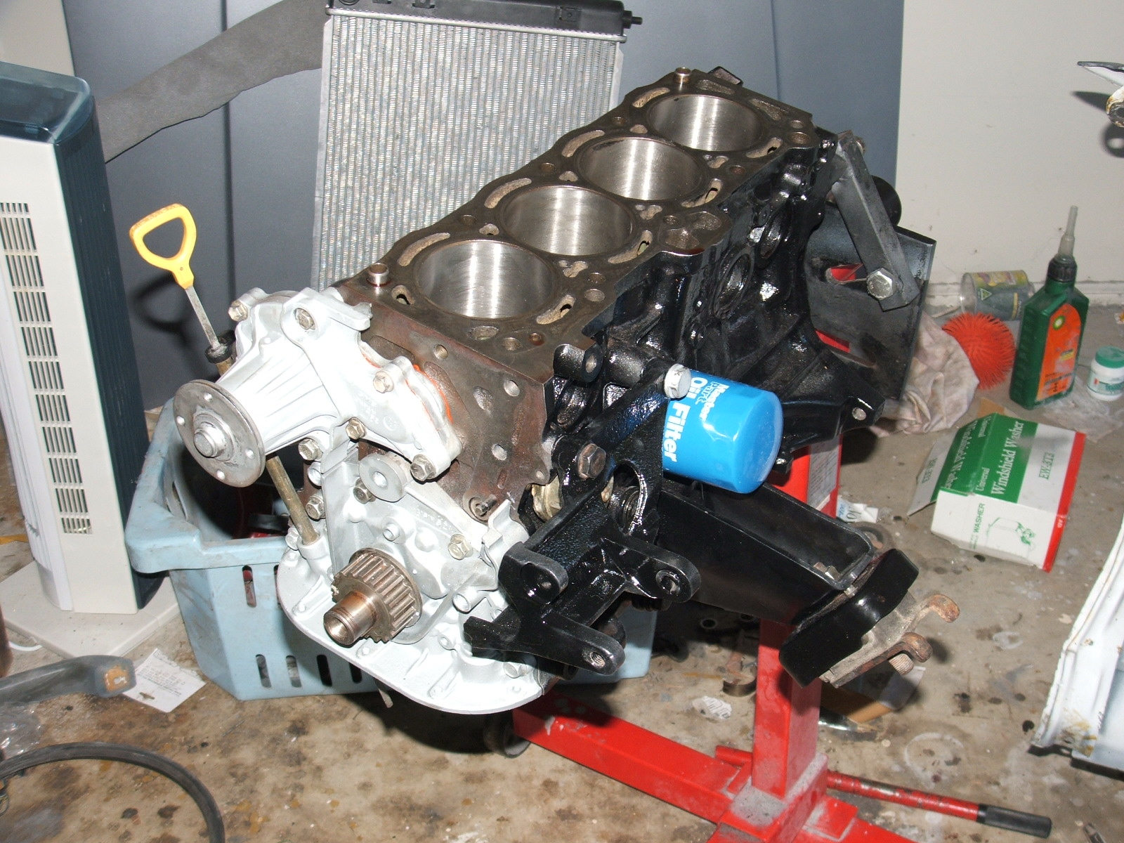

grr acl got the wrong piston rings :angry:

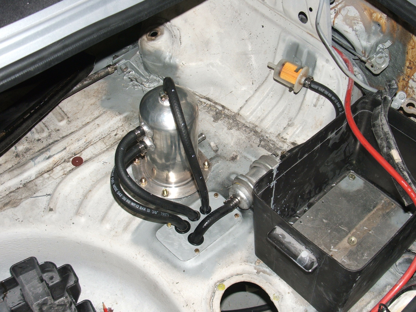

really like the way the sugre tank came out. But i still need to find a way to get the outlet of the surge tank (about 1/2 inch) to the inlet of the filter (3/8 or 1/4 inch)

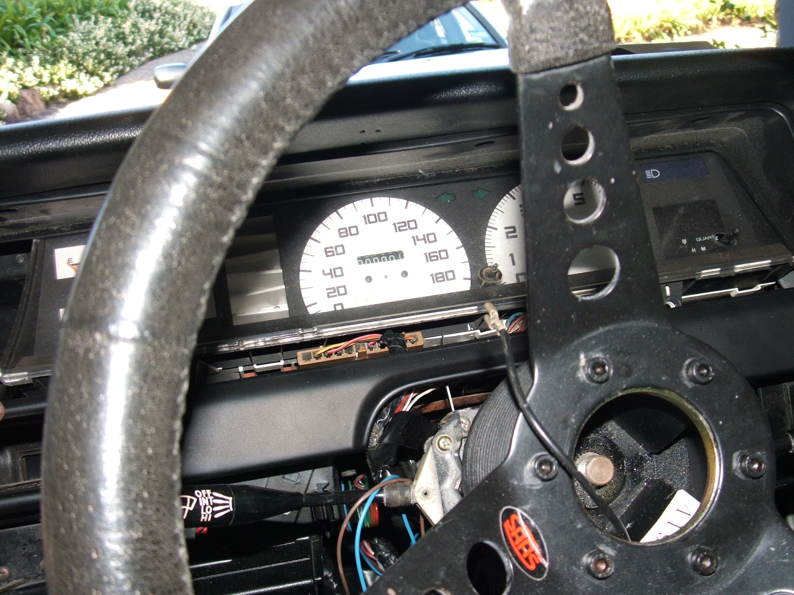

shot at the semi fitted dash :)

well its aculty the only place i can mount it, theres a sturt bar between the shok towers, the other side is too close to the wheel well and even if i mount it the chassis is in the way which i don't really want to be drilling through... o and nick you can get surge protectors for batteries (MOV's), which is still not the best thing but it reduces hot bettery sparks heaps

nice informative articles i loved the bit where you heated the pistons in the frying pan good to see some progress

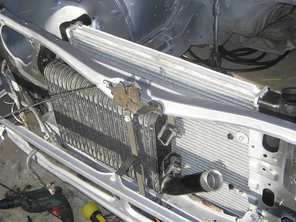

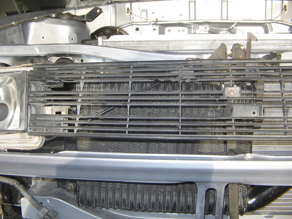

Got stright into by mounting the Radiator and IC, yes there is clearance between the bonnet... Just :)
IC fits so snugly behind the grill :lolcry: Had to make new brakets for the bonnet lack aswell IC fouled the old one
Ok hoildays so work can start again :lolcry:
Now i just got to insulate the IC from the steel braket :lolcry:

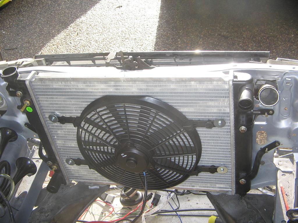

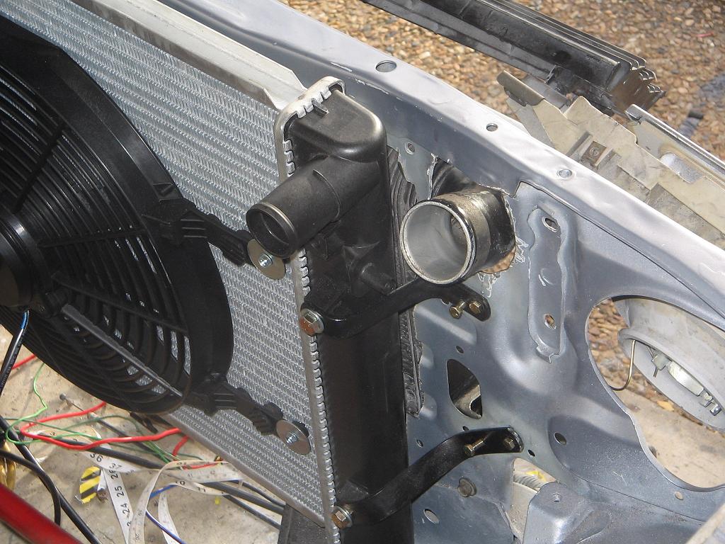

Apart from the Jason spec hole for the intercooler pipe on the radiator support panel, looking awesome :lolcry:
It looks like you're using the same setup as I planned to use - Commodore radiator with 16-inch eBay thermo fan (it looks like I've even got the same brand fan). But you're fan mounting looks a bit weird - have you just drilled into the radiator???
lol no, it you spread some fins and put bolts through with some big mica pads and rubbers :) I was going to mount it with some brakets but this was ALOT easier and tidyer
