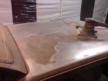

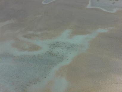

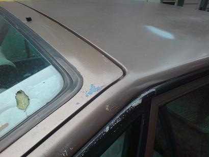

The paint on the roof and bonnet has oxidized and I was told I have to strip the old paint back to bare metal. Started sanding a little bit on the roof , and the whole roof has little spots of rust everywhere. Still have to do the bonnet. Urrh!
Wasn't planning a bare metal respray.

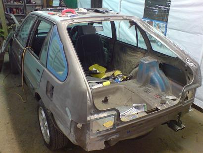

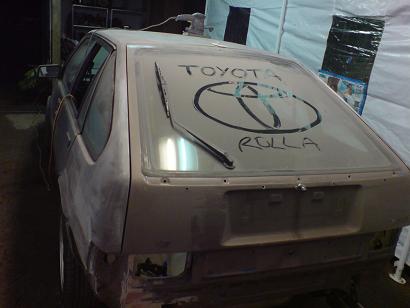

Boot is off now and I have almost finished prepping back end and roof, Yay!

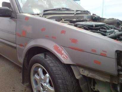

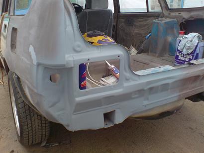

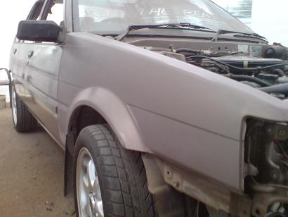

Finished the back corner, it had a big dent in the corner and was rusted badly.

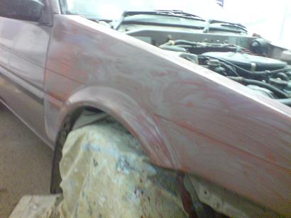

Sanded the front quater pannel and used quickstop putty, weird shit.. very messy.
The only way I could sand it was with 320p wetsand paper.
need to use more water!
water is to wash the crap off as your sanding.
doesn't look like your using enough to me!
gooe job though.

Thanks for the tip :y: , Never wet sanded before.. lol
I'm using 2 pac primer.
Any other tips, can you let me know. I'm sorta throwing myself in the deepend with this car.. :o

More work done..

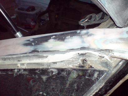

The right corner was badly flaking and bog was showing through must have had a bad accident because they have done a whole chop and weld on the back end, thats why you can see blue paint on previous pics.
Stripped it back, rust converted and bogged it.

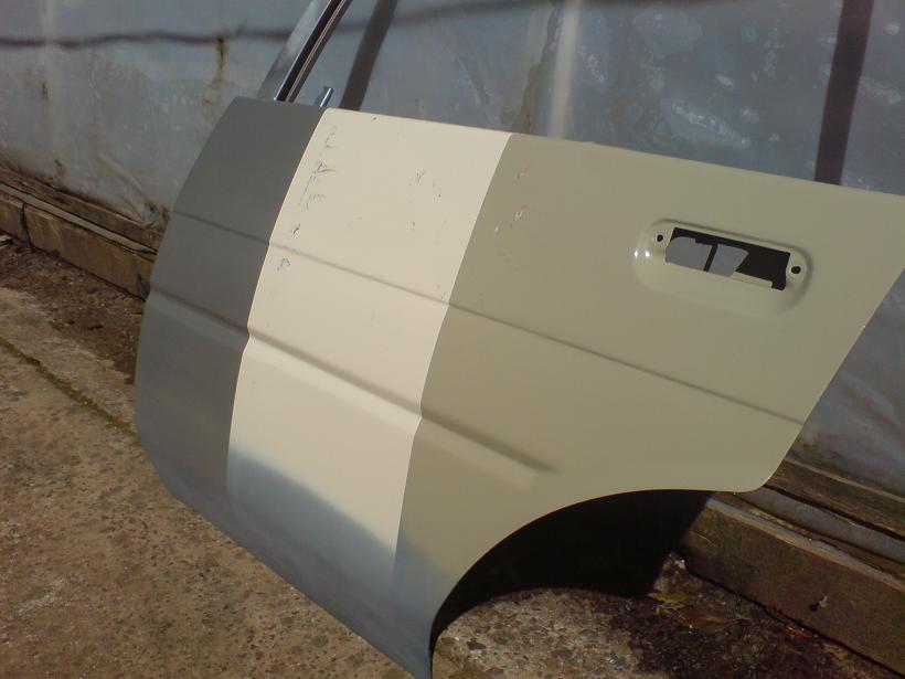

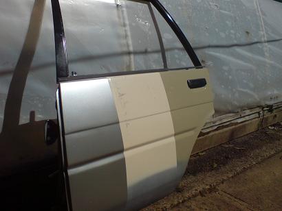

I went out this morning and bought 3 different colors to try out on the car. Left one is Platinum metallic pearl, middle one is Ivory from AE82 corolla and right one is Beige.
Which one should I choose? I was leaning more toward the beige, will look good with black trim and maybe a black bonnet but let me know your thoughts.
Cheers Johno :y:
beige gets my vote, goes it have a slight green tinge or is it just the photo?
Your not the only one who has said that, two others that have seen the door in the flesh also recon it has a green tinge. I might try and get another colour sample in the beige that is slightly lighter.
if you can't get the beige in the shade that you want, get the the Platinum metallic pearl. :y:
